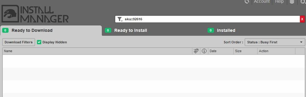

  • GoggerGogger Posts: 2,539
    edited December 2023
    Thanks everyone - I do appreciate efforts to help.  I normally figure stuff out on my own, but if there is an issue where nothing I do on my end will change anything - then patience is the order of the day.
    I use DIM and when I click from the DAZ Store website to [Install] via DIM my DIM window filter populates with the SKU ::92616 but nothing shows up in ANY of the tabs (Download/Install/Installed). I have other plugins installed without any issues at all, like AB Greebles Generator, Face Transfer, Foliage Maker, LAMH2Iray Catalyzer, Measure Metrics, Orbital Lights, and never a problem. There is no pop-up window, or error, I never get to a point for there to be a reason for any error- there's nothing to install! I haven't tried a manual install yet, but did download the file just fine, wanted to wait and see if anyone else is having an issue as well. I have a gazillion things going on on my computer, but will shut everything down and do a reboot - first step in troubleshooting - usually. I'm excited to use this plug-in as it addresses MANY of my frustrations!
    I have "Display Hidden" checked, and "Install Types : Plugins" is checked.
    I just rebooted both DAZ Studio and DIM and this is what I get clicking Install via DIM from the product page.
    And I did just install some stuff I bought yesterday, so DIM is working fine.

  • bluejauntebluejaunte Posts: 2,300
    Yeah I really think it's not on DIM, I'm not seeing it either.
  • barbultbarbult Posts: 27,672
    Daz has had problems with plugins in DIM for several months now. This is probably another example.

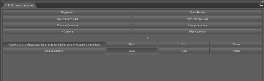

    @barbult - how's this? If you want a camera name that is TWICE as ridiculous just let me know and I'll throw it in there.
    Gogger said:
    barbult said:
    Some products have very long camera names - so long, that only part is visible in the camera drop down selector in Daz Studio. This makes it so that I cannot see the full name of the current camera, so I can't tell which one is selected. Does your plugin grid expand to show the full name of long camera names? If so, that would be a solution to this problem. I don't want to arbitrarily rename the cameras to camera 1,2,3, etc. I just want to see the full existing name of each camera and know which is currently in use.
    Pretty much yeah.
    Doubt any camera name is going to be this long but it acts pretty intelligently in that regard. Though I doubt you're gonna use it just for that once you get going with it :)
    Thanks, that looks like it will accommodate the camera names I had a problem with.
    (I should have done this before, but now I'm attaching a screenshot of the issue that I have with the default Daz interface. I reported it a year ago in a help request, but the issue that still persists today in 4.22.0.9 Public Build. The drop down shows the whole list of available cameras, but doesn't show enough letters of the currently selected camera name to determine which one it is.)
    [Note - this was after a manual install]

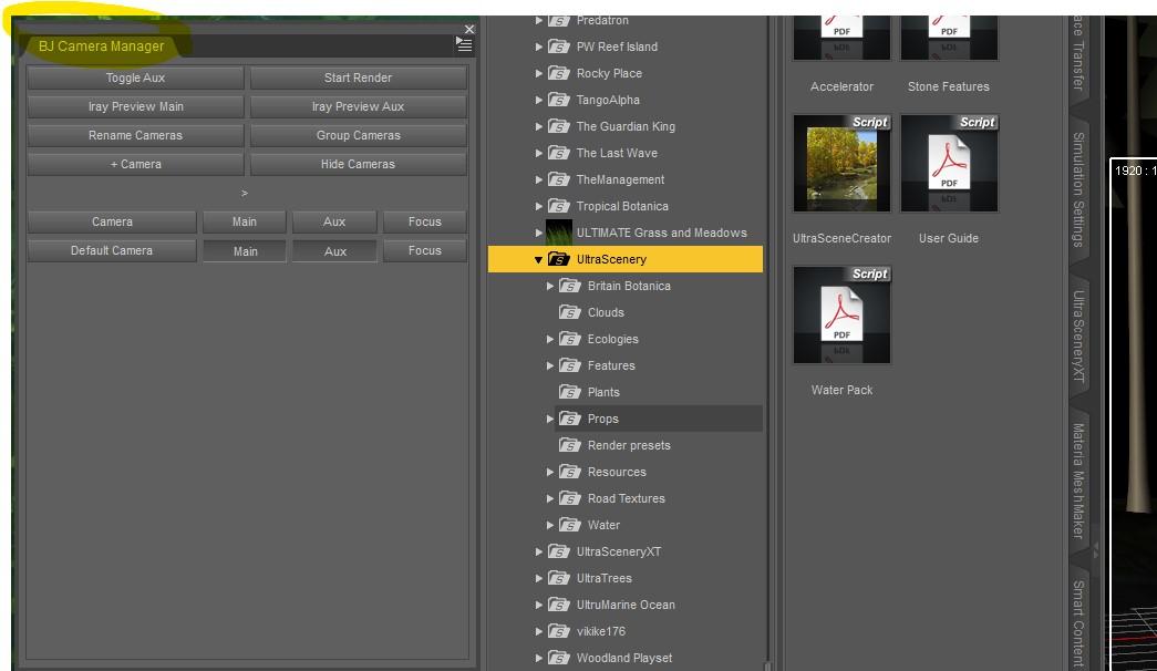

    Good test, Guinea Pig Gogger! Now, what happens if your Camera Manager pane is docked in a narrow vertical dock? Are there scroll bars? Does the plugin pane really need to be free floating to access all the parts conveniently?

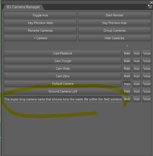

    Yeah, you can use the tool from a drop down on the menu bar, but it has a fixed width as near as I can figure. In the wide expanded version if you exceed the current window width, unfortunately there is no scroll or anything. I tried clicking inside the camera name field to see if I could go to the end of the long camera name - nope - at that point it is just the same as the DAZ Studio camera pane.
    Popping the tab pane out for external use:
    As a popped out pane:
    And from the menu bar:
    And how the name that does not fit unless you expand the window looks:
    So, like anything there are some limitations, but I know I will get some serious use out of this tool!

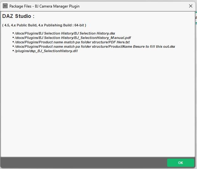

  • DIM doesn't seem to want to install it - won't show up.  Went to the Product Library page and tried to install from there.  This sku::92616 shows up in DIM, but no product shows.  I manually downloaded the file and will try that next.  Also, you know, might need to let it be in the store for AT LEAST a whole minute.  <LOL>
    I have the same problem.
  • ChuckMChuckM Posts: 171
    Same DIM problem. Manual install and it works Great.
    Thanks, bluejaunte
    Glad to hear ChuckM, thanks for the info. The DIM issue seems common with plugins, hopefully gets resolved on Monday or so when Daz people are back in office.
