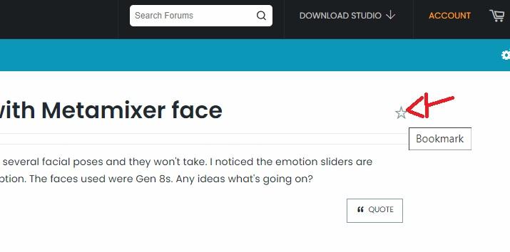

  • MelanieLMelanieL Posts: 7,872
    edited December 2023
    wildbillnash said:
    Yep, I checked and that's it. Thanks for the info.
    I hate to ask this, but how do you bookmark a page? I want to have an easier access to this page.
    Go to the top of the page and click on the star symbol.
    715 x 354 - 41K
    Post edited by MelanieL on

    That turns on reply notifications - to bookmark, ad a link that you can click on to get back to the page in future, you are looking for similar star in the browser address bar  or thereabouts

    I hadn't noticed that, but apparently. It certainly doesn't bookmark (add to favourits) the thread.

    Richard is instructing you  how to create a generic internet browser bookmark. Clicking the star to highlight it, as MelanieL described, creates a Daz Forum bookmark, accessible from the "My Bookmarks" selection on the gear, as you discovered.
  • Yeah, it does make sense. Except for the fact they had it the other way for years. I'll have to play with it now to see what I can do with it.
  • Okay, gang, I found where you bookmark a page. You find it under the "My Discussions" page. The star is to the far right for each discussion.
