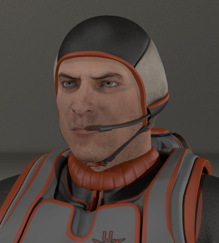

    Yes, over all it will work, but I'm just one of the unlucky persons for which it does not work completely (indeed problems with the mouth, similar to the one mentioned in this thread)
    http://direct.daz3d.com/forums/discussion/52819/genesis-and-use-limits-problem-in-poser
    The difference being that now it only affect G2F and G2M (all characters even without using the 'set limits' option in poser).
    So for me, the latest DSON version works without problems in PPro2014 (as long as I don't use 'set limits'), but not without problems in PPro11
    881 x 965 - 54K

    Yes, over all it will work, but I'm just one of the unlucky persons for which it does not work completely (indeed problems with the mouth, similar to the one mentioned in this thread) (...)
    I thought this problem is already solved and is known in this forum? However here is an easy way to fix it. I assume you have 'Genesis Generation X2'. At RuntimeDNA user 'willdial' offered this steps:
    QUOTE START
    It didn't occur in previous versions of Poser. After a couple of hours of research, I found the offending morphs. They were created by the Genesis Generation X2.
    Morphs
    Face -> Generation X -> Fix -> Upper Jaw Translate Z
    Face -> Generation X -> Fix -> Lower Jaw Translate Z
    Internal Names
    Upper Jaw Translate Z -> GXF_G2F_TransZUpJaw
    Lower Jaw Translate Z -> GXF_G2F_TransZLowJaw
    The two morphs have a Min value set to 100 and a Max value set to -100. Logically, they are backwards. Poser 11 cannot handle it.
    The Fix
    I edited the following files to set the Min to -100 and the Max to 100. Note: When editing DSF files, always make backups.
    Content\data\DAZ 3D\Genesis 2\Female\Morphs\D3D Gen X\GXF_G2F_TransZLowJaw.dsf
    Content\data\DAZ 3D\Genesis 2\Female\Morphs\D3D Gen X\GXF_G2F_TransZUpJaw.dsf
    That fixed the problem. I tested some the dependent morphs and they worked fine.
    QUOTE END
    I hope it's okay that I copied this from another board because it helps with a technical issue which I cannot put well in my own words because English is not my native language.
    The good thing is this fix works also with the G2M characters.
    So if you edit the files as recommended you can also fix characters that you have saved prior to Poser 11. Just dial at 'Face'->'Generation X'->'Fix' either at
    'Lower Jaw Translate Z' or 'Upper Jaw Translate Z' as described in the quote change under 'settings' 'min limit' at -100 and 'max limit' at 100. Then set the 'value' to 0.
