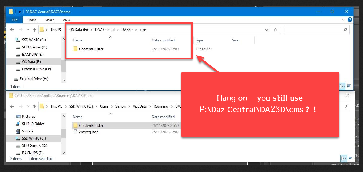

    Hang on, you‘’re still using DC's cluster folder ?
    er..no
     daz runs from c:\program files.
    :D
    ive installed and moved daz around so much i don't know where i'm at anymore. i think i can delete that daz central daz installation (probably it's an installation i had on another hdd, then i bought an sdd, installed windows 10 on it, and installed daz also on the ssd, leaving that daz central installation there. ops!)
    attached is the root folder i got.
    p.s - sorry, its been a while since i've messed around with the daz installations.
    edit: the fact remains, though, that moving the cms to anywhere results in missing category folder and the error attached
    p.p.s - im using Daz 4.21.0.5  Pro Edition..i dont know about it being General Release or Public Build.

  • crosswindcrosswind Posts: 10,356
    edited November 2023
    Anyway, pls try to uninstall DC first... I'm not sure of the culprit as I have no way to reproduce your issue and I had removed DC after I tried it less than 15 minutes two years ago...
    Then delete "F:\Daz Central\Daz3D\cms" folder to Windows Recycle Bin ! Create a brand new folder "F:\Daz 3D\cms",  then retry the steps I posted before.
