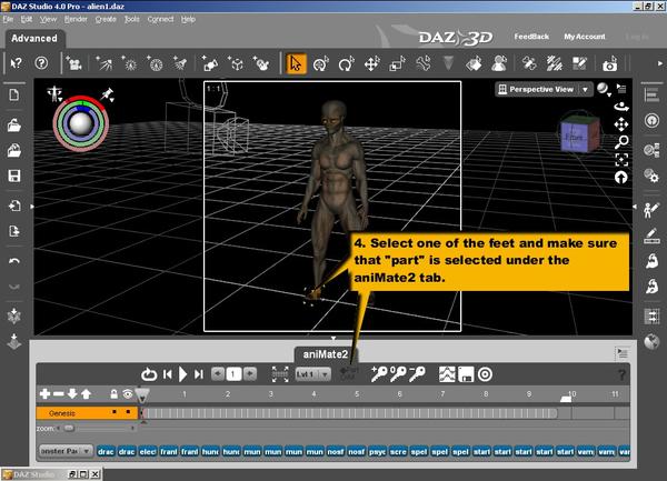

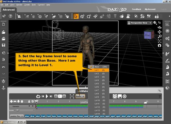

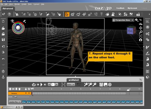

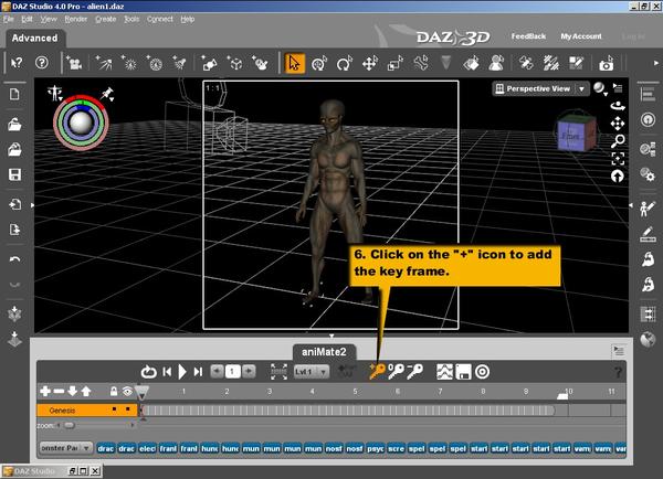

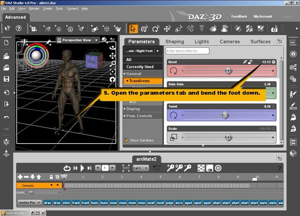

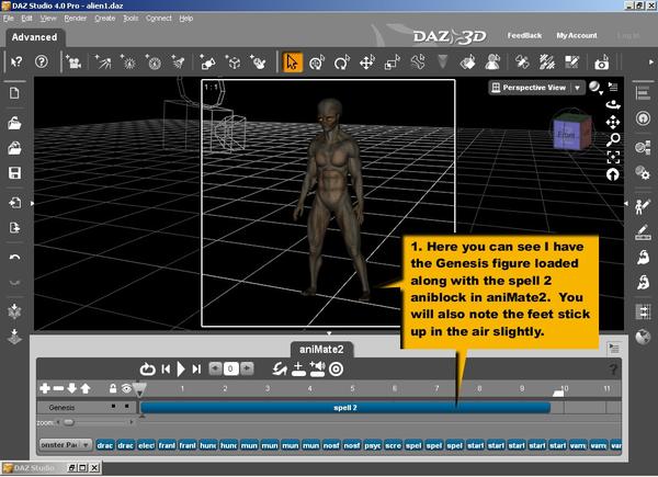

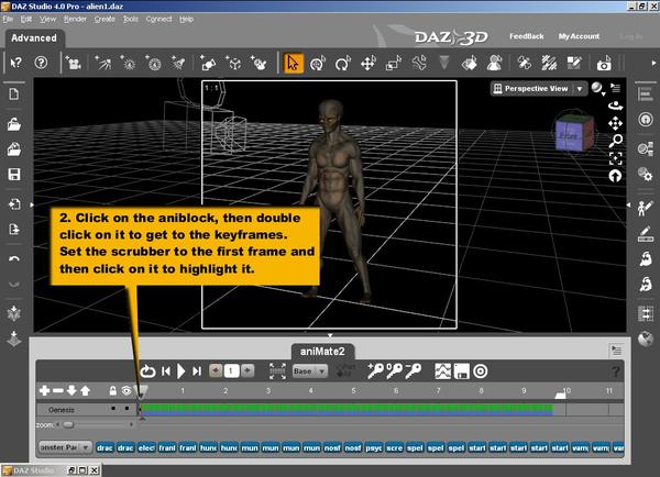

I have the foot issues also with version 4 and Animate2. I apply a corrective key frame to the very first frame of my animation in Animate2 and that usually takes care of the issue. I assume you are speaking about the front of the feet sticking up in the air. Let me know if this is correct and I will post a screenshot of how I correct it in Animate2.
Yez, this is the problem. I would be grateful for any help you could give.
Ok here is your mini tut on foot correction. I hope this works out as I have never posted multiple files on this new site yet.
Here are the remaining steps. Remember to click the images to enlarge them.
