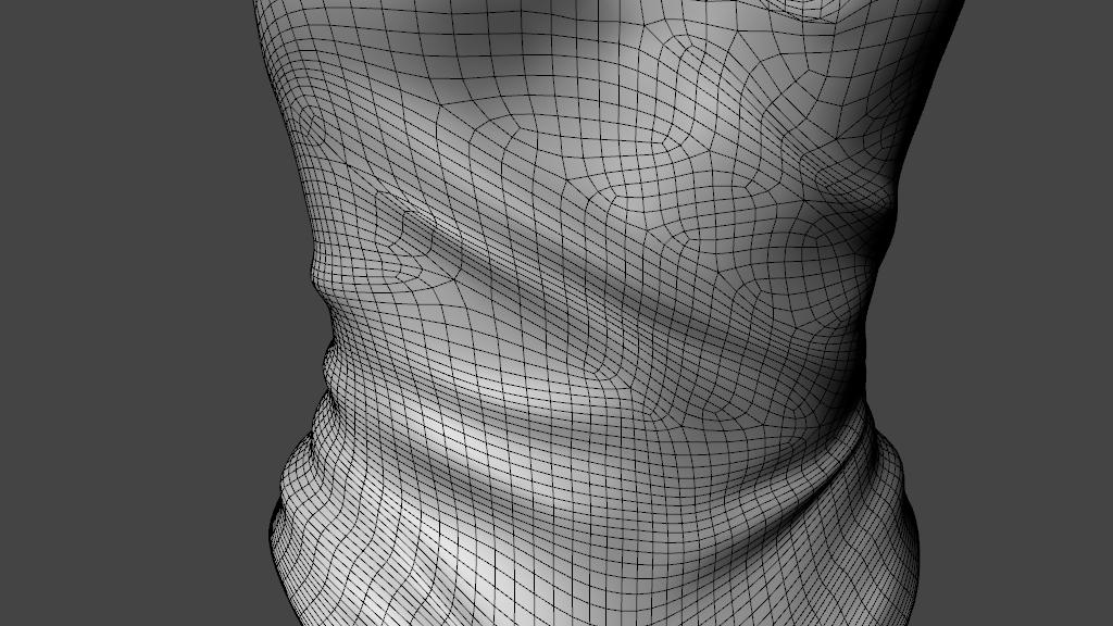

    I wonder how some vendors create the final mesh, if it follows the wrinkles.
    Do they create them highpoly and retopo it somehow?
    Here an example
    1024 x 576 - 342K
