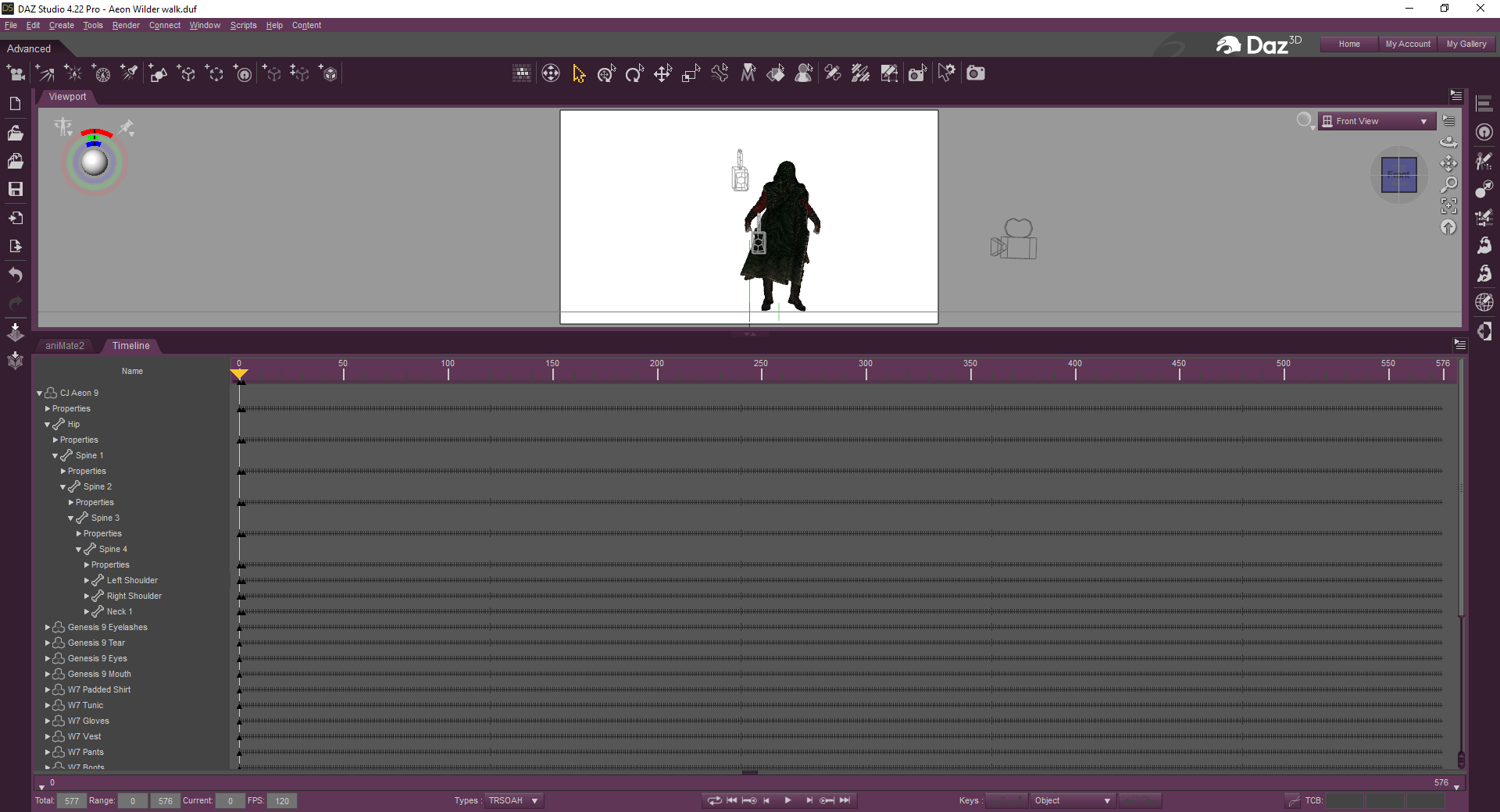

    OK I have a truly odd thing happening
    I hid a lot of bones under a conforming autofitted outfit
    now opening the saved scene I cannot find those body parts in the timeline to edit keyframes
    Pelvis and below is just missing
    I deleted all the other keyframes
    the legs are running length of the timeline but bones missing
    were all hidden under conformed clothing

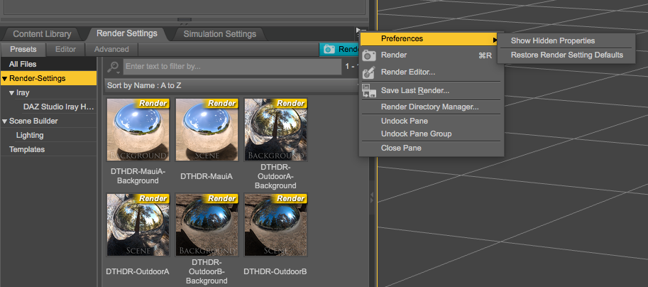

    Clean install of 4.22 on the Mac.
    Can no longer save Render Setting Presets from (or to) the Render Settings pane.
    I CAN save them using the menu:  File > Save As > Render Settings Preset
    .. but doing so only adds them to the Content Library and they do NOT show up the Render Settings Preset Pane.
    I've tried saving them to both: /Library/Render Settings, and /Library/Render Presets

  • I don't recall ever being able to save in a presets tab (or Smart Content) - that isn't their purpose, theya re browsers for existing files. You may need to right-click on the container and select Refresh to see the newly saved files.
    ctrl-n will open the New Scene dialogue, which will already be on the Recent files tab if that was the last one used - just double-click the desired file to load it. That sounds about the same as the old system, with a double instead of a single click at the end. You might be interested in this new sample script, too http://docs.daz3d.com/doku.php/public/software/dazstudio/4/referenceguide/scripting/api_reference/samples/actions/action_menu_submenu/start
  • ThorThor Posts: 43
    Perhaps I'm misremembering how I saved them there.. but they certainly displayed in the pane properly since at least 4.9 or before. I don't use Smart Content at all, and don't connect to the cms. No amount of refreshing is showing any of my saved render settings files in the settings pane regardless of where I save them. I even tried saving them to the exact same location as the built-in "Advanced Render Settings" and "Sun Dial Set". (See attached)
    It seems as though that pane has simply stopped recognizing ANY Render Settings Preset files that I save to the content library.
    Why is this pane handling files differently? Why can't I create folders/subfolders to organize my settings files like I can everywhere else in the content library?
    If you were not connected to the CMS you would not have anything in the Presets tabs, since those are populated from the database not from simply reading the fiels in a folder (only Daz Studio Formats, Poser Formats, and Other import Formats work without the CMS). What, if any, content type tag do the presets have at top-right?
    As seen in my 2nd attached screenshot, my new saved render setting preset does not have a content type tag (on the icon - if that's what you're referring to) when viewed in the content library. Since I saved them using File > Save as > Render Settings preset... it IS a Daz Studio format file. As I said, I've NEVER used the CMS, and my presets have always appeared in the tab, and I believe that they USED to have the icon tag when saving to the filesystem/library.
    Then it seems that there is an issue with updating the CMS (which you are "using," regardless of whether you directly use any of the features for manual categorisation etc.). Without the metadata the files will not appear in the presets tab. Does newly installed content still get its metadata added (categories, content type etc.)?
    I wasn't questioning whether it was a Daz Studio format file - I was pointing out that the first three containeers in th Content Library (Daz Studio Formats, Poser Formats, Other Import Formats) are (with the exception of the Daz Connect "folder") giving you a view of files as they are on disc. All the other containers, and all the other content views, are driven from the CMS and will be empty without it (and, as here, will not show content that lacks the proper entries in the CMS).
    I'm making progress on troubleshooting/resolving this issue... Apparently, this will intermittently occur when using the Content Directory Manager to switch between Content Sets/Libraries.
    I'm finding that the Content Directory Manager does NOT work as intended, which seems to be causing the problem (and other problems)... but I think I should be able to create a workaround for this.
    In what way is it failing to work as intended?
    Perhaps I should have said "as expected".
    In the past, after an install/upgrade, I've always just re-mapped to my previous library without creating a separate Content Set and never seemed to have any problems.
    For this upgrade, I wanted to do a clean install, and retain one Content Set for the default clean installation, and one for my previous library*. Sounds simple.
    Clean install of Daz Studio
    "Daz Studio Formats" using mapped defaults:
    /Users/Shared/My DAZ 3D Library/
    Previous Daz Studio Content Library (on 2nd drive):
    /HD/DAZ 3D/Studio/My Library/
    Using Content Directory Manager: Create New Content Set*, Add Directory to "Daz Studio Formats" mapping to previous Library
    *IMPORTANT: This actually requires creating TWO new content sets in Content Directory Manager - This was/is not obvious and a little confusing until I figured out that the built-in "Current Directories" > "Content Set" is NOT actually a Content Set at all. It would be nice if a clean DS install actually had the default Content Set created and mapped, so the user could just add additional sets, or edit the existing one. Adding to the confusion, when accessing Content Directory Manager after selecting a created Content Set, the currently active set is NOT selected in the UI - instead, "Current Directories" is selected showing the chosen Set's mapping. The "Current Directories" item should not be selectable in the UI at all and should not be listed or editable as a "Content Set". The currently active set should be selected, and "Current Directories" should simply be informational reflecting the chosen, active set.
    Switching between libraries (Content Sets) in content directory manager results in broken icons/paths for content not explicitly saved into the "current" active library/Content Set. I understand why this is the case (broken filepaths).. but I assumed that the content libraries/sets would be self-contained, and simply NOT display items outside of their mapped directories. After all, if I can't load content from an inactive Content Set or unmapped directory, why am I seeing them in the active set at all?
    When switched to my old library, I assumed my old Render Settings Presets would appear in Render Settings Pane because the .duf files are in the proper folders on disk.
    Reality: They don't.
    NOTE: They ARE loadable from old render library > Render Presets.. but they are untagged, and not recognized by Daz Studio in the Render Presets Pane.
    Workaround: In order for them to display in the RS pane, they need to be loaded from the content library (where they do NOT have an icon tag), then re-saved.
    Once re-saved, they DO appear in RS Settings > Presets > Saved Files, and are tagged correctly... but you cannot add (sub)folders or organize your presets in this pane as you can elsewhere in the Content Library, and unlike the Content Library this pane ignores any all filesystem folders unless/until a preset is saved. Only then, will it appear under "Saved Files".
    Apparently ALL previously saved content will need to be re-saved like this (to update the metadata/CMS?).
    In the past, IIRC, it seems as though the metadata was correctly read from the saved .duf files on disk... or perhaps originally when the CMS was implemented, I did a DB migration? I can't remember... that would've been 4.5 -> 4.9 I think?
    For the past several versions, I have NOT used any of the content management tools - Migrate Old DB.., Search Drive(s) for files..., Scan Known Directories..., etc. Everything seemed to just work properly without having to do so.
    Admittedly, doing this may actually fix the metadata issues I'm having, but I really don't want to do this for fear of polluting either the Default Clean library or my old library or corrupting the DB. I'd feel more comfortable experimenting with this if I had access to old Studio version installers.
    I understand that I can add additional "Daz Studio Formats" folders to Content Sets... but when working in Studio, it's much easier for me to not have to deal with multiple libraries/folders in the Content Library interface and click between them - I prefer to have all my content in one place in the filesystem and within Studio.
    It may take a while, but it looks like simply re-saving content will fix everything - basically rebuilding the DB manually.
