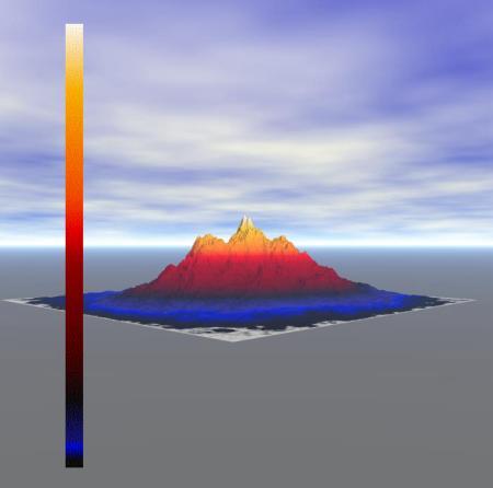

  • S RayS Ray Posts: 407
    S Ray said:
    Bryce terrain Editor does not support exporting colors. Altitude mask won't work. But you should be able to accomplish what you are trying to do in a photo editor. Here is an altitude render ( in Bryce ) using one of the altitude  material presets and the image map that drives it. You should be able to create a custom altitude map using any of the terrain altitude  materials presets as a guild. They can be exported in the material image library by coping the preview window and pasting in the image editor.   Probable need to apply the map planner to the front of your terrain in the 3D program it's imported to. Hope this works for You
    S Ray said:
    S Ray said:
    S Ray said:
