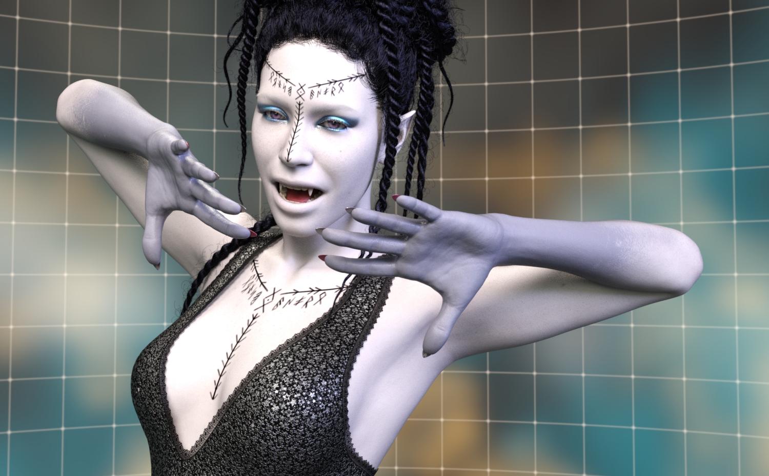

    I uninstalled the base product just to see because I was curious also.  I mainly only tested the Tauriel material files because i figure its going to be the same with both.  You will get missing file errors but for the most part everything seems to work.  I say this with trepitation because it is possible that not all makeups will work correctly because most are built on top of the head textures so keep that in mind.   For this testing I used bluejauntes Tyler base mats.
    Here is what I found:
    All morphs (ears, teeth and nails) all work fine.
    The 4 all mat colors seem to work fine,  of course the color you get will possibly be affected by the base texture you use.  You do receive missing file errors but as far as I can tell it leaves the ones that are already there.
    The eyebrows mats do not work with the default load eyebrows with gen 9 or with alternate eyebrows.  (Gives a missing UV error)
    Eyelashes work. Missing textures error.
    Eyecolors work.  No error.
    Glitters work
    Eye makeup works. Missing textures error.
    Nails work.
    Geoshells work.
    Image (No Base Loaded):
    Image using Tauriel base:
    1500 x 928 - 684K
    1500 x 928 - 685K
    Post edited by Daventaki on
