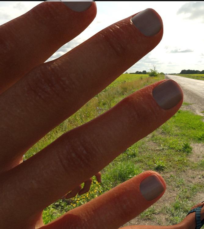

Hey, I work since 3+ years now with daz3d and I encounter kinda with every char I load the same result: I hate the base color of the fingernails.
See attachment.
For the girls, I make it easy and just add nail polish.
But just genereally, it's annoying, is there some good preset for G8F+M which I can use on all to have clean nails for all?
668 x 752 - 143K

    That mostly comes from Translucency and SSS settings on Fingernails surface. You may check and tweak them first.

    A quick example from https://www.daz3d.com/abel-for-genesis-3-male, the default setting is on the right which is totally unacceptable to me even if the character is not a young guy. Tweaking Translucency relevant slots is a quick way in most of the similar cases.

    Since Translucency Color ( with weight value <1 ) is a mix with Base Color based on texture maps on their slots, with the same weight, the bigger value you set on RGB, the closer the color will be to the Base Color + Base Color Map, or mixed with Translucency SSS map.
    As for why they all have such an ugly looking, well I would only say the settings from the authors might be based on their preferences but mostly not appropriate. Besides, with different lighting patterns and color temperature, etc., the result would be different, so... we still need to tweak them by ourselves.
