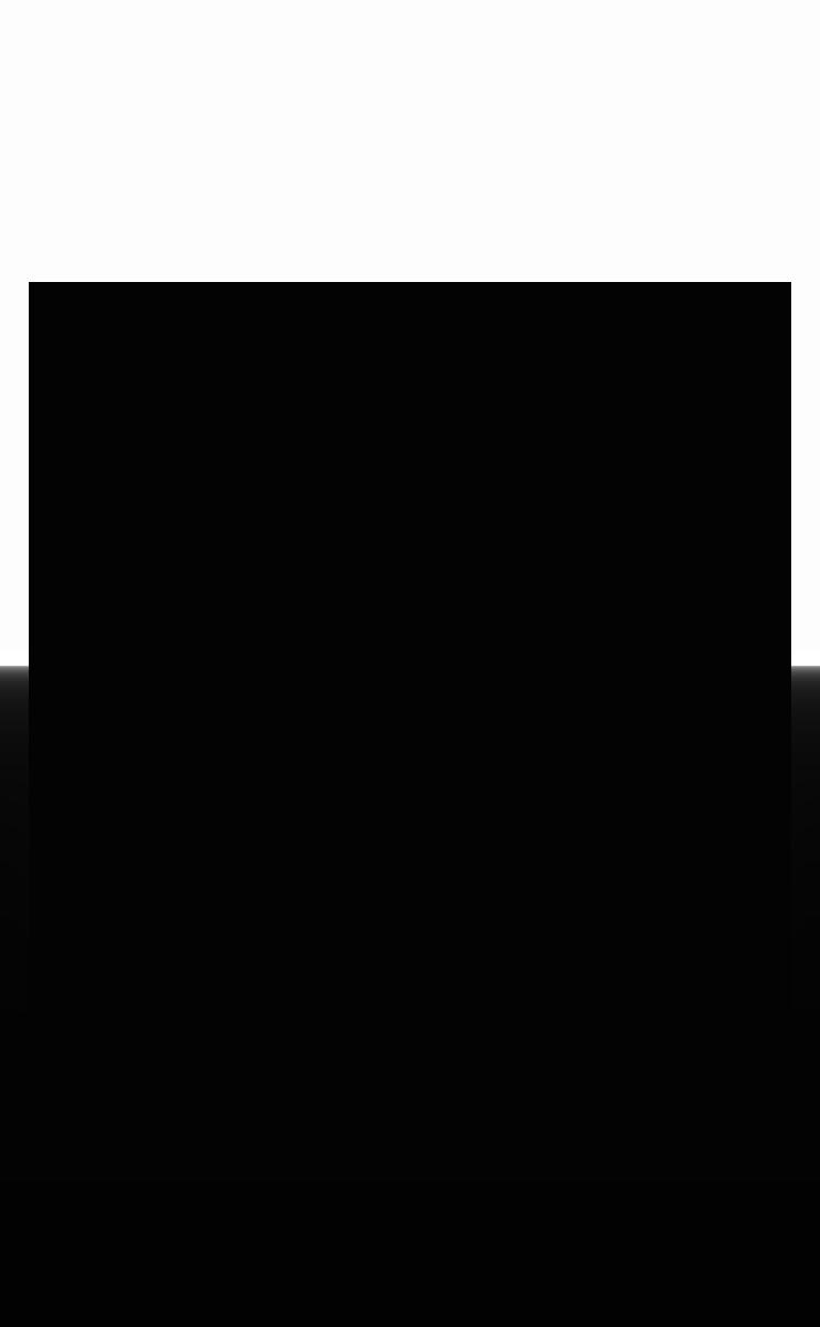

Has anybody else submitted this Depth Canvas bug?
I've been trying, without much success, to submit a bug report through the Help Center. The problem is most easily illustrated with the following three images.

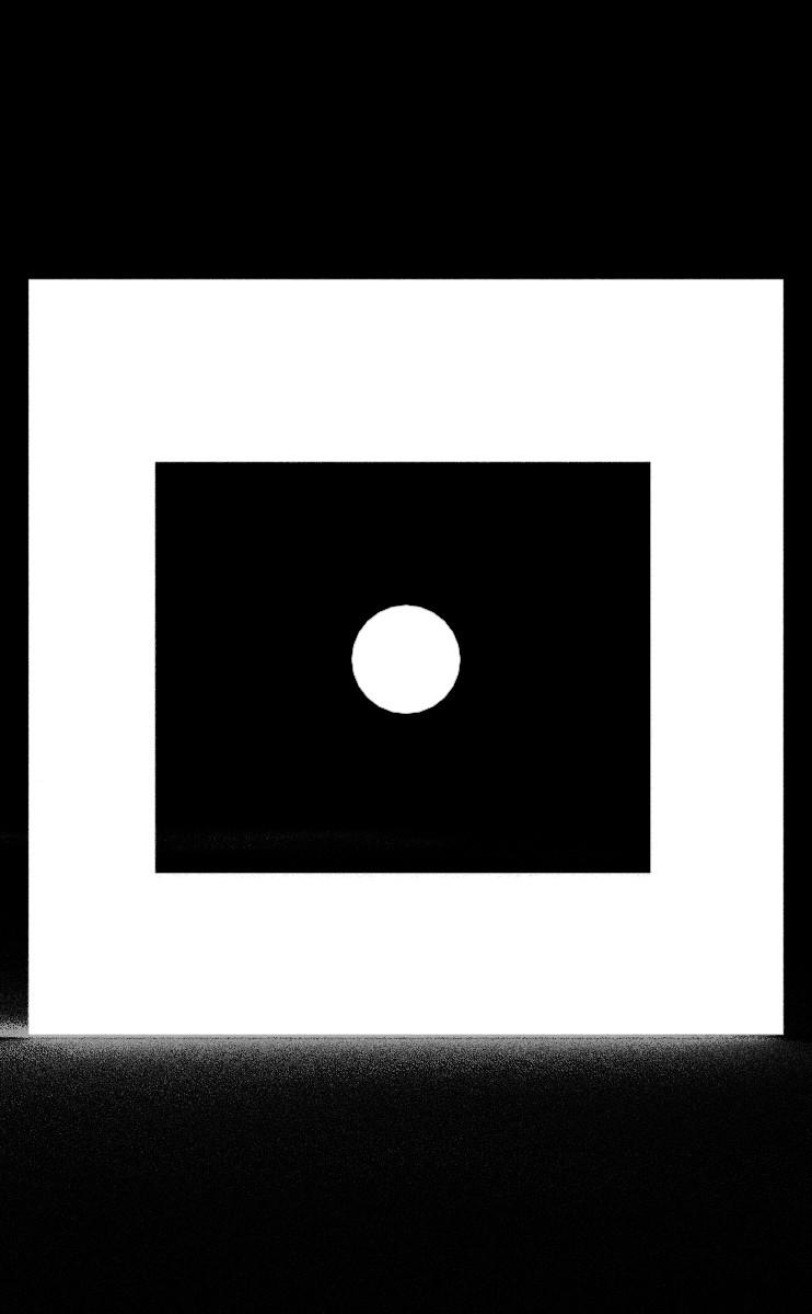

I rendered a simple scene with Iray Canvases enabled for Beauty, Alpha, and Depth. Depth fails to take transparency into account.
The below scene contains a red plane and a green sphere. The plane has an image provided in Cutout Opacity which makes the green sphere visible through the hole.
Beauty
Alpha
Depth
Beauty
Alpha Depth
I call this a bug or a serious mis-feature. I'm sure I've seen other mention of it in the forums, but I don't know whether anybody else has submitted a report. If you've encountered this "feature," chime in. Especially if you've submitted a ticket, speak up. Also, if you're willing, supply your ticket number, so I can convince the Help Center that I'm not insane.

    I wouldn't call that a bug.  As far as the renderer is concerned the geometry is solid.  The transparency map on the cutout opacity channel simply makes some of that object less opaque.  So for depth calculations, it's still a solid object.

    It should be depth as far as light rays are concerned, not just the geometry. The entire point of depth is so that you can do distance effects in post. Anyway, the help center finally agreed to pass it to the developers this afternoon. Hopefully they come back with some sort of statement one way or another.

    Depth calculations are based on the same principles as the old scanline renderer techniques (that were used for sorting to determine visibility of objects or polys.)  Surface characteristics are ignored, so transparency won't matter.   If you raytraced a line through it, it STILL hits the surface.  It simply isn't refracted and spawns a new ray along the same trajectory and the surface would contribute no color.  It's still a surface.
    While it would allow for some neat compositing effects, I'd still bet they'll call it 'working as intended'.
    If it is working as intended, then it's useless. So no z-depth maps for trees that use alpha maps for the leaves?
    On another note, using z-depth maps that allow for transparency does create an inherent issue. Consider the following scenario:
    Let's say white represents close to you, black far away, and gray represents the middle ground in your depth map. Now, let's say you have a 50% transparent window close to you with a far away object behind it. This window will render 50% white and 50% black in your depth map. It'll render gray even though neither the window, nor the object behind it, are in the middle ground.
    An unavoidable limitation, I believe.

    I think you need to re-evaluate just what a 'depth' buffer render is.  It is traditionally used to determine what order (from camera perspective) objects appear in...i.e., how far from the camera the objects are.   In old scanline renderers, this let them draw from back to front, and just overwrite further objects, thus generating correct object visibility.
    A transparent object is STILL a solid object.  If you use the above example images, the red plane is STILL in front of the green ball.  Even if part of it is transparent.  This is the difference in using a plane, and using a mesh that actually has the center section cut out.  As far as the depth buffer is concerned, transparency doesn't exist.  ALL objects are treated as opaque.
    What would it do if your concept was correct and the central part of the red plane was partially transparent?  Translucent?  Depth is a question of distance from the camera along the view direction.  The plane is still a solid object, regardless.  Raycasting techniques use the depth buffer to determine WHAT needs to be tested against first.  Your way would have it test against the ball BEFORE it tested against the (potentially partially) transparent plane.  This would render the ball 'in front of' the plane, since the green ball isn't transparent, and no further rays would be spawned.  This is what a depth buffer is used for.  Not sure what you are hoping to use it for.....

    @hphoenix, if what you say is true, then depth is entirely useless in post processing. Almost all scenes have transmaps (hair). Iray/Studio should be producing a depth map identical to what it uses in depth of field and volume effects. It's obvious that Iray has this data internally, because those things work. Whether it's called "depth" or something else is semantics.

  • What do you want then ? if you have an object 5 meters away that is hit by a ray, so the depth value will be 5 meters, if the object is 50% transparent it is still 5 meters away, what should the depth value be... 5 meters + half the distance to the object behind it or something ?
    The depth value is the distance to the geometry, no matter how transparent it is it's the same distance, that's how it works and have worked since the stone age.
    The problem is that transparency maps are used for things it should not be used for, transparency add transparancy to geometry, but the geometry is still there, most other software has a clipping feature (often called clip maps) that is used for clipping away parts of geometry that would generate correct depth values, but I am not sure if such a thing is available in DS/IRAY (I don't use it for rendering).
    But hair is often transparent to some degrees and in that case a clip map will not work, but once again, what kind of depth value should you get from a 50% transparent pixel ?
