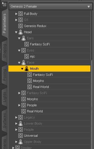

I finally got DIM and DSON to work (I think) and finally was able to open my first Genesis and Genesis2 figs.  I even found Mats for them in Materials or Pose.  But I can't see any way to inject morphs into them, like with the regular DAZ Poser figures (V4, M4, D3, S3, etc.).  So, while I can bend arms and legs on the figures, I can't even make them smile, open their mouths, make expressions, etc.
I'm pretty sure are the morphs are in the "data" folder, but since it's outside Runtime how do I access all the injectables??

    There are no injectibles.  The morphs are already loading and will be found in the Parameters or Shaping tabs.
