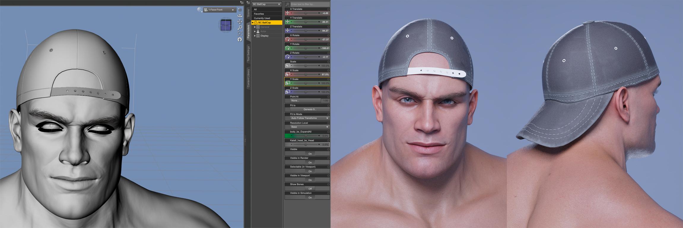

  • I took a quick stab at it with an older scene that used the ball cap.
    Set it up as crosswind suggested and then I used the parameter rotation and translation dials to line it up.  Would probably be easier to position it doing as Richard suggested.
    Lee

  • crosswindcrosswind Posts: 10,249
    edited September 2023
    There should be no problem... and that's a nice fit done by leemoon_c43b45a114  Actually it'll be not easy to manipulate the cap in either way we suggested because of its rigging. So here's another trick :
    - Alt + Shift + J, you'll see there're two 'Gizmos', one in red, one in green. Ctrl + Right Arrow to Left View, move the cursor to End Point on Y axis (red), drag it to the top of the cap. Then do the same on Origin on Y axis (green), but to the bottom of the cap.
    - Alt + Shift + T, change Translation and Rotate accordingly and further manipulate it as needed.
