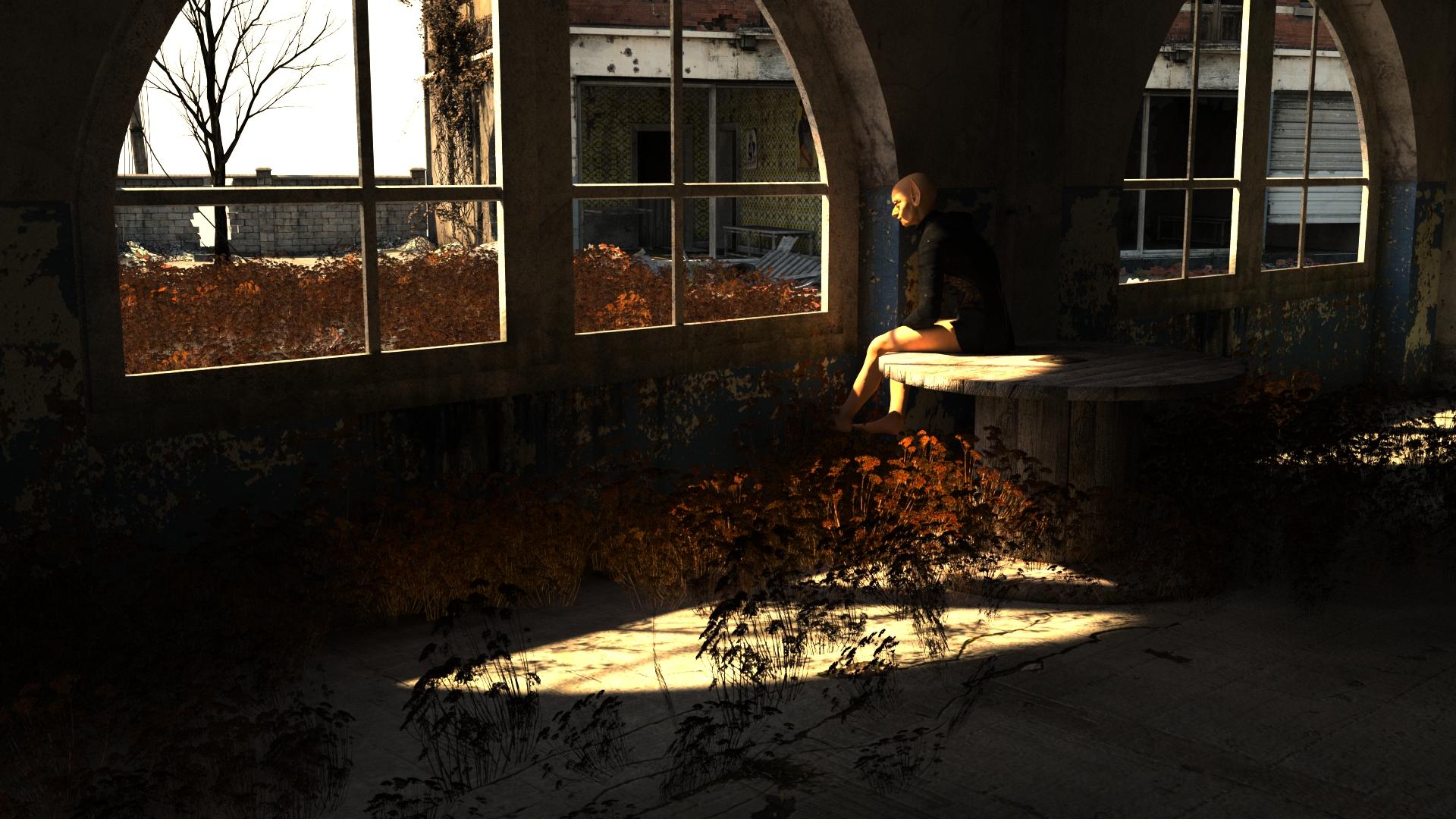

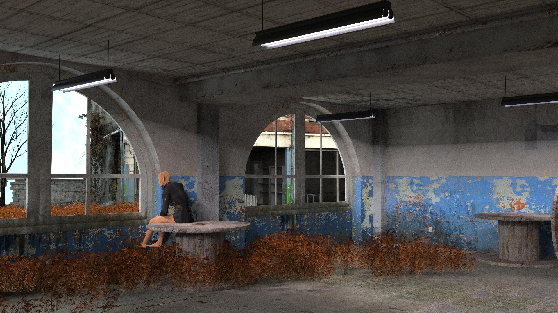

    Find the fluorescent lights in the scene and use the Surface selector to select the bulbs and make them emissive. Also use the Tone Mapping to set the camera for an inside shot. You can get away with 1500 Lumen for the bulbs and set the Luminance Units to cd/cm^2.
    I used the fluorescents in this image.
    Click on image for full size.
    1920 x 1080 - 2M
    Post edited by Fishtales on

    Go to the Scene tab and delete the Skydome, Iray doesn't need it as it has its own dome built in. The Skydome will block the light from the Iray Dome. Did you change the Tone Mapping? Try Shutter Speed 60; F/Stop 2.0; Film ISO 400. Also make sure the windows are using the Glass - Thin - Clear shader.
    This is the same render without the Bulbs  only Sun and Sky mode with the sun coming trough the windows.
    1920 x 1080 - 1M
    Appreciate the detailed info; basically my first time of perusing the tonemapper settings (looking in vain for shutter and iso values in camera settings but I got there in the end). Started with the window shaders to no avail and I was ready to quit and apologize to you all, but then only by filtering I finally found that ##@@! skydome thingy and deleted it. Oh boy, what a change that made! That in combination with tweaking the tonemapper settings made a spectacular surge of daylight come bursting in. Obviously a little too light for now but that is easily fixable by tweaking the settings of all the items I amped up in frustration. Many thanks, will definitely start using this loft and the lessons learned.
    PS: this pic attachment may require sunglasses!
    laugh
    1221 x 977 - 607K
