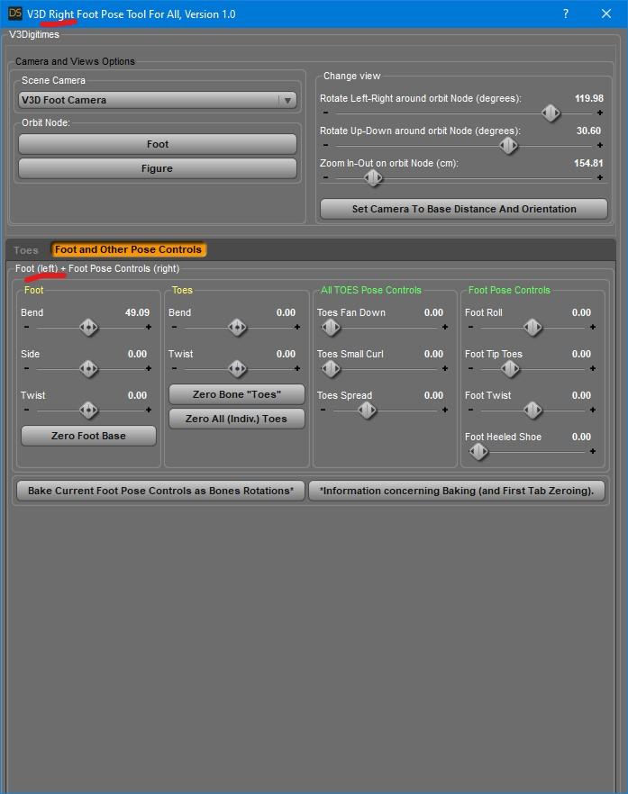

    A little typo here?
    697 x 882 - 100K
    Post edited by barbult on
  • V3DigitimesV3Digitimes Posts: 3,459
    Absolutely! I forgot to change this when I transformed the script from right to left foot!
    It will be added to my update session, thanks for notifying !
    Remark : Update sessions will not begin before next week, I need one week off... or maybe 10 days...
  • barbultbarbult Posts: 27,484
    Take your time it is a great and useful product. The text typo doesn't impact the functionality.
