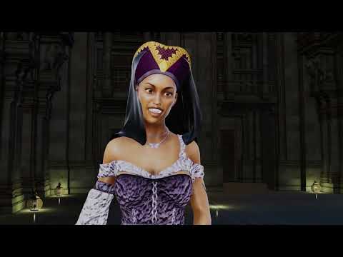

  • WendyLuvsCatzWendyLuvsCatz Posts: 41,647
    edited September 2023
    as someone who frequently used the openGL viewport to render quick animations Filament was not a big leap in as far as understanding how to use it  devil
    I can see how those rendering images with 3Delight or iray etc would be puzzled as it's not the usual DAZ workflow blush
    conversely there are those who don't understand how to render a finished image and wonder why the interactive viewport is missing so many things surprise
    it's all a learning experience yes
    mding said:
    Filament might become interesting once the problem with the transparency/opacity mask is solved. As long as that doesn't happen, its' use is very limited, unfortunately.
    I solved that by not using any cheeky
    my Filament characters wear hats, helmets or headpieces (or are bald) and no cutout opacity on clothing
    this has geometry shell shadows too
  • mdingmding Posts: 1,764
    @WendyLuvsCatz: Ok, that's impressive!
    And the hair is not really the problem, as there are SY hairs which consist completely of geometry. But take my forest render from above: the grass completely disappeared, some trees even lost all their leaves... IMO this really needs to be fixed, before i consider it a finished and useful product.
  • mding thanks
    and I solve that with plants with geometry leaves and geometry grass no opacity
