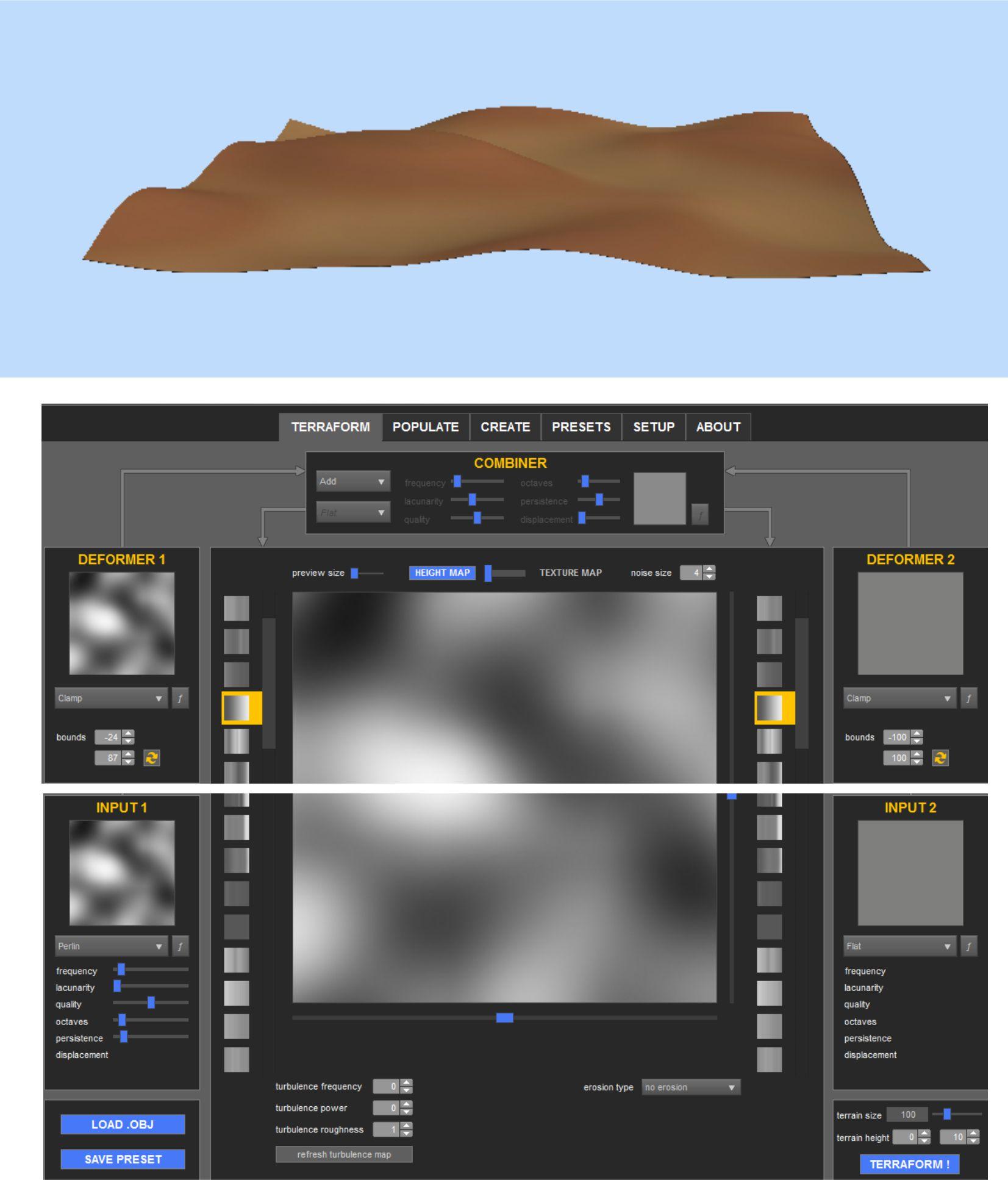

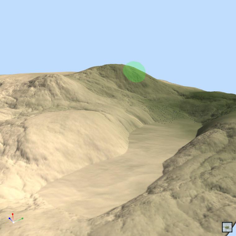

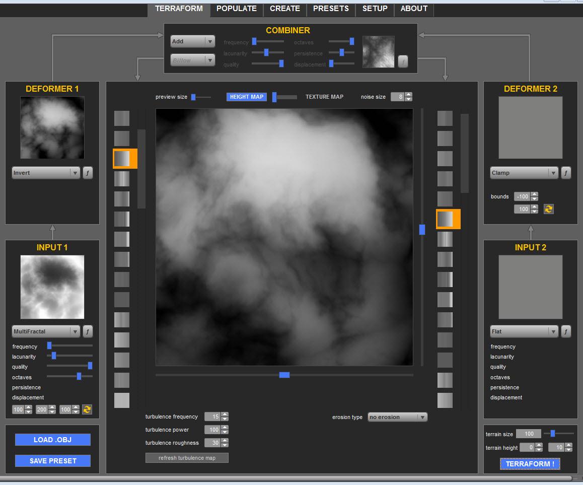

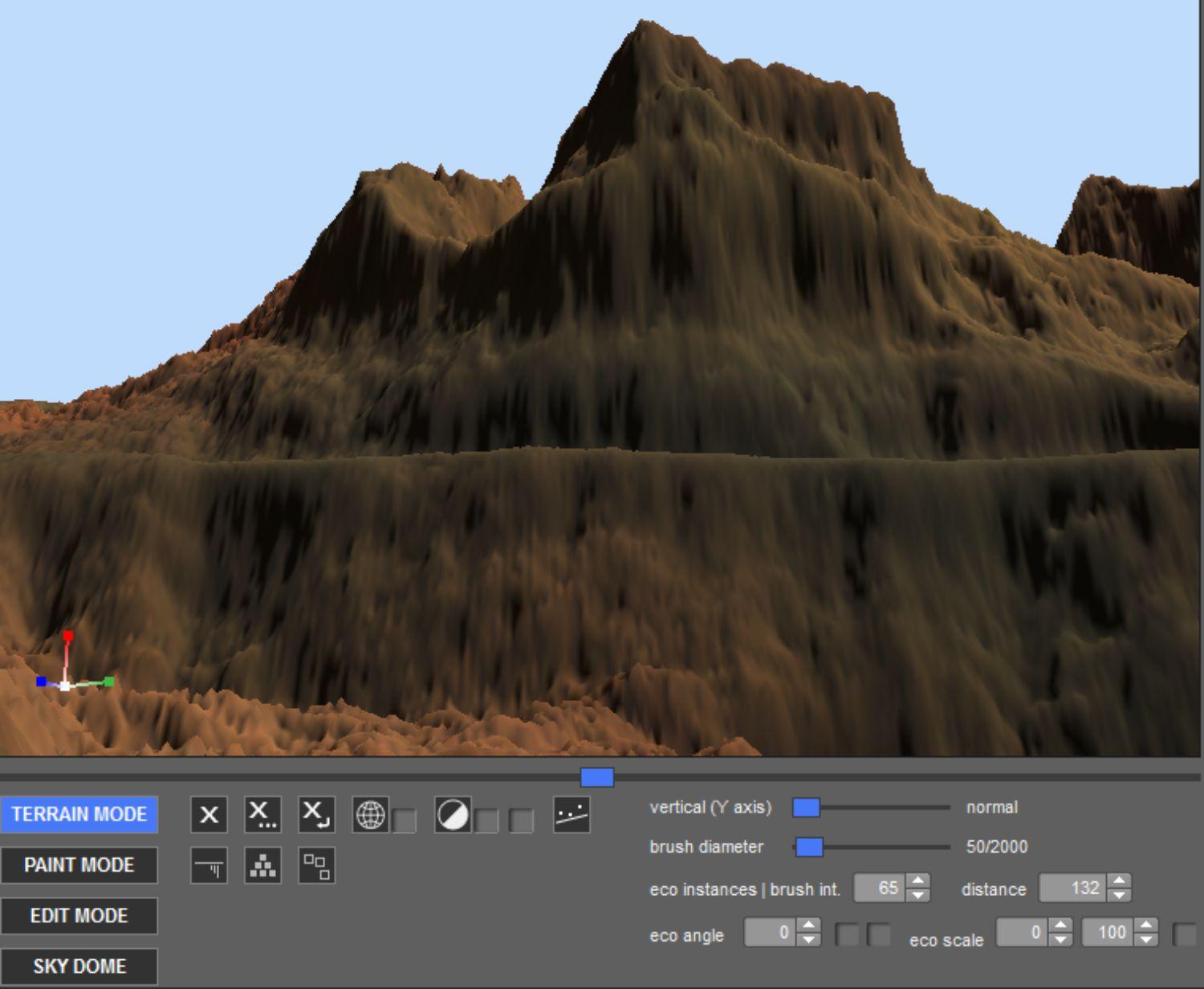

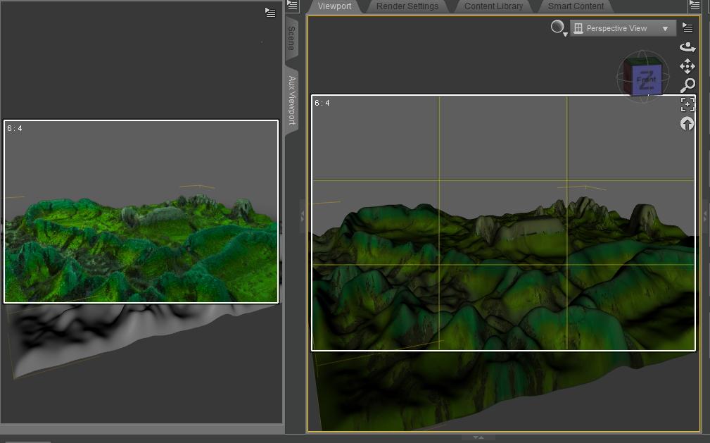

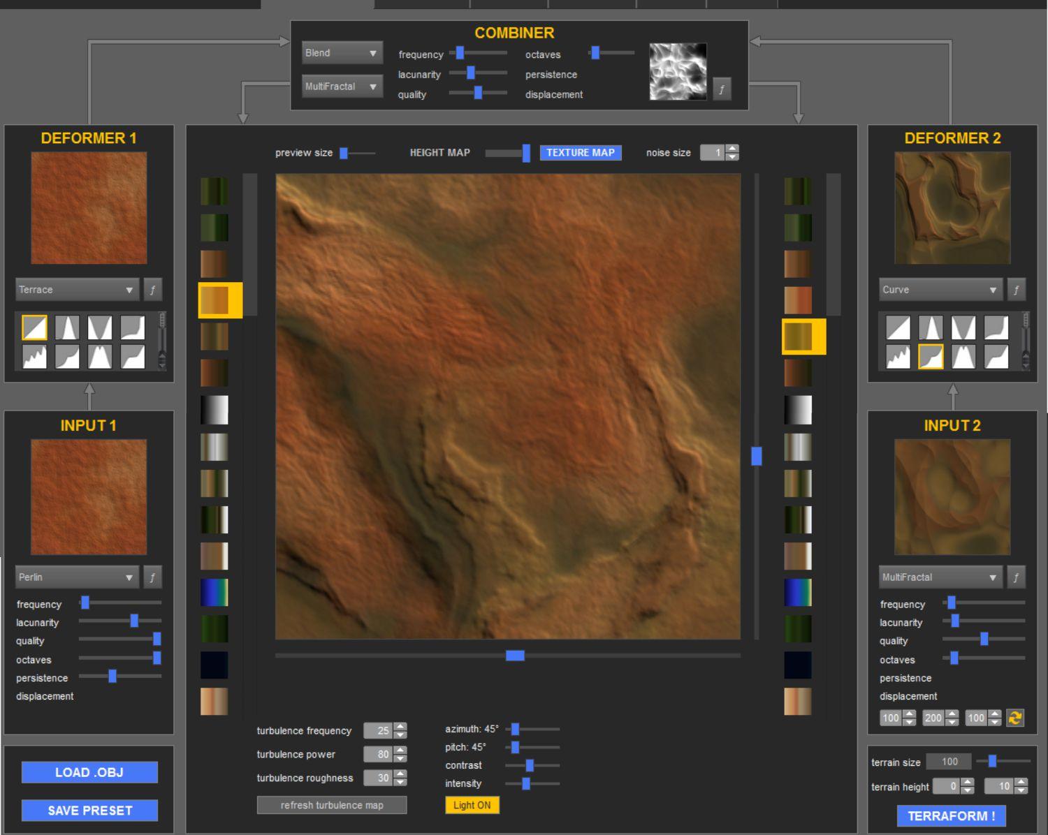

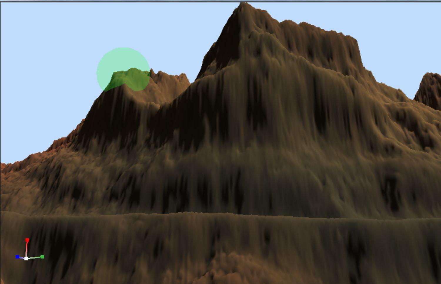

    Here's the screenshots of my setup. And the results once I clicked Terraform (which shows you the initial results) The first two show the same thing, but from different views. See at the top of the viewport? You simply slide the slider to change from your Height Map to your Texture map.
    The third one is the view that popped up after I Terraformed it. The others show different views. That's as far as I am right now. (You'll really want to read the PDF and follow along, then stop and play. I used Australia for the Texture/color.)  Be sure to click to enlarge, I did them 1500 pixels so you could see the settings.
    What you do: Your Deformer 1 and Input 1 will go up to the Combiner, and you can Blend, or Add (or more options) to the Deformer 2 and Input 2. Then at the bottom, you pick your Erosion level. (That's simplifying it a bit, but the overall gist of it. It's FUN to play with, don't be intimidated.)  WHITE IS HIGH elevations, dark is low.

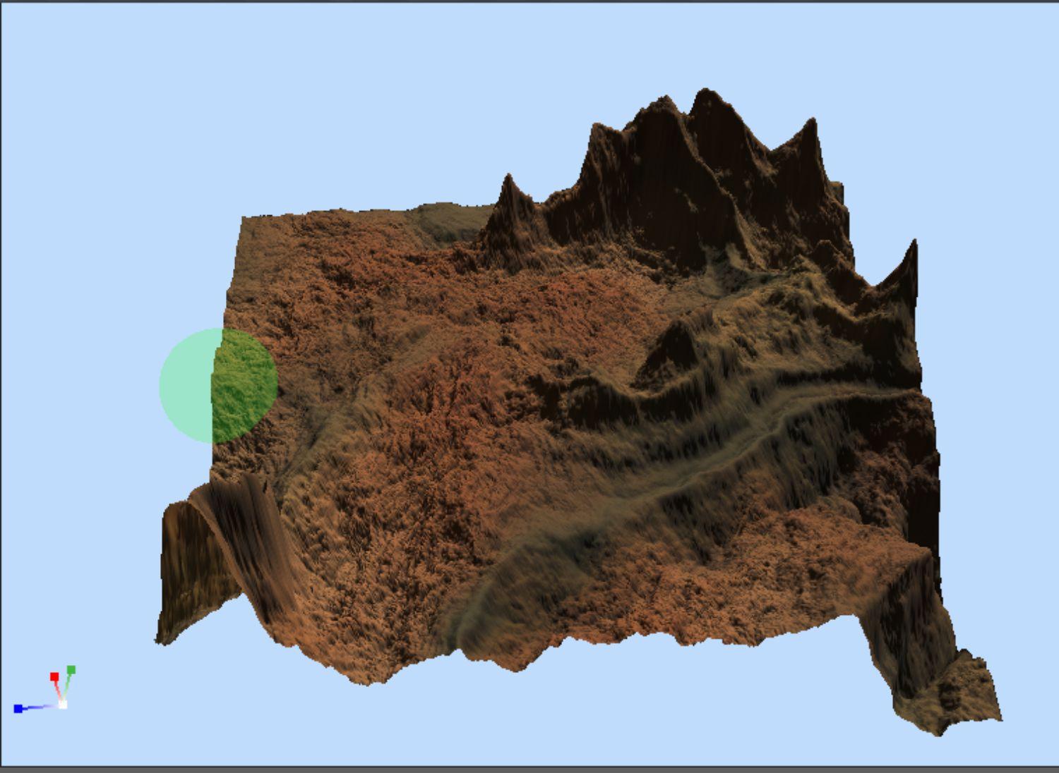

    The green circle is the brush. You can brush over the terrain and change it (such as height.)  The brush size and effect can be changed with easy sliders.

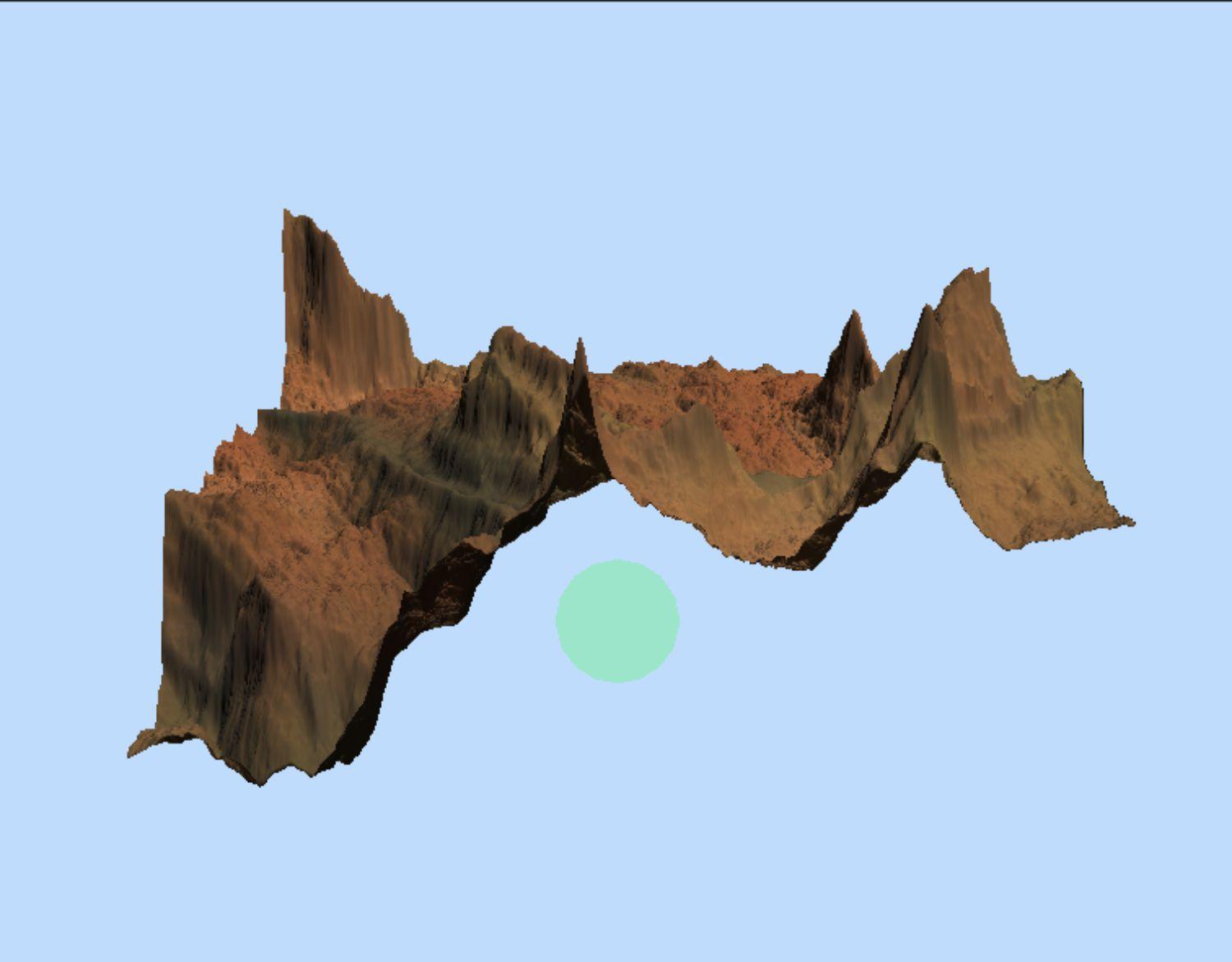

    I like this view for a waterfall. If I knew how to do it, it'd be awesome!

  • NovicaNovica Posts: 23,925
    edited October 2015
    Aha. Use SHIFT + Left Mouse on the brush to lower the terrain, without the Shift, holding the left mouse will raise it. Here's a screenshot showing the brush controls. In front of the "falls" I lowered all the rocks so you can see the bottom tier (but left it for "foam." (Although I doubt I tackle a waterfall right off the bat.)  I also lowered a bunch of spikeys that were on the left, to the left of the green brush circle, so there is a pretty sky view.
    1500 x 1232 - 138K

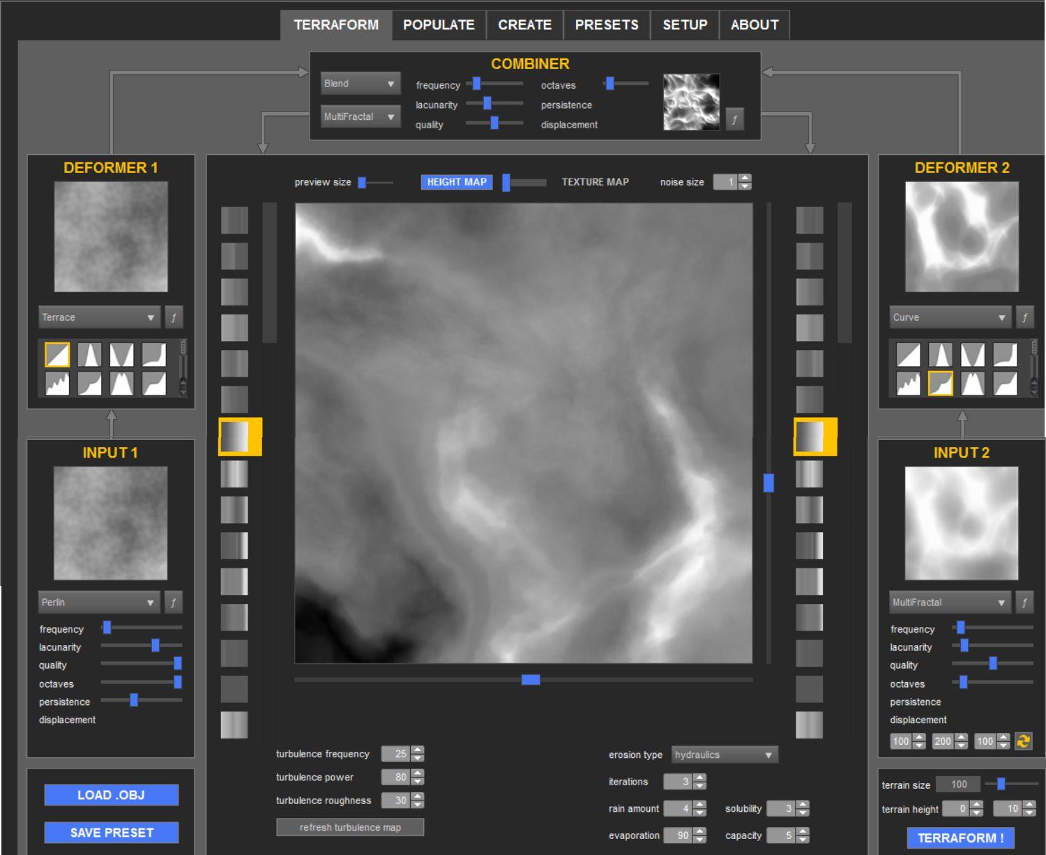

    Here are the settings for a rolling hill Infinito terrain. Click to enlarge then click again to get the settings.

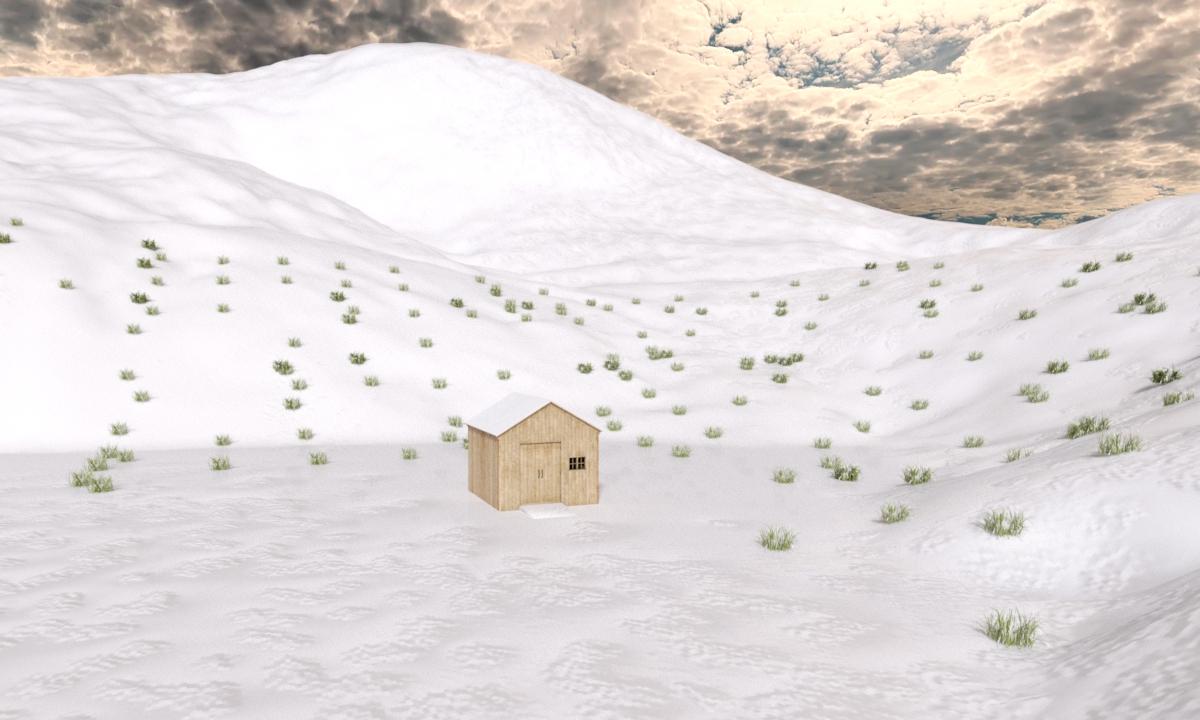

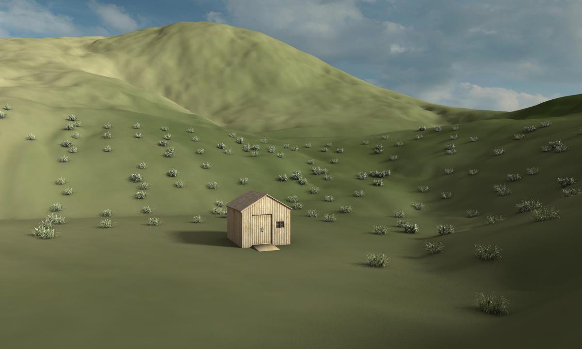

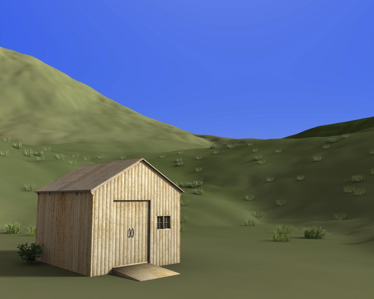

    I got my start in 3D with Bryce, which is focused on generating terrains, so INFINITO adds a welcomed landscape-generating capability into Daz Studio. One of the features I like about INFIINTO is the ability to paint duplicate props onto the surface versus placing them by hand yourself. Thought I'd show an example of how to do that. Note that the additional props are NOT instances, so unfortunately they can use up a lot of memory depending upon their polygon size.
    Heres the Terraform settings:

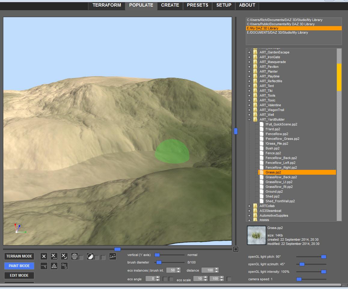

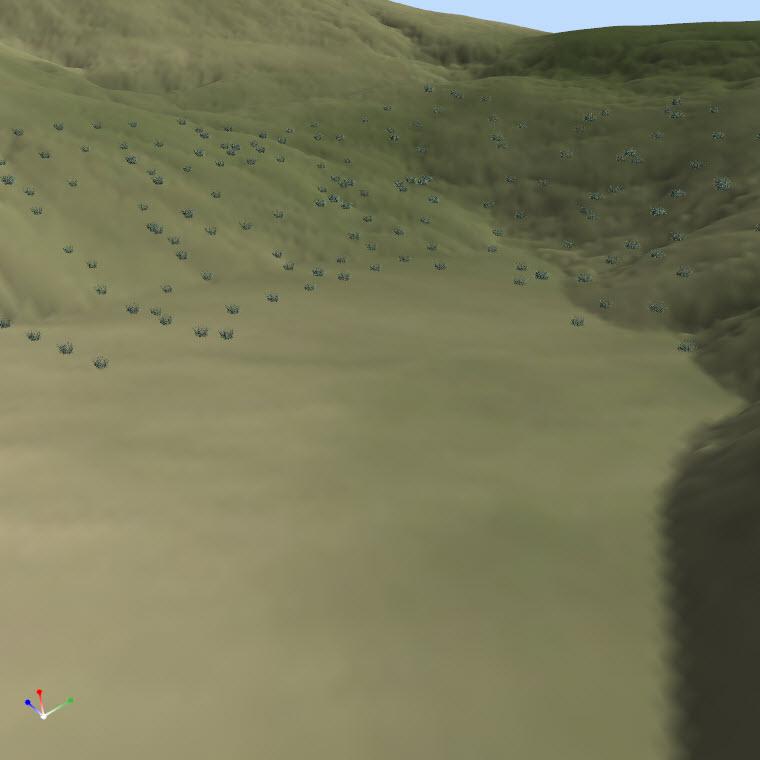

    After clicking the "Terraform !" button, I went to the Populate tab. There I used the brush in Terrain Mode to create a flat valley that softly merges into the hills at the far end. The default setting in INFINITO is to not go beneath zero, so I left that as is. To get an area flat, you have to brush over it multiple times while holding the left mouse button down to push the landscape low enough. To get the soft merge, I just click a time or two at the junction so the effect is applied only a little at a time. Here's an image showing the flat valley added:
    Next I selected the Paint Mode button. I then had to select the Daz Studio directory that contains .pp2 props. See image below. In this case, I chose Grass.pp2 from ART_YardBuilder. Since I wanted a lot of grass clumps, I set eco instances to 50, and as I wanted some size variation, I set eco scale to 10 ( which give +/- 10% scale variation). Each click of the brush will randomly plant 50 clumps of grass at the surface of the terrain (this usually works OK, but some props will end up floating depending upon where zero is defined; in this case, the grass is at the surface). You can see in the image above I only painted grass at the far end of the valley to minimize the amount of memory used. EDIT: I forgot to mention that to choose the prop from the file list, you have to double-click on the file name. Also, to place more than one instance, you have to hold down the shift key when you click with the mouse button.
    Here's a closer view of the valley end showing the grass clumps in place:
    Not shown, but I next changed the eco instances to 1 and added one copy each of Shed.pp2, Shed_FrontWall.pp2 and Bush.pp2 from the Yard Builder set to the scene. I could have done this in Daz Studio, but it was just as easy to do it here and have them in about the right place.
    Going to the Create Tab, I then clicked on the button "Create Studio Scene" and the scene is generated and opens up in Daz Studio. I fine-tuned the placement of the shed and bush (the shed was floating above the ground). Here's a 3DL render of the final result:
    Although INFINITO creates a large landscape, you don't have to use it all in your renders. As shown here, there's usually some nice local areas  that can be used as a setting.
    I may have short-cut some of the explanation, so if any of this is unclear, let me know and I'll add to it.

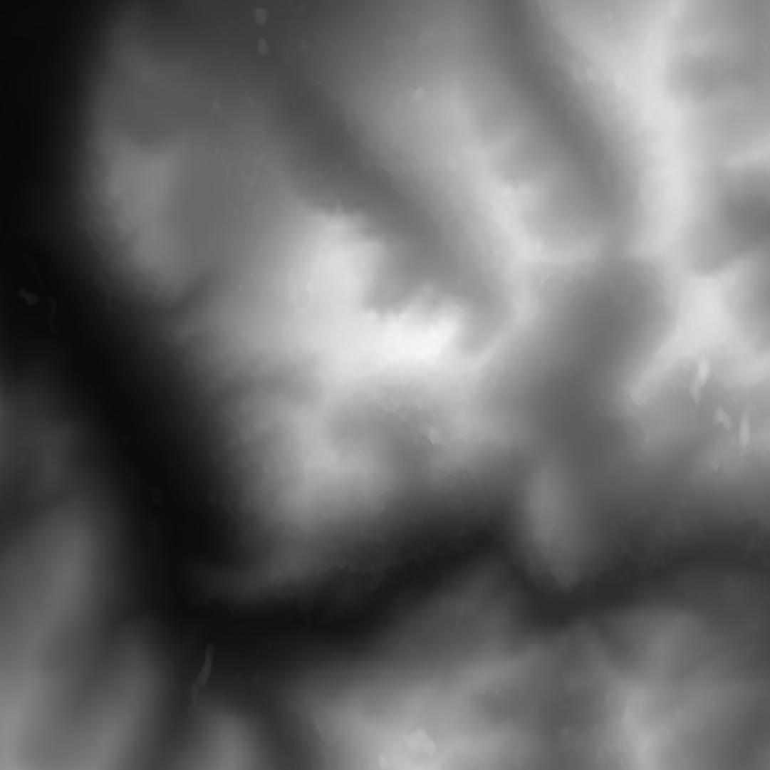

    You can download real world height maps for anywhere in the world from this site.
    http://terrain.party
    I have used them in Bryce and have just used one in Infinito.
    This is the area around Ben Nevis in Scotland. The best map to use is the merged.jpg which is below.

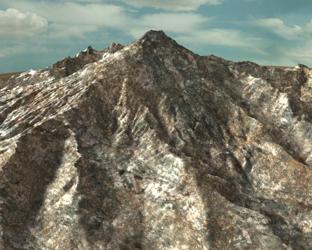

    My son is getting a 3D printer later this week and mentioned wanting to print a replica of Mt. Baker in Washington, so this will be a good source of data for him. I downloaded the Mt. Baker data and tried it in INFINITO as well. Works really well.
    To use the .jpg in INFINITO (the merged.jpg as Fishtales mentioned): download from terrain.party. Then on the Terraform Tab, under Input 1, select Image from the drop down box and load the image. I then switched to the Texture view and selected canadian tundra.bmp as the texture (left side, 8th preset down). Then go to the Create Tab and create the scene. Very fast and straightforward. In the image below, I added lights from 1stBastion's Wilderness: Two Creeks, the skydome from Via Serena, then Ctrl+click added the texture DNAT-Rock4 from Shades Of Life - Nature.

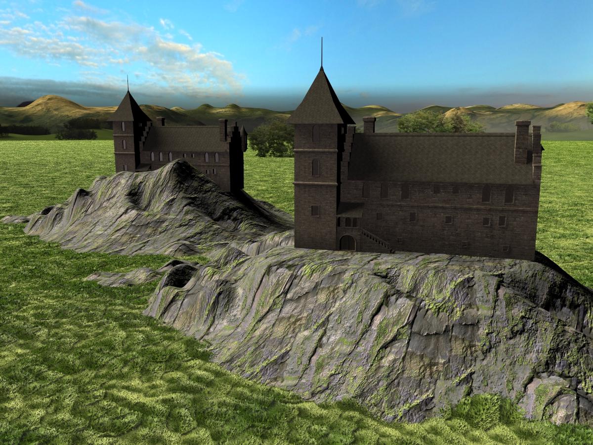

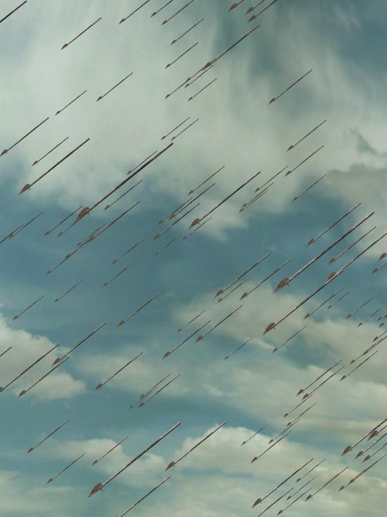

    In a prior render I showed instances added on top of a terrain. You can also use INFINITO to scatter instances in the air without showing a terrain. For the render, I created a rough wavy terrain with a very large height range (terrain size=100  and terrain elevation=50 on the Terraform tab). On the Populate tab I painted in 5 sets of 50 spears each, clicking in slightly different spots. After creating the scene, I  hid the terrain, leaving only the spears visible. You end up with a shower of spears (arrows if I would have had one in .pp2 format). Something similar could be done to give rain drops, snowflakes, explosions, meteorites, clouds, birds, leaves, Mary Poppins, etc. or you could do fish in water in a similar manner.
    561 x 748 - 267K
    Post edited by RGcincy on

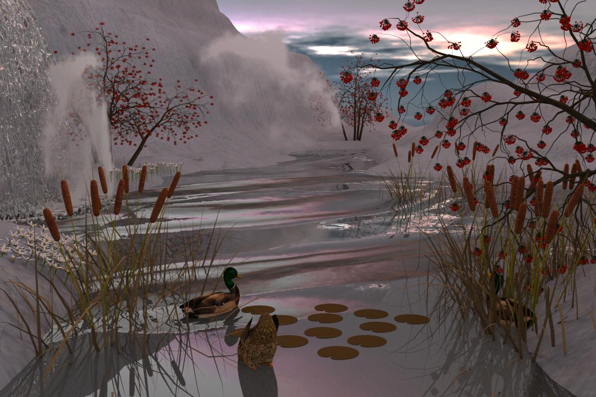

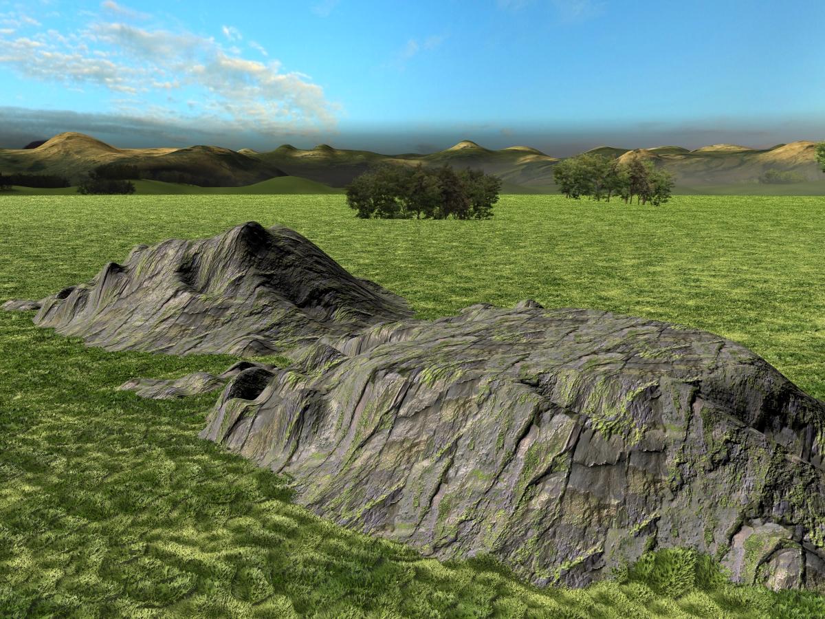

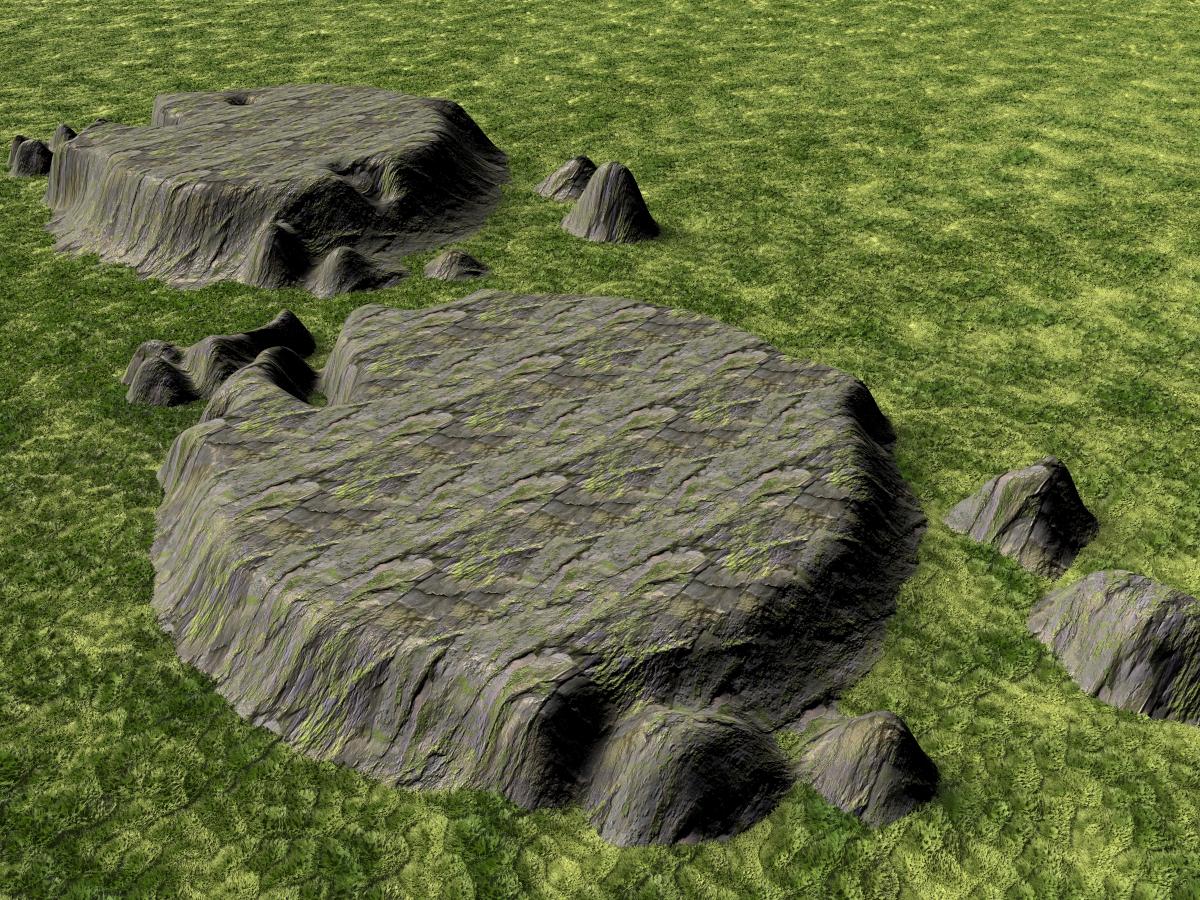

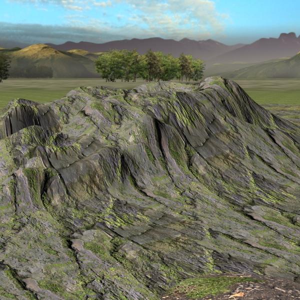

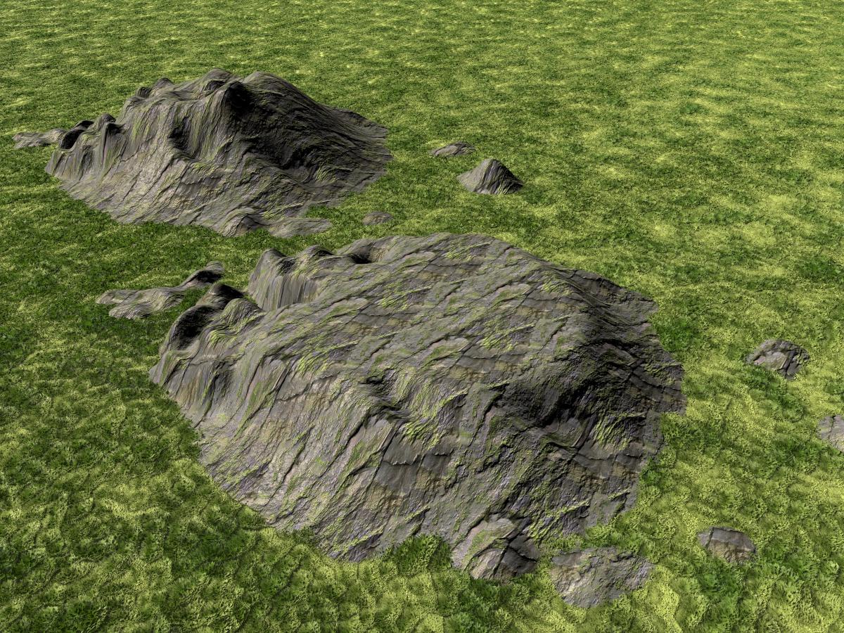

    Finally got around to another try with Infinito. This started with one of the terrain presets that comes with Infinito (dolomiti, the first one in row three; the only way to tell the name of presets is to hover the mouse over the preset until the file name pops up). I modified the terrain slightly by clicking on the third icon from left, row two of the terrace filter under Deformer 2. After creating the terrain and going to Daz Studio. I created two geometry shells of the terrain. On one of the geometry shells I put the shader RockySoild10 from Shades Of Life - Nature. I then added a tiler preset and set 50 horizontal and vertical tiles. I set opacity to 50% so some of the INFINITO terrain colors show through. On the other geometry shell I put the shader Moss8 from the same set. Tiling was set to 20, opacity to 40%, and the shell was translated +0.65 in the Y-direction. I used the geometry shells to get a more varied terrain and to break up some of the visual repetition in the shaders. The lights and skydome come from FirstBastions Two Creek set and the wolf is Daz's.
    I was wanting to see if the Inifinito terrains could be used for up close renders versus just a distant scene. I think this one works OK for that purpose. The shaders probably have the biggest impact as the terrains have really good variety in them already.
    1200 x 960 - 874K
