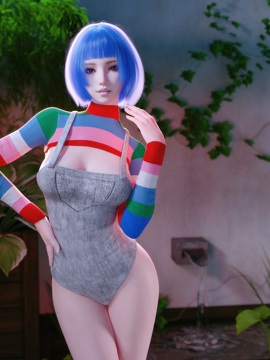

    In general, good effect from rim light(s) depends on 2 things -: 1) position and angle of ration of the rim light; 2) the settings of Surface(s) lit by the rim light ( esp. glossiness and SSS relevant ). Like the pic below: it's Dome + Scene mode, I put a rim light just behind the figure so as to make a rim on the hair and a Rembrandt and a fill light to lighten both sides. So the rims on the skin and top come from the glossiness, while the rim of the hair comes from the transmission.
    Sometimes, yes, ambient lights (HDRI, emissions...) and other lights you place into the scene may ruin the rims but that depend... For instance, different HDRI settings have different light positiong / angle / intensity, but they won't spoil your rim lights as long as you control them well...Don't put a harsh light just in the oppsite of a rim light otherwise it'll weaken the rim effect, so on and so forth...

    Thanks! May I ask what kind of light is this exactly? Behind the characer? What shape/type? Because if I try to do what you just did with the point light I get all the enviroment ruined if the wall behind is that close like in your picture, it gets too bright for example. And how far the light is from the character? just behind it as in stick ot it? Is it a mesh ligth, a surface light??
    Thanks!!!
    It's just a mesh spotlight with Cylinder geometry. I attached the scene file with the lights setup, for your reference. Pls try and tweak them as you wish.
