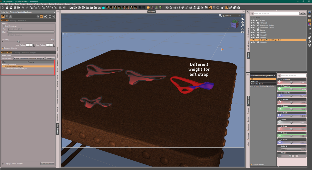

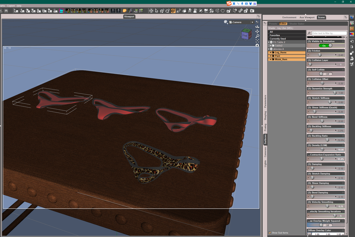

    Try to first switch off  'Self Collide' on dynamic surfaces, then sim it again... I ever helped a guy to sim the case just with a product from Causam, you may refer to the settings as below:
    - fall on a surface - : https://i.postimg.cc/v8kwvQ88/SNAG-2023-3-14-0018.png
    - hang and fold -: https://i.postimg.cc/x8tWyFzb/SNAG-2023-3-14-0025.png
    - make subtle change with dforce modifier weight node -: https://i.postimg.cc/6QLx34Fb/SNAG-2023-3-14-0022.png

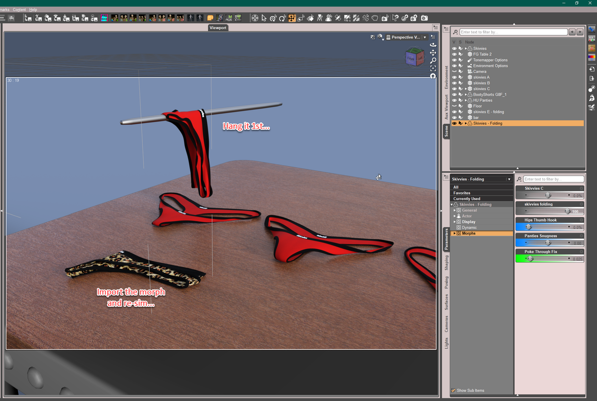

    Oh this one... the draping result looks good but as Richard mentioned, it's not really a good one...  Actually if you want to keep Self Collide on, you may add high value to Velocity Smoothing otherwise it will shrink first with no figure or other object to collide. Here's some params for your further reference.
    Sometimes I myself prefer to making it folded first, create a morph with it and go for a 2nd simulation. In this way, you can make more subtle changes with the draping result. Besides, the initial size, shape and position of such a garment influences the draping result as well, so better convert it to a Prop first, then it'll be easy for manipulation. Plus well using the existing morphs on it, and if you know some modeling / sculpting tool like ZB / Blender, you can finetune the result to make it even better.
    Anyway, the more experiments you do, the more better results you're gonna have.
