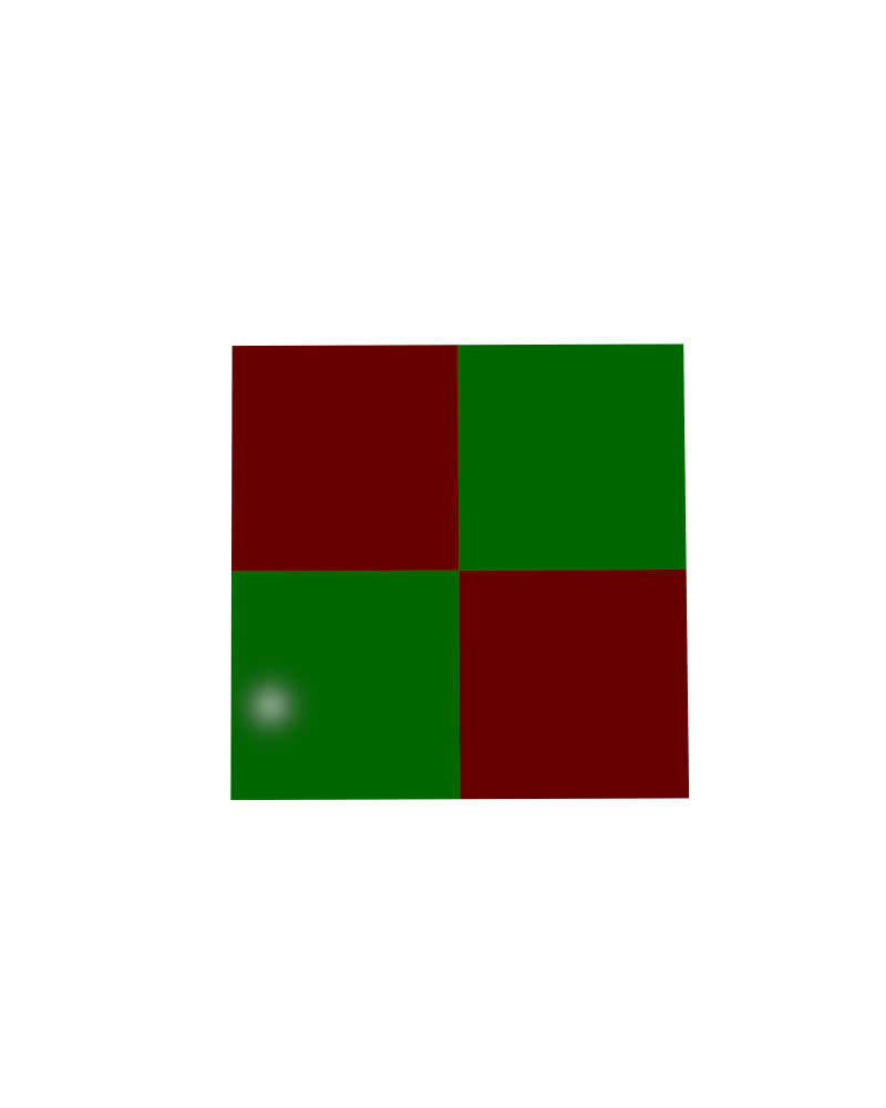

    Tobor said:
    A simple plane with 2 divisions creates a mesh with two triangles, which isn't bad. That would be the most efficient mesh light.
    No...a plane created by using a Studio primitive will, with 2 divisions, actually give you 8 tris/ 4 quads.  With only 1 division it will give you 2 tris/1 quad.
    800 x 1000 - 74K
    Post edited by mjc1016 on
