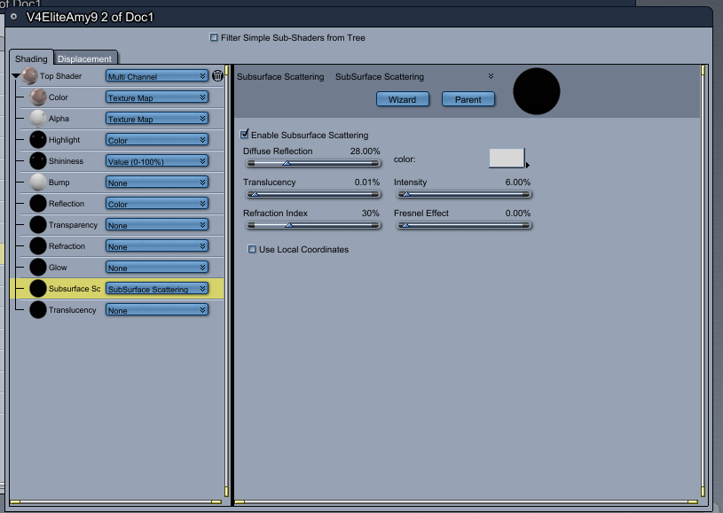

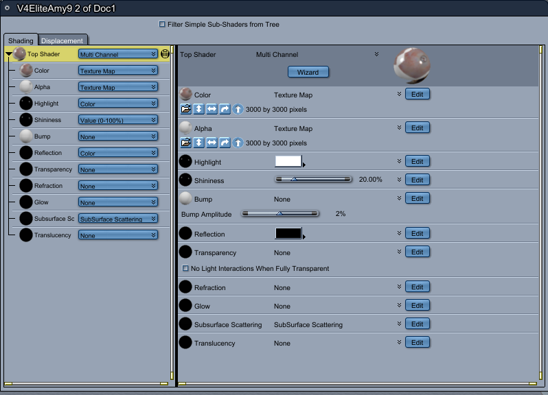

    Here's the shader setup I use currently for cornea, iris, and sclera:
    First here's the cornea:
    Next, here's the Iris:
    (all the texture maps are for the standard eye texture map that comes with the character)
    And here's the sclera:

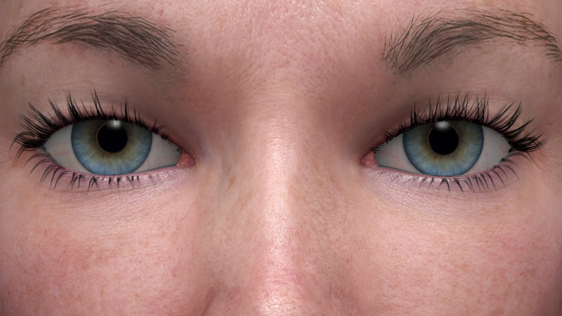

    You might notice I don't have reflections enabled.  Sometimes I do use reflection, but I find that just the highlight is usually sufficient for most of my needs.  Reflections will slightly slow your render time (not a biggie) but also stop some of the light from getting through to your iris, which has the net effect of darkening the iris.  But in certain circumstances, I also enable reflection (in the cornea).
    The eyes will only react though to a light source that is visibly reflected in the eyes.  There's a little cheat you can do to keep the 'glint' in the eyes all the time, which is to put in a light with a low brightness (say 10%) which is parented to the Genesis and has a point-at modifier so that it's always pointing at the head.
