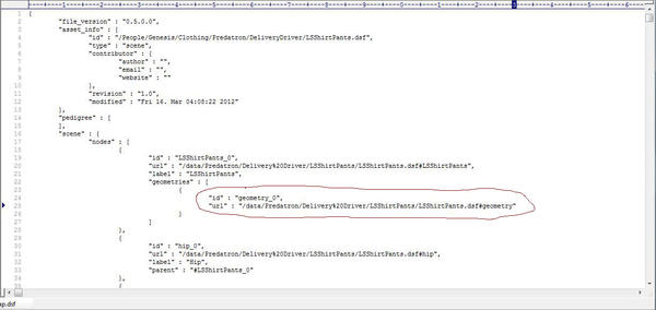

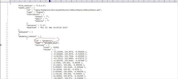

  • Phoenix1966Phoenix1966 Posts: 2,001
    Was busy looking at files in a text editor and didn't see Riggswolfe's post.
    If you open up the geometry file, you'll see the id is blank. I went in and added the word "geometry".
    If you open up the ShirtPant file in the People/Genesis/Clothing/...folder, line 24 and 25 need to be edited.
    What is circled in red is what the two files should look like after editing.
    Now it loads and renders just fine.
