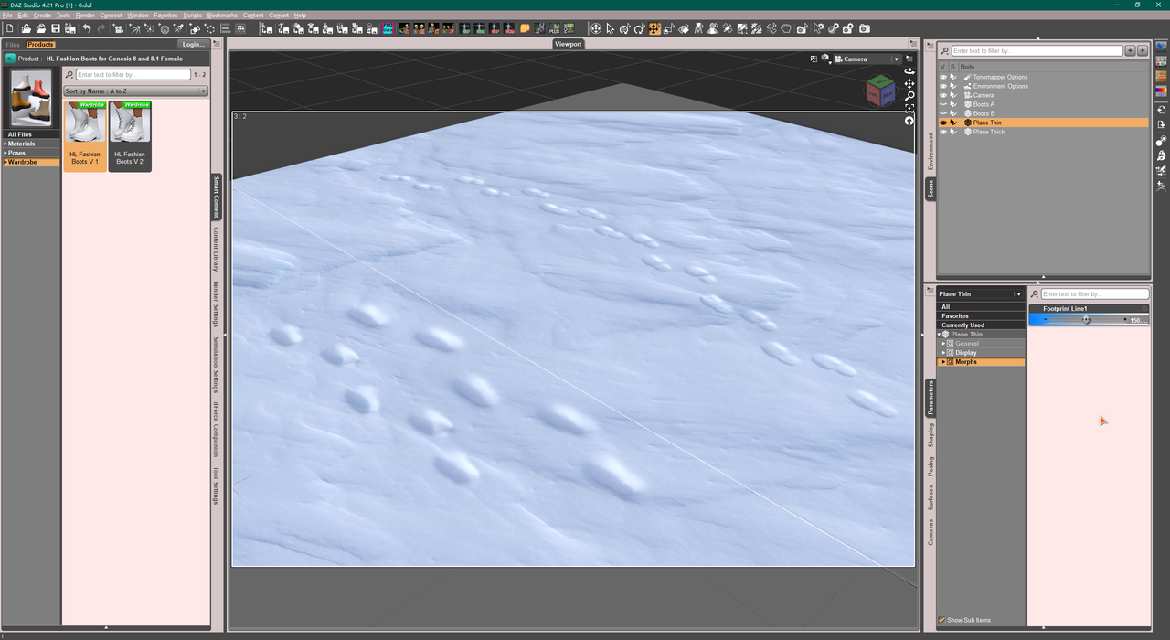

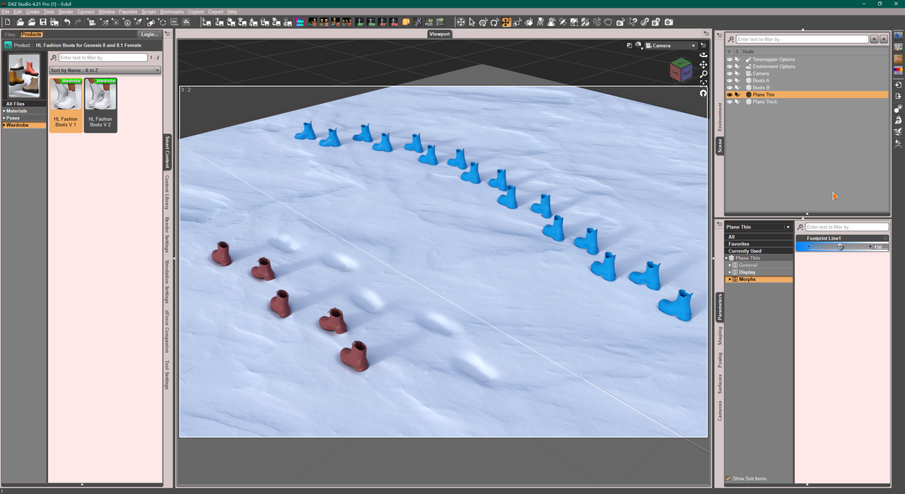

    I love dForce and use it a lot but TBH it's not an optimal option for such a case in terms of cost-effectiveness...(experimented before), dForce is not all mighty... So firstly recommend just using Smoothing Modifier + Collision...and you can well shape the size, pose, paces etc. of the "footprints object" to make various subtle changes, even plus Morph Loader Pro and Mesh Grabber to further manipulate and shape the footprints.... Done in 10 mins as below:
    In your simulation case, if you set a high Collision Offset value on that hi-Def. plane, I think it'll take a long time to simulate... Well, those wrinkles might've come from the dynamic surface settings and the collision with the existing land... Perhaps you may try 'negative gravity' + dForce weight node. But still, I suppose dForce won't bring you good and natural results...

  • pixelquackpixelquack Posts: 414
    Thanks crosswind, turned out my prop has to be leveled carefully to create the desired effect, and find the right spots around collision iteration / smoothing to have reasonable results against the high poly plane, works now.
