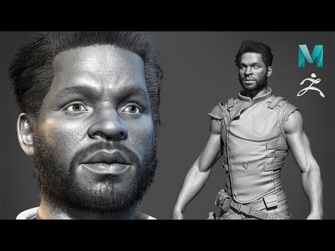

    Sorry for the late post. Your best results will be to create fibermesh hairs in Zbrush by painting a mask on the areas that you want to have bodyhair. You can create multiple masks in ZBrush and blur the edges. Then you export multiple hair meshes back to Daz3D. You could perhaps do 5 versions. Each one contracting to the inner most hair model, with the hair also getting longer towards the center. And you can assign darker materials to the inner layer. That way the hair blends out. What works well is applying a car paint color to the hair. That way it will reflect nicely. Or you can go with a matte paint. There is no need to apply any textures, the hair get their color variations depending on how the light hits it.
    The only drawback with this is you have to do this per pose. If there is a big change in the figure pose you'll have to repaint the hair all over. Well, that's how I understand it. Perhaps someone else can clarify.
    Here's a tutorial that illustrates how it works. There are other videos on Youtube that show how to get your figure mesh to ZBrush and return your modified work back to Daz.

    why would you go through all that when you can just use the native SBH Editor tool in daz
