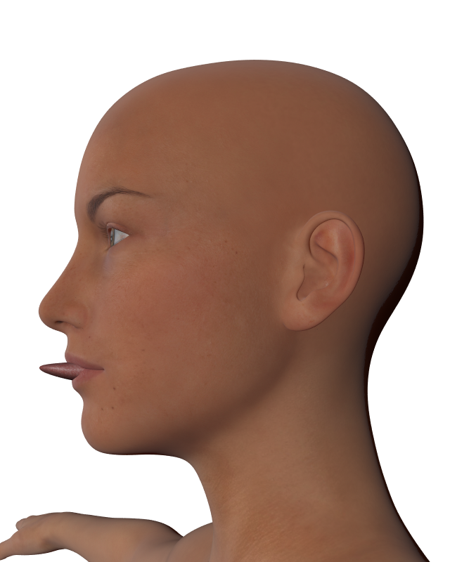

again like in all former figures in Gf3 there is a dial called
tongue-in and out
it just does not what it was ment for:
sticking the tongue out
can this flaw be repaired please
    edited October 2015
    Actually, the only problem I see is that the current limits stop it just at the lips.  If you click the gear icon on the slider, you can edit the limits.  Select Parameter settings and change the negative limit to about -350.  That, at full should put the tip of the tongue even with the tip of the nose.

  • jestmartjestmart Posts: 4,449
    You have more control if you use the tongue bones instead of the posing dials.
  • HavosHavos Posts: 5,704
    jesmart is correct, try resizing the individual tongue parts (I think it is z size that needs to increase) to get the tongue to come out further.

  • Hi thanks for the info everyone I also could not get V7 tongue to come out!!
  • RuphussRuphuss Posts: 2,631
    thank you all
    still a flaw in the dial isn't it ?
