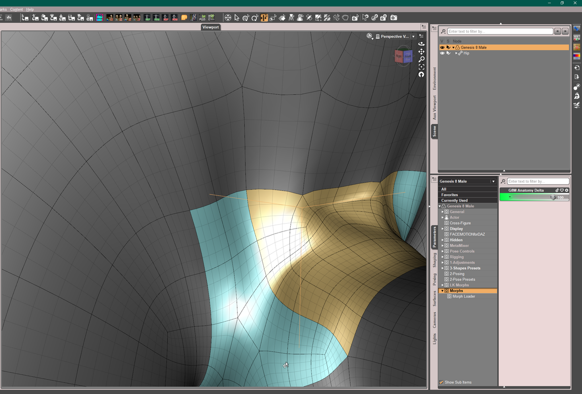

    Just to keep the correct conversation under the correct topic, since this one is about the geometry... This is the result I get from merging grafts whether I start with a morphed character or start with vanilla G8 and morph after:
    *edit to add*
    Even on an unmorphed character, it doesn't look like it welds correctly, like mid-way across the center it atatches too far down the inner thighs.
    617 x 530 - 42K

  • crosswindcrosswind Posts: 10,275
    As what I said above, it won't 'directly' work well with figure + dialed character morph on a 'merged figure'. You need to fix the body morph with Blender, ZB or sth. just like a PA fixes FBM / PBM / pJCMs... To be honest, if you're not good at fixing, pls don't go for this way of 'merging geometry'.
