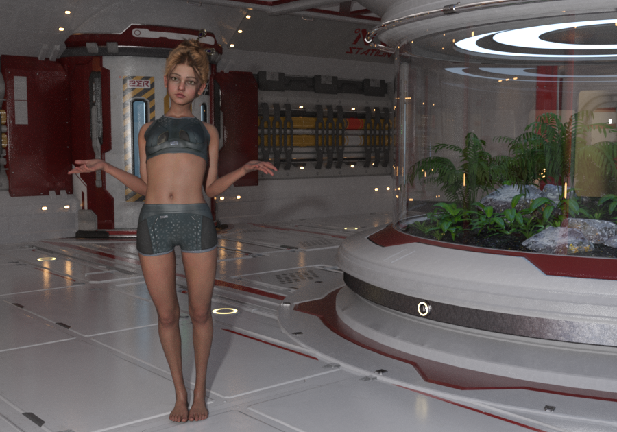

    Hello!
    I gave it a shot. If I just load the set and the hair, I also get a crash and DS closes. Once I switch  "Render Line Tesselation Sides" from the default 0 to 1, it works fine. Puzzelingly, the set and the hair by themselves render without issue with line tesselation at 0, just when you have both in the scene there must be some funny intweraction...
    Ciao
    TD
    900 x 630 - 897K

    See my post above as a work around, you can chnage the "Render Line Tesselation Sides" setting from 0 to 1. Then you can render the hair in the environment. At least that works for me.

    It renders but it also makes the hair a strangely shiney light color, and the hair strands start to look not quite right close up, but yeah at least it renders doing this. Hopefully there's an easy solution to this issue and it's not something too complicated. crying
