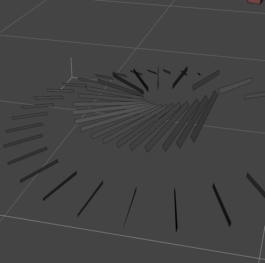

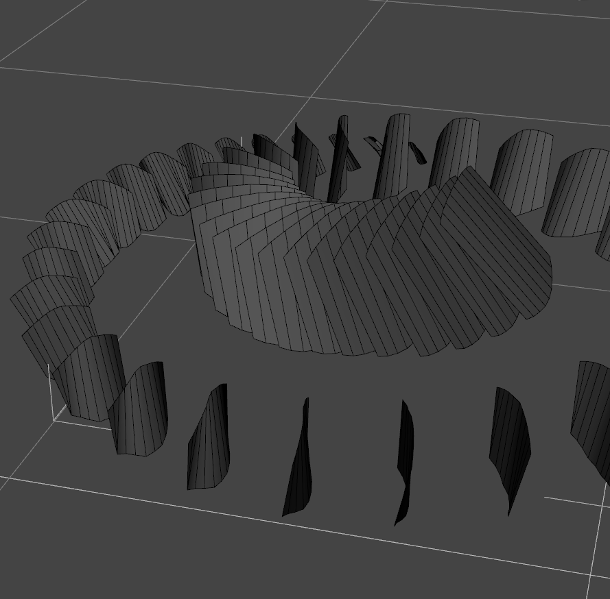

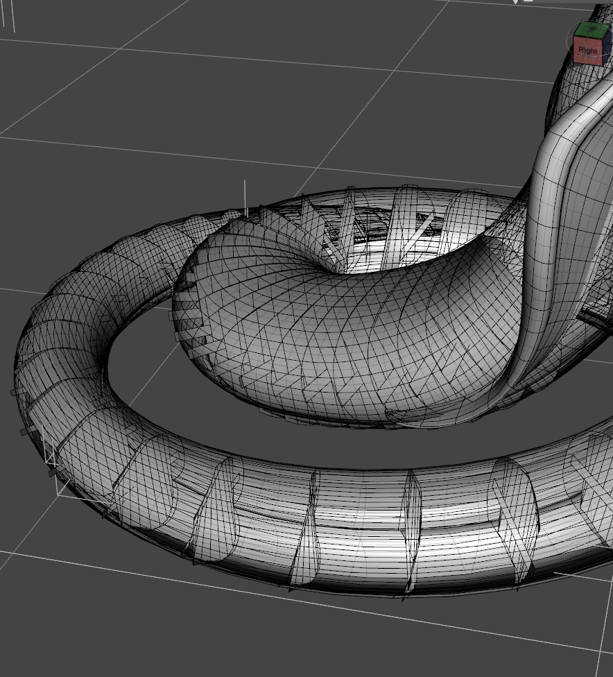

    I don't do a lot of animation so I'm not sure how far you can push it. For a cable you'd need a lot of geometry to keep it from collapsing. I did something similar on the Gorgon Tail so it can be simulated flat against a surface. I ended up with 2 add ons. One to support the main shape, and then another set to support the sides because they were collapsing a bit more than I liked during a sim. Combining both into 1 geometry didn't work as well, I got better results by splitting them into 2.
    First image shows the tail with the internal shapes in wireframe
    2nd image is the first addon
    3rd image is the second addon to support the sides
    4th image is after a sim where it dropped down lower on a plane

    Looks like I made my support addon slightly wrong. Thanks so much for the pics, they are super informative!

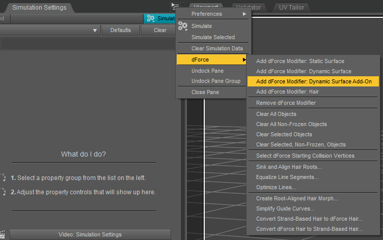

    Double checking that you're setting the add as an add on? Image attached
    I had exploding too when I made the add on too complex and detailed... changing over to 2 add ons each supporting just one direction helped for that. Adjusting your dforce settings will also help with explosions - its hard to say without seeing your mesh.

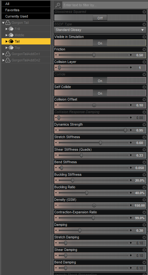

    This is the sim settings I have for the gorgon tail. Keep in mind that a lot depends on your mesh density. I tend to work in lower polygons, and then use subdivision in DS to up the resolution.
