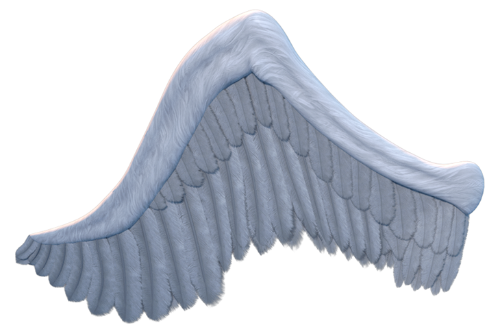

    What about the wings?

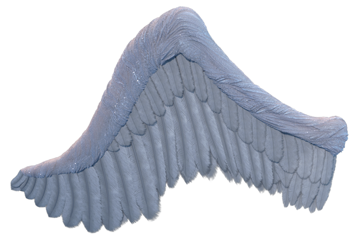

    I used Divine Wings, and applied the Iray Uber Base. The feathers looked okay, but the "arms" didn't look so good with Iray. The texture image was a nice seamless tile of feathers, but the same tile was used for the Base Color, Glossy Layered Weight, and Base Bump. And both the Horizontal Tiles and Vertical Tiles were set to 5, making the feathers very small. So while the lower feathers looked like feathers, the "arms" looked flat and painted on.
    Divine Wing with just the Iray Uber Base applied

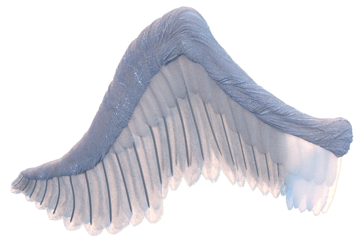

    I opened the image in photoshop and changed the "levels" so there were distinct dark areas and good contrast. Then I used an online site to generate a normal map from the revised image. In the Surfaces > Editor, I removed the image map from the Base Bump and added the new normal image to the Normal Map with a setting of 1.00. I then added my darker, revised image to Displacement Strength with a setting of 2.00 and gave the Displacement Minimum and Displacement Maximum higher values than the defaults, with a SubD Displacement Level of 3. After several test renders, I settled on the default Displacement Minimum of -0.10 and a Maximum Displacement of 0.25. Finally, I turned Thin Walled Off, set Transmitted Measurement Distance to 2.00, set Transmitted Color to a very pale gray (0.80, 0.80, 0.80,) set Scattering Measurement Distance to 0.50, set SSS Amount to 0.30 and set SSS Direction to -0.50.
    Divine Wing with changes to the Arm

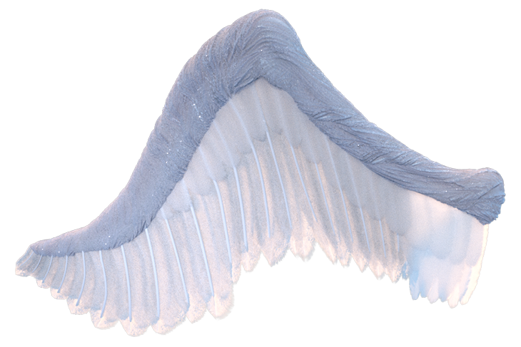

    I really liked the added dimension of the "arms" and I decided to see what high contrast displacement maps and normal maps would do for the feathers. I used the same settings for the feathers as I did for the arms, but it was too much. While it was an interesting effect, they didn't look like feathers anymore. I ended up removing displacement from the "FeathersMid" and dialing the Normal Map setting down to 0.20. For the "FeathersBig" I left the Normal Map setting at 1.00 and set Displacement to the default of 1.00, with the minimum at -0.20 and the maximum at the default of 0.10. Then I took it one step further and modified the trans maps of "FeathersBig" by using the L.I.E. and using the displacement maps as an overlay, inverted, and opacity dialed down to 25%.
    Divine Wing with changes to both the arm and the feathers
    The last thing I needed to change were the quills for the large feathers. They looked fine with just the Iray Uber Base applied, until I started adding the lighting. Then they looked really dark on the very white feathers. I tried a variety of Iray shaders, from white pearl to 24 K gold. I added a fill light on the wing, too. Nothing seemed to work. I applied a white plastic 3Delight shader and then reapplied the Iray Uber Base to get back to square one. At this point, I tried adding refraction. I left the Refraction Index at 1.5 and set Refraction weight to 0.50. And that solved my problem! With the quills semi-transparent, they now render white, even without the fill light, which I kept because the wing looked better lit.
    And here is the finished wing:
    Divine Wing with all my changes
    (These images were rendered specifically for this post and are for illustrative purposes only. Images were rendered for no longer than 30 minutes, CPU Only, and the quality varies.)

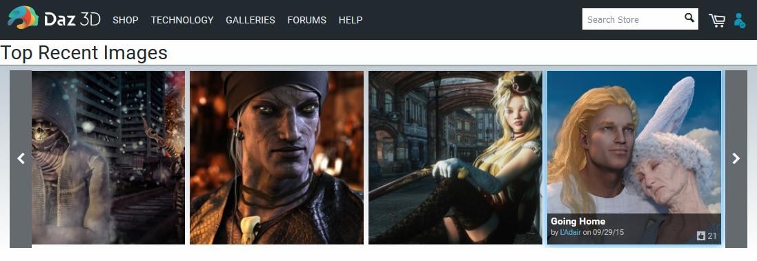

    Okay, this is off topic, but I'm so excited! Going Home made it to the Galleries "Top Recent Images" banner today. This is a first for me, so I just had to share. And more importantly, for each of you who took the time to visit the gallery page and gave this image a Thumbs Up, I thank you. Hugs.
    Screenshot of the Galleries banner from Oct 02, 2015

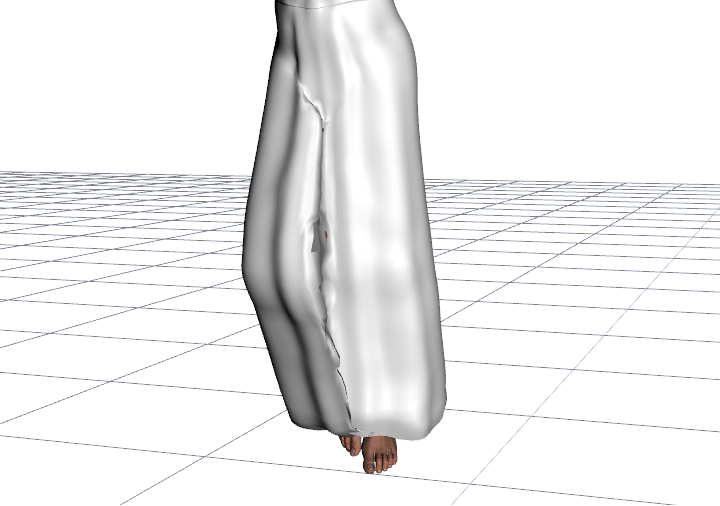

    After perusing G2F dresses in Wardrobe, I decided on the dress from Victorian Maid. That fit reasonably well, and hiding the collar and cuffs changed the appearance sufficiently. But there was a problem with the skirt and his legs. Here's what it looked like:
    Screenshot closeup of G2F skirt distortion around G2M legs using Auto-Fit

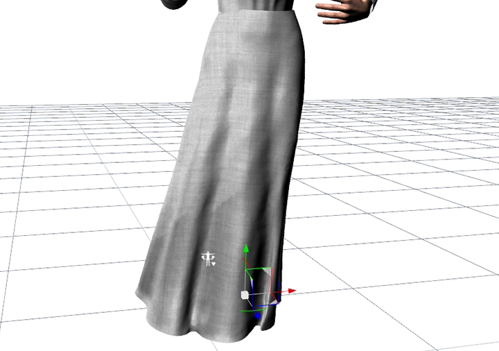

    I tried a couple other dresses, but I liked the way the Victorian Maid top fit, so decided to use a different skirt. The last one I'd tried was MeriMay Dress, so I went with that. I hid all but the skirt, and instead of trying to fit to the figure, I simply placed it where I needed it and tweaked morphs and parameters, as well as reduced the amount of bend in his legs, until he was covered and the skirt had the flowing look I wanted. (When I think about it now, I probably could have done the same thing using the Victorian Maid dress. Although MeriMay Dress has some really nice morphs for the skirt.)
    Screenshot close up of G2F skirt not Auto-Fitted to G2M
    The old woman hid where the two dresses came together, so it didn't matter what that looked like. Fortunately, this scene doesn't need to be seen from other angles... his left butt-cheek isn't covered. And from other angles, his waist shows as well. This "robe" is held together with the digital equivalent of duct tape and safety pins!

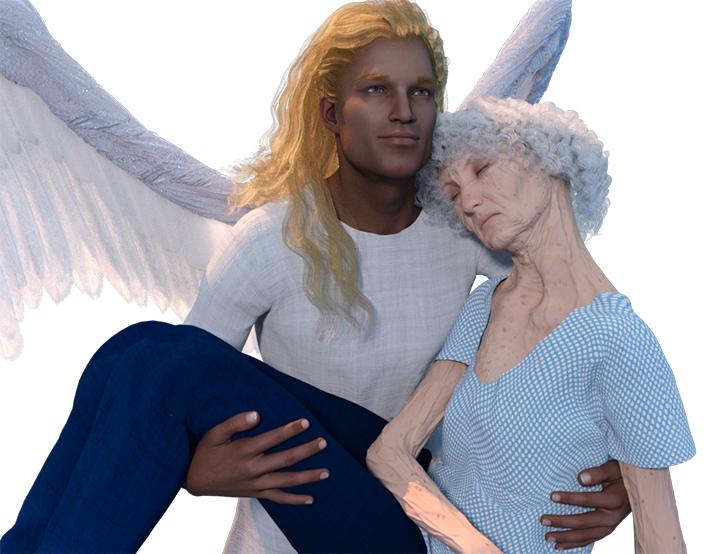

    I used FW Alfred HD for Michael 6, a recent purchase and a beautiful model. One of the reasons I chose Alfred is because Fred Winkler Art makes beautiful skins and includes Iray material presets. Another reason was the optional fiber mesh eyebrows. At this point, Alfred and his "cousin," FW Derek, are the only G2Ms I have with Iray material presets, and both have rather dark skin. Either could pass as having a dark tan, or as being of Hispanic descent. And while I can truly appreciate "tall, dark and handsome," it wasn't the look I was going for with the angel. When I added the blonde hair and eyebrows, he looked like someone had overdone the tanning spray!
    The angel before lighter maps are applied

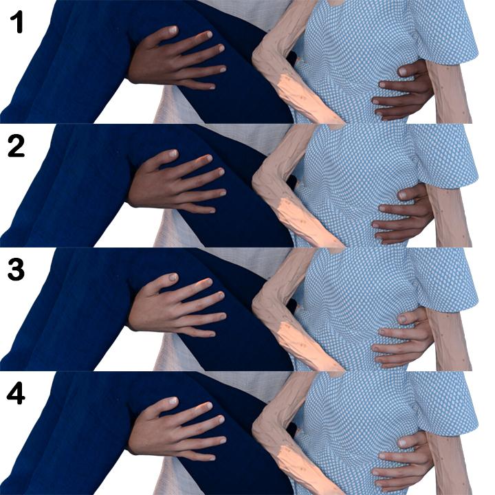

    To fix that, I used Photoshop and lightened the skin, applying the same filter to all three image maps. In the Surfaces > Editor, I applied my modified maps to the Base Color. That really helped, but his hands were still too dark. With the strongest light being the "sun" behind him, his hands were in shadow and looked like they didn't belong to him. They were made to appear darker, too, by the contrast with the pale skin of the old woman. Back in Photoshop, I lightened his hands even more. I was pleased with the skin tone in the next render, but his hands looked dirty around the nail beds, especially the thumbs. One more modification in Photoshop making the fingernails lighter and I finally had hands that looked like they belonged to a golden haired angel. The image below compares the hands from the original dark maps to the final lighter maps.
    The angel's hands compared, from dark to light maps.
    1. Original skin maps
    2. Lightened skin maps
    3. Even lighter maps for the hands
    4. And lighter maps for the fingernails

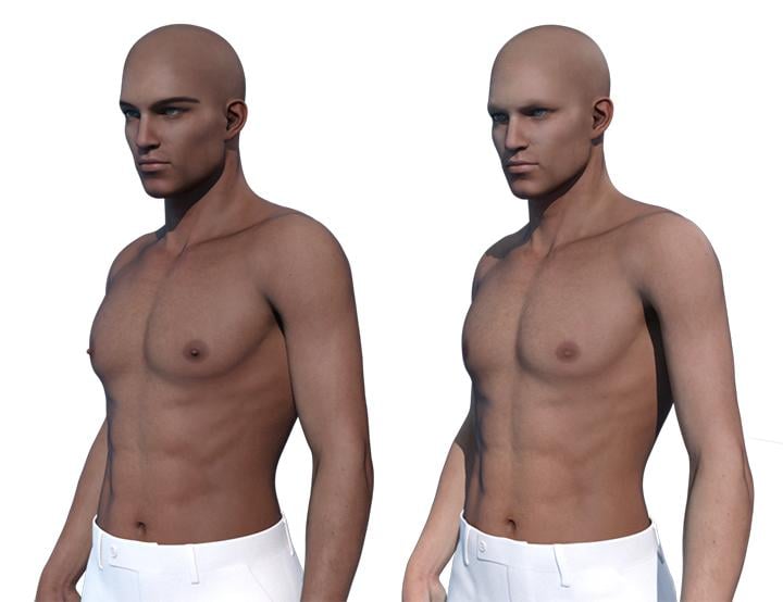

    Besides changing his skin, I used body morphs to decrease the depth of his chest and the size of his upper arms. It may be a subtle difference in the image below, but dressed in his "robe" with the old woman in his arms, his size was too dominant. His skin was showing though in places on the "robe", also, so I used Poke-Away2! for Genesis 2 Male(s) on his chest and left pectoral to decrease his chest to fit. And I dialed his nipples to 0.00 as they poked through, too. The image below is a comparison of Alfred without any changes and Alfred with all the changes I made to him. (When I lightened his hands in Photoshop, I used a gradient mask, so his arms get lighter gradually down to his hands. It looks a little weird here.)
    Before and after comparison of the angel.
    (As an aside, I find it interesting how different the two faces look with the eyebrows missing from the right figure, above.)
