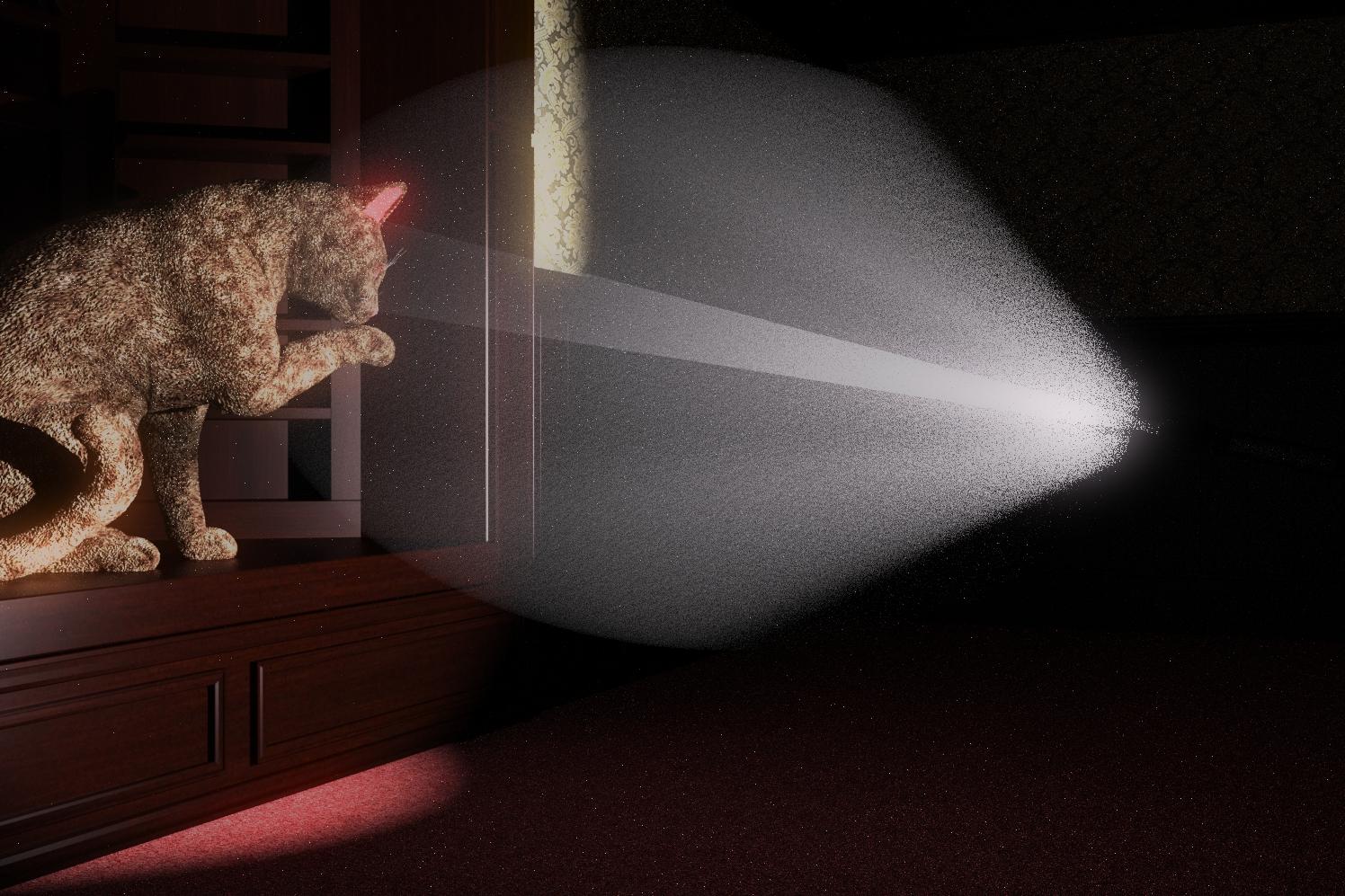

  • FishtalesFishtales Posts: 6,228
    edited June 2023
    I used a Volume sphere stretched into an ellipse and a volume cone with the flashlight and using the glass/bulb as an Emissive light.
    Click on image for full size.
    1496 x 997 - 1M
    Post edited by Fishtales on
  • marblemarble Posts: 7,500
    Yes, that's approaching the effect I'm looking for.
