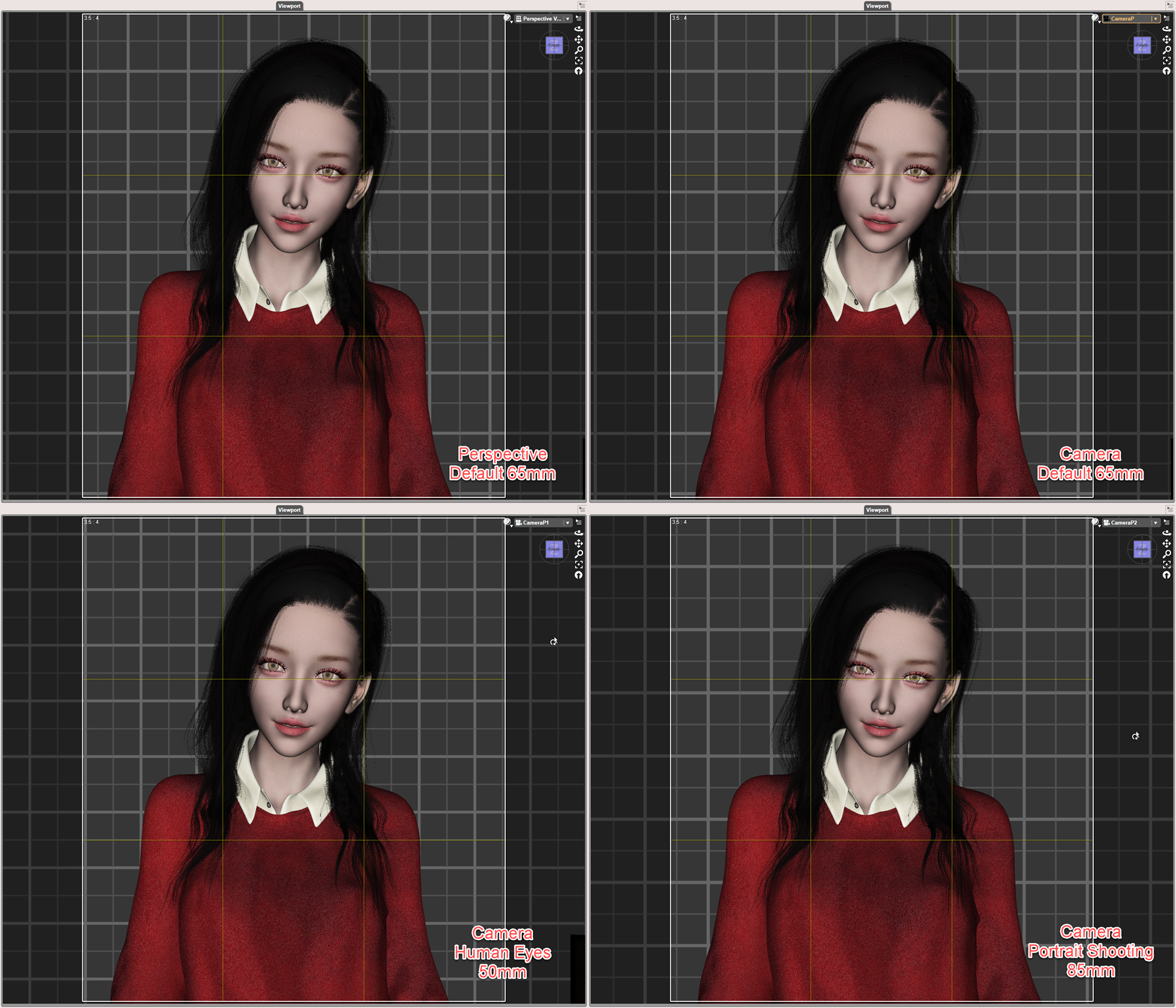

  • crosswindcrosswind Posts: 10,351
    edited June 2023
    Never use Front View to adjust face or body shape as there's no perspectives. Using Perspective View or a Camera will be both fine as their default focal length are the same 65mm, you will get the same rendering result with a default camera afterwards. Normally the focal length of human eyes is 50mm, so setting the value b/t 50mm - 85mm in a Camera will be appropriate for adjusting face shape. Recommend 85mm which is a 'gold focal length', just like we use an 85mm fixed FL lens on DSLR for portrait photograthy...

  • FirstBastionFirstBastion Posts: 8,087
    The camera's lens focal length manages the amount of distortion. Less than 50mm will lead to significant distortion.
  • richardandtracyrichardandtracy Posts: 8,235
    I agree about using a camera with a known focal length. 90-105mm tend to be the range professional photographers use for portraits as it is apparantly 'more flattering' to the subject. 50mm is supposed to be similar to the view a normal eye receives.
    In different situations you may need different camera views. If you are, say, posing a character against a prop, it can be difficult to be certain the character really is touching the prop with the perspective view. In that situation, the orthogonal views can help a lot. But always check afterwards with a perspective view to confirm that it looks right.
