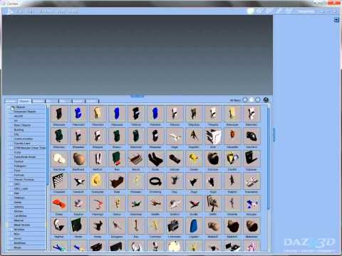

    The trick with Carrara is that these "external" folders are not readily viewable in the Carrara browser. They must be manually added to the browser window using the "add folder" function. Someone here recently turned me on to a great YouTube video:
    This is a different way to organize your Carrara browser, but covers some great concepts.
    Finally, keep in mind that the "Base" content that comes with Carrara may require some special installation tricks to work right. (That used to be the case - don't know if DIM fixed it). Basically, the "presets" must be installed inside the Carrara "package" program to be viewable in the broswer. The installer (last time I ran it) installed it in a separate folder and the user had to move the files inside the package. If you use the method described in the above video, you will not have to worry about this because everything is installed outside the program folder.
