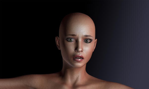

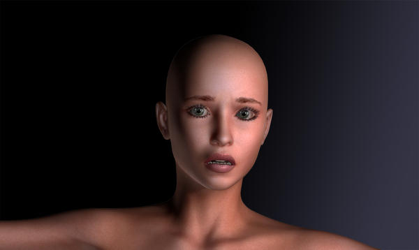

    Also when using SSS, it seems to wash out a lot of diffuse color. In the examples below, notice that the subtle light blue eyeshadow is lost in the SSS (EzSkin2) render.
    Here is a comparison.... Hair removed for speedy renders....
    Here are is a V4 Realism Kit render and then an EZSkin2 render of the same charater skin. .. No post work except Phototshop Auto Contrast applied to both renders.... You can see the V4 Realism kit has a more imperfect surface and the diffuse colors hold up better. To each his own and some would say one or the other looks better. I am trying to get the look of the V4 Realism kit, not that it is better, just what I am after at the moment.
    1080 x 645 - 116K
    1080 x 645 - 117K
    Post edited by dlm4001 on

  • dlm4001dlm4001 Posts: 205
    Thanks for the Rendering Checklist it was a[[reciated. All of these tips were applied in the renders posted. Both of these images were rendered in Poser Pro 2012 SR3 to remove differences in Renderfly. The V4 Realism Kit was ap[plied to the skin in Poser Pro2010, saved as a material and then the material used in Poser Pro 2012.
    I have been using Poser since Poser 2 and I have a pretty good handle on the Renderfly. The point was to look at the differences I was getting as a reason for wanting to get the V4 Realism Kit reworked. EzSkin is a great took, but I was getting the results I was after with V4Realism Kit. If you spend the time setting it up correctly, then the results are impressive, and allow some great crisp images for Postwork. (same advice youi gave for Renderfly ;)
    The point on preference was beautiful skin and perfect skin are not necessarily the same thing.
    The render settings met or exceeded those you listed. (Ray trace Bounce 2, IDL Quality 60 Min Shading 0.1, Irradiance Caching 60, Pixel Sample 12, Smooth Polys on) Also, Shadows, on, and Use Displacement.... I should have set the texture filter to Crisp for each material, but they were set to quality for both sets of materials (so the comparison was equal.
    SSS was enabled on both
    Three lights were used for the example. Key, fill and back. Yes I should have used a light emitting object, but the point was to keep it simple for the comparison. .
    I did use Advance Render Settings. This is probably my favorite tool in the pipeline. I ususally render several passes using this tool. IT does a great job of rendering mats and maps.
    As I take time to experirment more with EZSkin2, I am sure I will get closer to what I was getting with V4 Realism Kit (old methods) r, but I will have to write a script to add spots (or do it manually for every material, and I will have to explore the displacement maps to see how V4 Realism Kit was getting those natural; looking surfaces.. (Or maybe EZSkin2 will get an update for large and small spots (hint hint).
