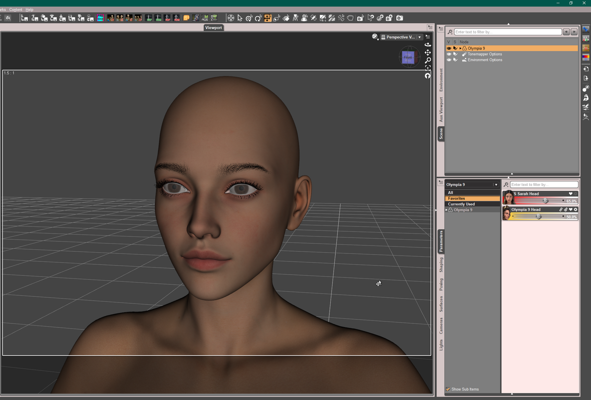

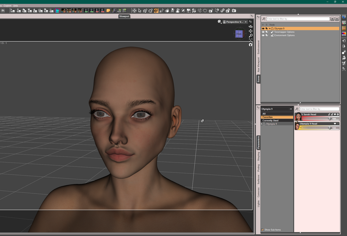

  • crosswindcrosswind Posts: 10,322
    edited June 2023
    Anyone could be experiencing this... Usually we don't dial the full head morph / full body morphs from different characters to 100%, the result will be either distorted or 'weird'. Take your case as the example,  Olympia and Shahina were both made on G9 Base Figure, if you wanna blend their morphs, 50% / 50% (even more) will be doable while 100% / 100% won't. Imagine if you add 100% 'deltas' together from two totally different characters on a G9, what will be the result ? It'll be just like the pic you posted.....
    I don't have Shahina but the below case is the similar. Blend head morphs of Olympia and JS Sarah:
    100/100
    65/50
    Post edited by crosswind on
