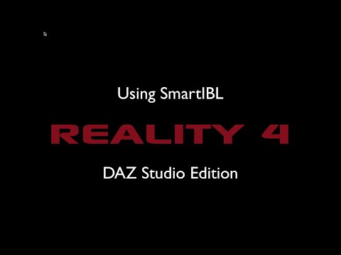

    When you get acquainted with how Lights work, you should also try SmartIBL lights, mostly for outdoor scenes:
