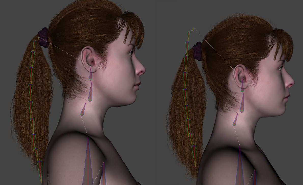

I have a hair with rigged parts. When I load the "size morph" for my character the hair rig falls apart.
What can I do to tell DAZ to scale the skeleton along? With "bone visibility" I can see that the skeleton is the problem.
How can I fix this?

  • Ah I see what you mean. Let me try again. I think my problem is a bit different, but related. As you can see on the first screenshots of my initial post the hair does scale with the character size, but the skeleton does not. So when I pose the tail, by rotating tail0 for example, it does not fit anymore. As you can see on the other two images above.
