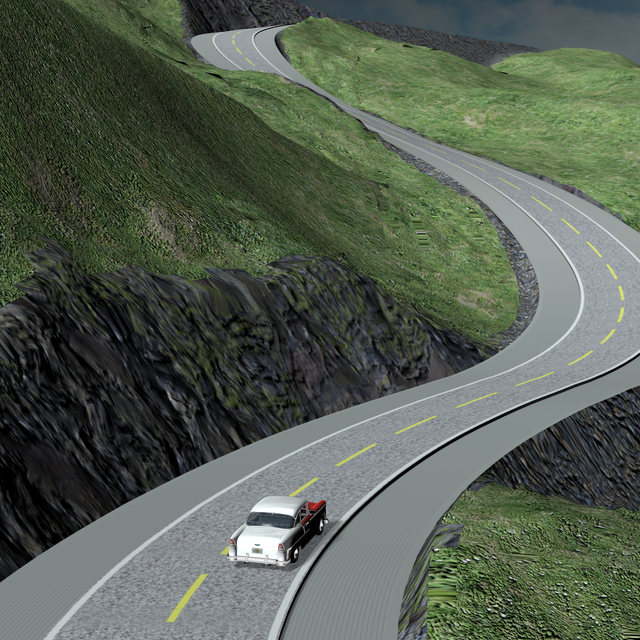

Some years back I wrote a small program to add roads to terrain maps. At the time, Bryce was my main 3D program, so most of the testing was done using Bryce. Although it worked, I was never happy with the quality of the road textures because of pixelation. The cut and fill areas also shared the same texture as the main terrain, which is OK in some circumstances but not others. This image shows the quality problem.

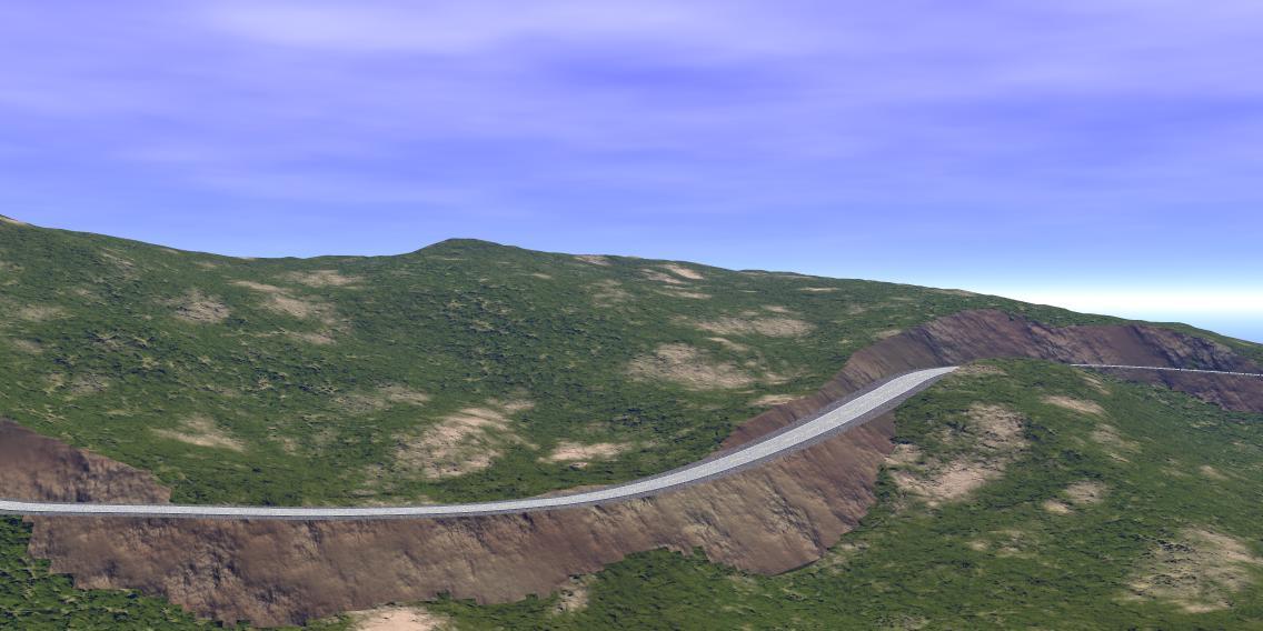

Over the past few months I started to work on an updated version that uses the terrain map to create a road, but outputs all as an .obj mesh. By doing that, I can use UV mapping for the road texture and create separate material zones for the roadbed, curbs, shoulder, cut, fill and main terrain to allow a greater variety of textures and better quality.  Becuase it is a mesh, it also allows steeper roads to be made without the staircasing you get with a terrain map. This image shows the progress.

  • OMG I would not drive a car on those roads.
    i think what you do is pretty cool but given real world road gradients and physics some of those climbs would be impossible.

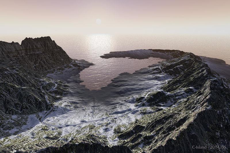

    RGcincy - extremely interesting work you're doing. Adding roads to a terrain is very tricky. If it is part of the terrain, you get the problem with the material. If you create them separate, you have the material issue mostly out of the way but run into problems how the road follows the terrain contour.
    Below, the first one I made by drawing the road into the TE and fiddle with the material. The second is based on a terrain made in an external program where I could draw the road as a vector and define how the  road follows the terrain and when it cuts into it. The process is mostly hit and miss and you're back at the material problem. So I'm watching this space.
    Road 1
    Road 2

  • Your roads cut into the terrain as most do Horo, forming an embankment.
    i think any automated process is going to have its limitations,
    I am a Carrara user as you know but we both use the same greyscale height map system for our terrains so a common topic, I have looked at BJcincy's program.
  • HoroHoro Posts: 11,811
    JaguarElla - I fully agree. Real roads are on the surface, cut into the surface, are bridged over chasms, disappear in tunnels. Roads are a real challenge.

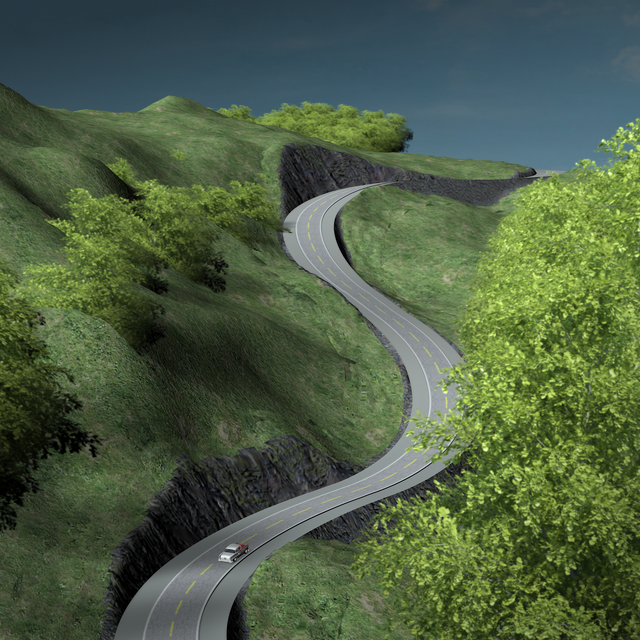

    Here's a flatter road. Much more cut and fill gets added. It took 22 seconds to load the terrain map, add a road with 6 dots, then generate the mesh. Takes about 5 minutes to import the mesh into Bryce and add the textures.

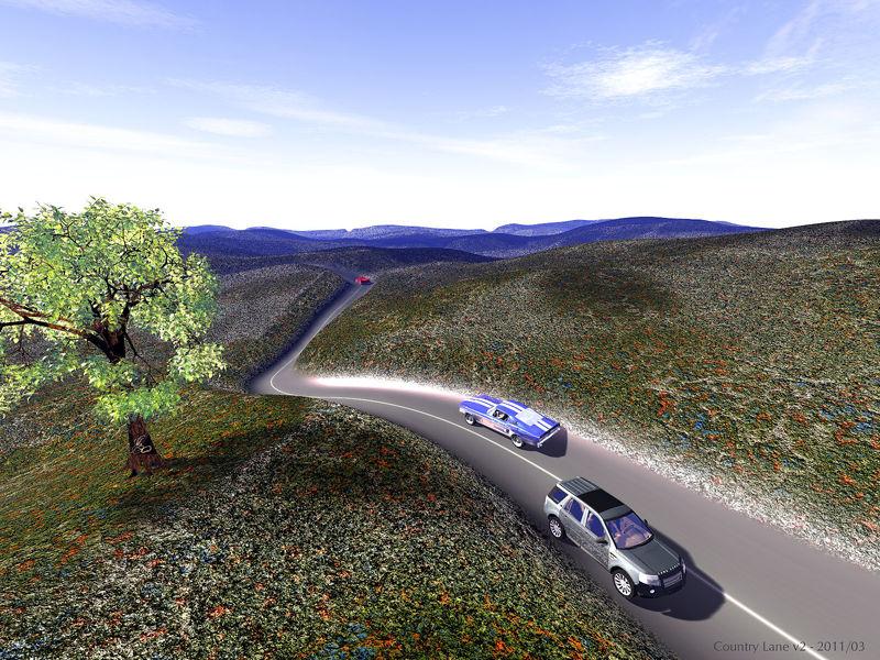

    After a 3 year hiatus, I decided to take a fresh look at my road generating program. The biggest problem I faced before was getting the road terrain to smoothly mesh with the underlying terrain. After testing a bunch of mathematical approaches this week, I made substantial progress. There are still some areas with gaps but they are far fewer than before. I also corrected a UV mismatch between the two which made for misaligned textures. These test scenes were done in Daz Studio, but since it's an .obj mesh, it imports fine into Bryce as I've shown in prior postings. There's still several roadbed issues to be tracked down and resolved but my biggest stumbling block was the terrain matchup.
