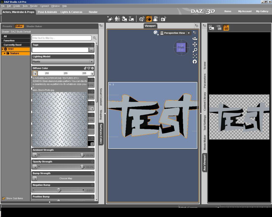

Dearest, I ordered FTMC and it works awesome....only , after loading the .obj into Daz I cannot apply any shaders to it nor change its surface with f.e. texture images....
Why not? What goes wrong? What needs to get done to get it to work? It is supposed to work with Daz 4.8..........So Daz claims.....

    Like I mentioned before , FTMC works just fine....only DAZ 4.8 wont let me apply shaders nor texture files to the imported .obj . I'll send a mail to [email protected]. I shall try to attach the file again somewhat later , but it just shows my TEST.obj generated by FTMC in Daz .

    I don't have the software, but I think the obj has to have a UV map in order to apply a tecxture image to it. Is it UV mapped?

    I believe the font objects won't take a texture because they don't have a UV map.   To see if an object has an UV map, change the view port to UV View, select an object in the Scene pane, go to the Surfaces tab and select a material.  If the object has a UV map, you'll see it displayed in the UV View viewport.

    Nope , there is no UV map..... Logic question ; how can we change this? Some shaders actually do work ...but too many do not :(  ( can this be the effect of the missing UV map?) If the tiling shader and all shaders would work then FTMC is an awesome application.....but now it is very dissapointing for me...   :(

    UVMapper Classic is free if you wanted to try and create a UV Map. I have no idea how to do that though, but there is a tutorial link at the linked page.  I use UVMapper to create texture templates for UV mapped .obj files.

    I use Hexagon for making the UV maps. But if you just want to apply a shader/color, it should work fine with the obj "as is".

    That's why I said, a shader/color. For anything tilable, you'd need to UV-map it.
    You could also consider Carrara, which has a built-in text primitive. While there's no direct "bridge" to DS, you can export to obj and import to DS (just remember to select "Carrara" from the obj import options), and Carrara can directly open your DUF scene files (mostly. It doesn't handle instances, Genesis 3 or HD morphs), which means you can create and edit the text "in situ". Everything is automatically UV mapped, and there are separate shading domains for front, back and sides of the characters. Carrara has its own UV editor if you need to change it.

    I tried UVmapper Classic but it gets me nowhere , I follow UVMapper's  tut on their site but I don't see or get not even near the results I am supposed to get /see . UVMapper Classic starts with the mention the .obj created by FTMEC has no UVMap and if I want to create 'one'. After clicking 'yes'   it is like walking blindfolded into a landmine for me......nothing happens/is to see what the tut explains when following the steps.
    Someone from forgedbyflash contacted me and it seems he is trying to work  out what needs to be done to be able to get tilemapping/shading done with an FTMEC-created 3d object.
    Suggesting other pograms that supposedly can create UVMaps for those FTMEC-obj's is very nice but for now I am not in the position to buy any of them.

    Mr.O'Brien's answer:
    Hello Peter,
        I am sorry .  I have not been able to find a suitable solution.  Some materials work and some don't.  I wrote FMEC 10 years ago.  I don't have any intention of updating it.  I contacted Daz3D.  I assumed they contacted you.  Again, I do apologize.  The program wad designed to work with Poser.
    Andre
