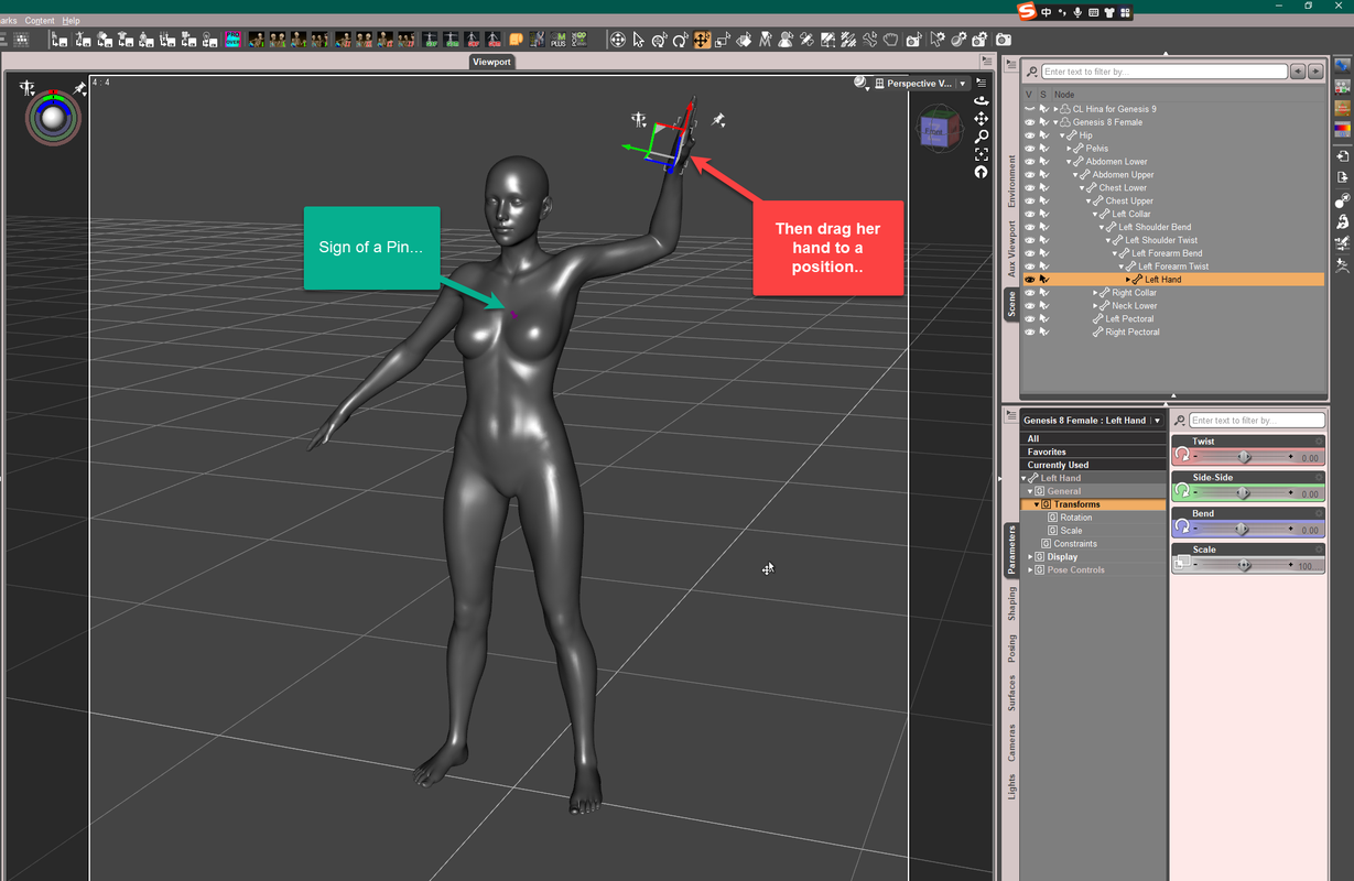

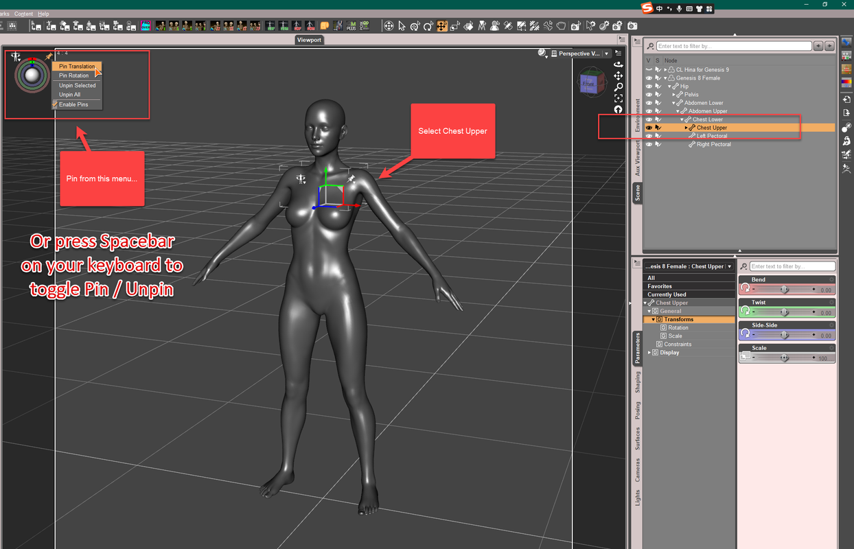

    You may use a pin on the upper bone, for instance, select figure's Chest Upper node, press Spacebar and then drag the hand... If you use ActivePose Tool (Alt Shift + P), it'll be the same opration...

    Like this:

    Don't forget that in that particular case there are morphs on the chest, mainly the breast, triggerd by the raised arm - those are not directly the result of the chest bone moving, they are linked, so pinning the chest won't stop movement.
  • crosswindcrosswind Posts: 10,249
    Yes~ it depends.. So sometimes I pin the collars or avoid 'dragging' while just dialing..
