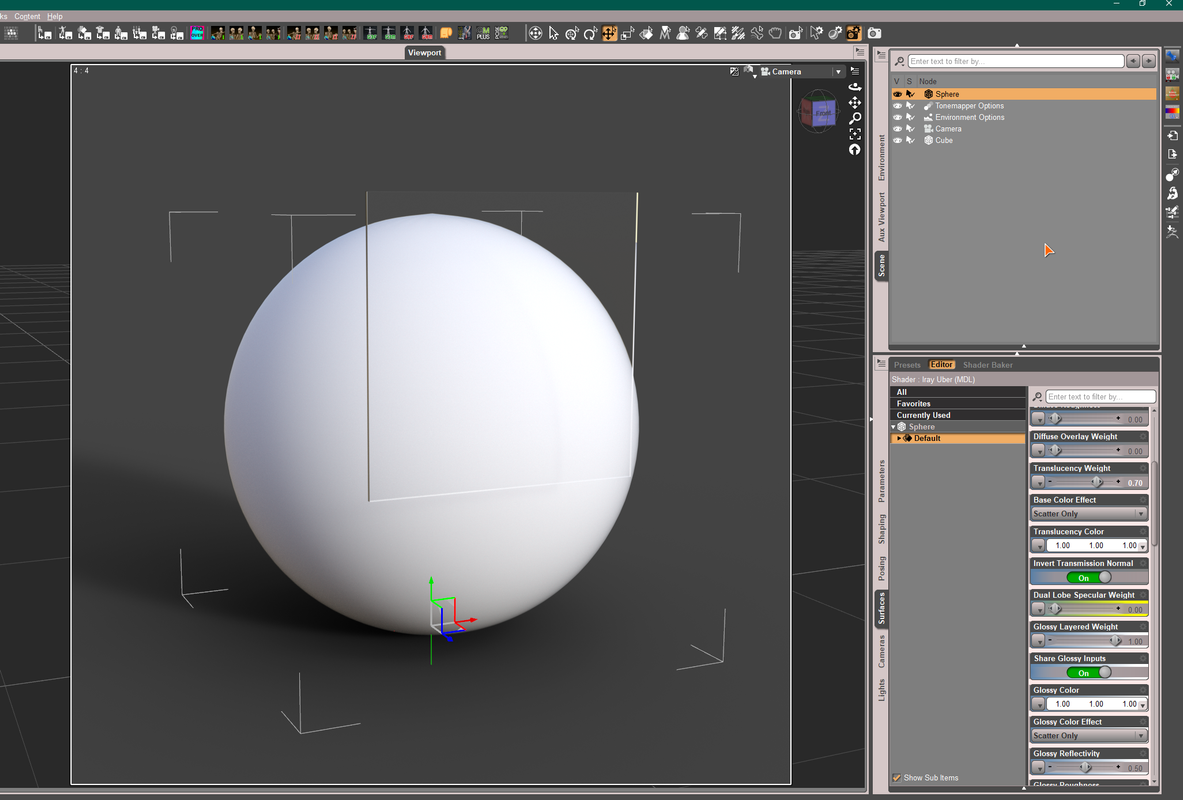

Just in the last couple days, Iray surfaces with SSS have started to show very odd chomatic artefacts when viewed through any sort of transparency- either Cutout opacity or refraction. As you can see in the portrait image, the cutout opacity on the hair cap is showing up as a reddish area, and there seems to be somethign a bit odd about the area behind the lenses.
I created a sphere with the same shader settings as the figure, but no maps and just white diffuse and glossy colors, and a translucenty of .70. I then added a flattened cube with a refaction weight of 1.0, and there is a strange amplification of the SSS color on the more distant outer rim of the sphere, while a cyan color is showing up cose to the refractive surface.
Then I intersected the sphere with a plane primative with 0 cutout opacity, I get a cyan cast under the otherwise invisible plane.
I've tried just about everything I know how to do- changing HDR lights, parametric lights, max path length, render mode, etc.- but can't figure this out. Did nVidia drop a new driver or something? I'm stumped.

    Hum, probably it's a driver's issue ~ I'm using Studio Driver and found there was no problem with the above shader preset... As for ghost light, have you tried this? https://www.daz3d.com/forums/discussion/609556/creating-a-ghost-light-daz-studio-4-21-1-26#latest
  • Got it figured out, and as usual was just something simple. I did a full render instead of just going by the viewport draw, and everything worked normally. I checked the Draw Settings tab and somehow it had got switched to Interactive instead of Photoreal. Changed to Photoreal and all my issues went away.
    Thanks for the help folks!
