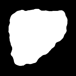

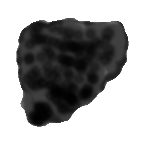

the scale of the image and the scale of the mask do not match.... the mask ends up larger than the image.
i'm actually trying to come up with smoke (not a tree) because i need to have some smoke *behind* an object and thus cannot do it with post work....
i have attached the following images:
the image
the mask
the image layered over the mask
the way it appears in DS.
in DS, the mask appears to be larger than the image, as is trying to line up at the top. I've tried adjusting the offset, but that only moves both images.
as you can see by my attachment, when layered over the mask, the original image may have some "fringing" but certainly is a closer match than what i'm getting with DS.
any idea on how to fix this???
TIA.
Load your mask into your 2D program select all of the mask area and Grow it a few pixel's. That will clip just a bit off the edge of your smoke but not much.
