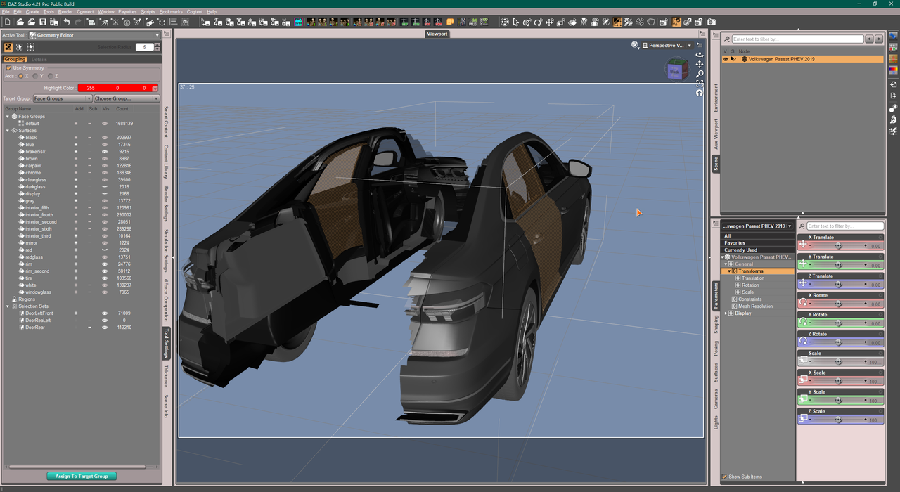

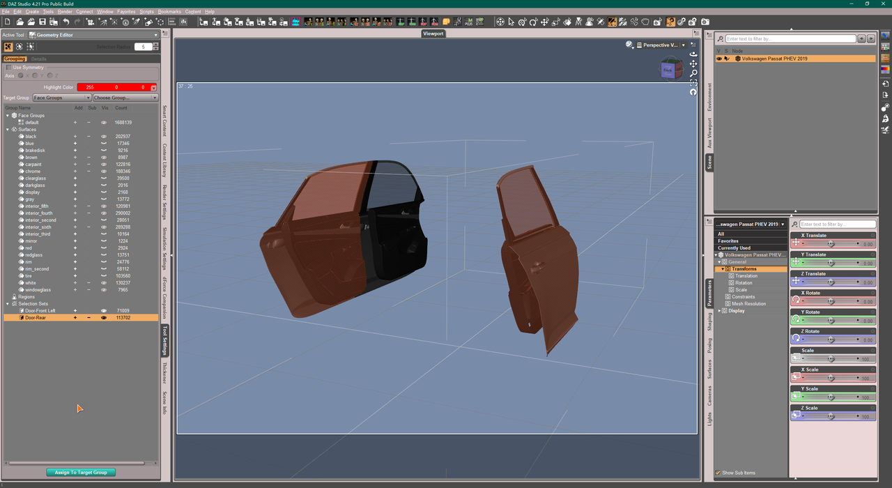

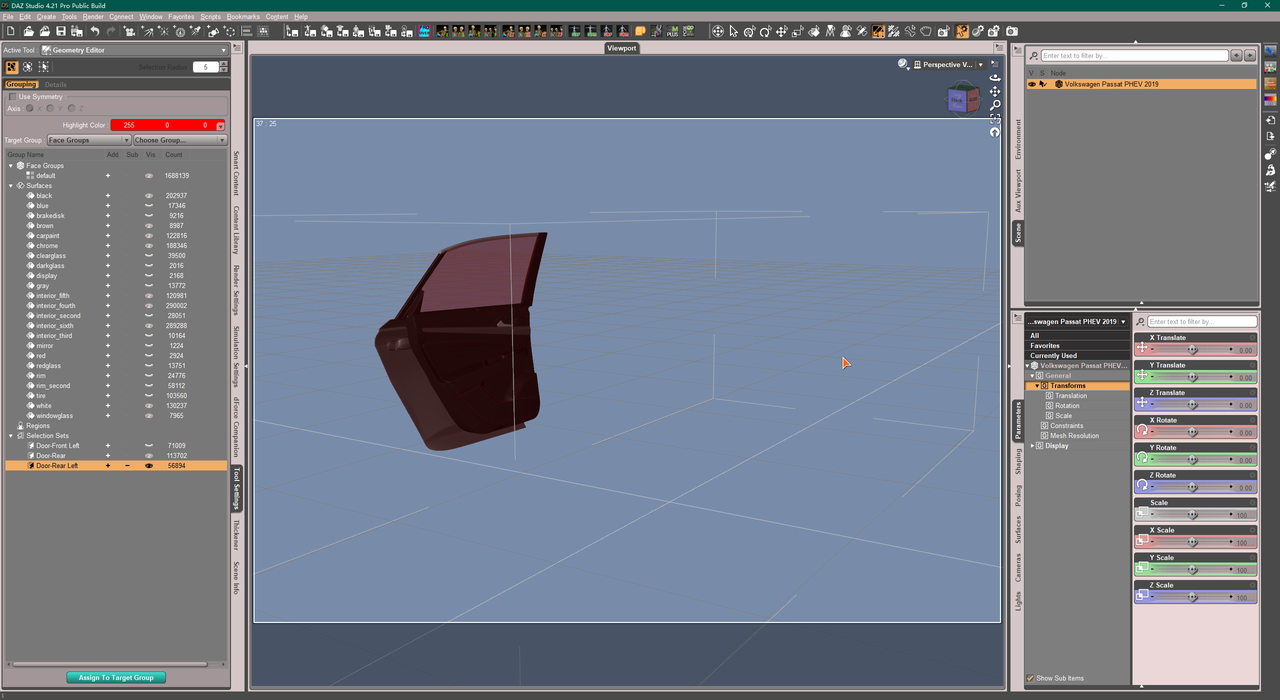

     Actually all these separation could be done in Ds as long as you can well manipulate GeoEditor. I used a VW to roughly separate doors, like these:
    1. Marquee select 'the geometry in the middle', hide them. Turn on Symmetry. Select one-side door (outer and inner) in Drag mode by flexibly pressing Ctrl ++ / Ctrl +- (Grow/Shrink)
    2. Create a Selection Set of 'Rear Doors', assign selection to it. (Invert selection for geometry fixing as needed)
    3. Creart a Selection Set of 'Rear Left'. Turn off Symmetry, Alt + Marquee to deselect right door and assign Seletion to 'Rear Left'.
    Repeat these steps on 'Front Doors'... For this Passat, it will appr. take 15 - 20 mins at most to separate 4 doors. Create Face Groups from Selection Sets as needed, then go for rigging.
    I'm also a blender user and ever tried such a separation in blender. Finally I found the workflow in Ds was much faster. smiley
