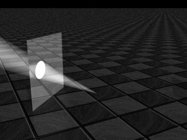

I don't understand why this keeps doing this. I want to bounce a light off a mirror like surface but instead this happens.

    Increase the number of raytrace bounces in the rendering setup. (I don't have a copy of Carrara at work, so I am misnaming things)

  • GFHELGFHEL Posts: 24
    Hi Grimreaper
    - In the Light Cone settings, set 3D Shadows to Enable. That cuts off the light beam through the mirror.
    - In the mirror shader, turn down the color. Try Lightness (L) at 2% and Saturation (S) at 50%. That reduces the weird bright spot.
    - In the render room, turn on caustics to get the real light bounce effect. Set the filter size to around 50% to smoothen the light dots generated by the render engine. Turn up the intensity if the effect is too weak.

  • MalusMalus Posts: 370
    edited August 2012
    I got it to work but I want it to bounce off of 2 mirrors I can't seem to make that work.I'm going to continue to try.
    Post edited by Malus on
    The light cone doesn't bounce.
    Oh really well that sucks thanks. If I use a light on a mirror like object will the light bounce off like a normal light (Not a cone just an ordinary light).
