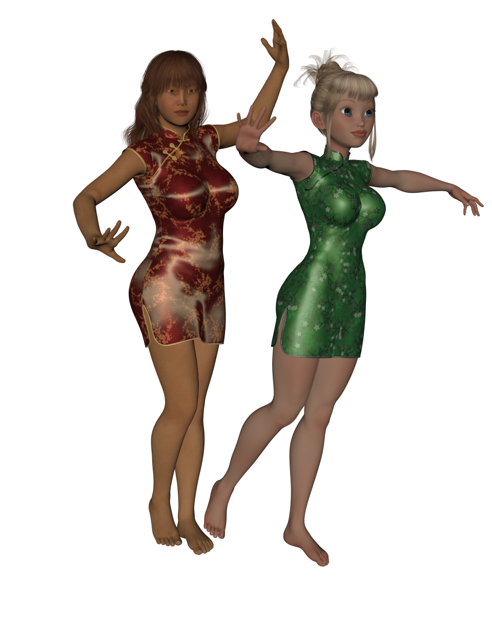

  • Let me grab a G2F real quicklike, and I'll show you.
  • DarkSpartanDarkSpartan Posts: 1,096
    edited September 2015
    Now, this isn't a huge thing, obviously, but it does show the issues. Hands and feet come out perfectly, but you'll have to do the gross posing of limbs and torso to suit. It cpmes from the bones not being named the same way between the two models (never mind an extra bone in the areas affected).
    Image:
    Left: Rumiko G3F, XiaoMei Cheongsam, Paisley Hair, and Sweet Caster for G3F pose 27.
    Right: Callie 6, XiaoMei Cheongsam, Llibrarian Pinup Updo, and Sweet Caster for G3F pose 27.
    If you want to get creative with a text editor, you could convert the poses in question by renaming the bones in the G3F poses to whatever it is that G2F uses for the same locations. You'll miss the Upper Chest and Upper Neck locations, but that's usually fairly minor.
    I can't see a reason a script couldn't be written to do it automagically.
