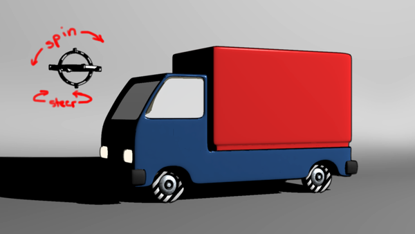

    I'm trying to figure out how to use 1 controller object (a cylinder) to control all the wheels on a truck, so I can rotate the cylinder and make all the wheels rotate at the same time & speed. (I know this can be done with the spin modifier, but I'm trying to learn how to use ERC).
    The Wheels are grouped something like
    truck>body>back wheels>far back>left
    truck>body>back wheels>far back>right
    truck>body>back wheels>near back>left
    truck>body>back wheels>near back>right
    truck>body>frontwheels>left
    truck>body>frontwheels>right
    I've read through the different tutorials but am still running into problems setting this up.
    I've set the motion to angles instead of quaternion and constraints are at none or full.
    I've also tried using an ERC chain creating Group instead of chain and just adding individual ERC modifiers but can't get this to work.

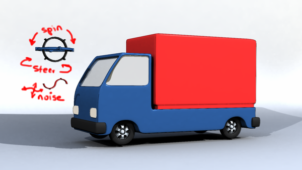

  • fabafaba Posts: 53
    Hello Mosk,
    I can't tell you what's wrong with your scene without having a look at it.
    but I have created an ERC example scene for you which has
    a control for the spin of the wheel and another control for the steer.
    As as side note, when transforming the controllers the controlled objects will show the effect after releasing the mouse.
    http://www.sharecg.com/v/64911/view/5/3D-Model/Carrara-ERC-controlled-wheels
    https://vimeo.com/50468605
    800 x 450 - 78K
  • Mosk the ScribeMosk the Scribe Posts: 908
    edited September 2012
    Faba - thanks so much for making that. I think this will help me (and hopefully others) get a better handle on ERC.
    Below are some specific places where I'm running into trouble.
    1) I noticed you had an ERC Modifier on the Chassis and that its Controller was called Wheel_Noise_Chassis, and that it used Basic Options, with Transformations checked off on the Z axis. Assumedly this is for moving the chassis up and down and making things look like a bumpy ride. I added a cube to the scene and named it Wheel_Noise_Chassis, and parented that cube to the truck as you'd done with Wheel_Roll and Wheel_Steer.
    Moving the Wheel_Noise_Chassis up and down on the z axis indeed produced the bumpy ride as expected - so far so good.
    Now for the problems:
    On the ERC, I checked off the X box as well under transformations and tried moving my controller on both the x and z axis - but no side to side (X axis) movement shows up on the chassis.
    Similarly, I checked off Rotation All (instead of None) and tried rotating my Wheel_Noise_Chassis - but I don't get any rotational movement on the cassis.
    Since I wasn't sure if you could make this change after the fact, I created a new controller, a primitive cone named Wheel_Noise_Rotate and added a second ERC Modifier to the Chassis - Using Basic Options, None for Transformation, All for Rotation, Use FRA Checked and selected my Wheel_Noise_Chassis which was parented to the Truck like your Wheel_Roll and Wheel_Steer controllers.
    I still don't get any rotational movement showing up on the chassis when I rotate the controller.
    If you could explain what I'm doing wrong here, I think I'd understand how to work things much better.
    Thanks so much for taking the time to create that file and post the video, and any explanation as to where I'm messing up would be appreciated.
    EDIT - just realized I hadn't set the Motion to ANGLES (instead of Quaternion) on my controllers. Fixing this lets the truck respond to rotation one one axis. Still haven't figured out why it won't rotate on other axes (and why I can't translate from side to side) - trying to see if any of these things are locked.
    Post edited by Mosk the Scribe on
    1) I noticed you had an ERC Modifier on the Chassis and that its Controller was called Wheel_Noise_Chassis, and that it used Basic Options, with Transformations checked off on the Z axis. Assumedly this is for moving the chassis up and down and making things look like a bumpy ride. I added a cube to the scene and named it Wheel_Noise_Chassis, and parented that cube to the truck as you’d done with Wheel_Roll and Wheel_Steer.
    I had some experiments with additional noise movement for chassis, front and rear axle, but thought it was too confusing for a simple example, so I removed the controllers, but forgot to remove the modifier*blush*
    Similarly, I checked off Rotation All (instead of None) and tried rotating my Wheel_Noise_Chassis - but I don’t get any rotational movement on the cassis.
    Since I wasn’t sure if you could make this change after the fact, I created a new controller, a primitive cone named Wheel_Noise_Rotate and added a second ERC Modifier to the Chassis - Using Basic Options, None for Transformation, All for Rotation, Use FRA Checked and selected my Wheel_Noise_Chassis which was parented to the Truck like your Wheel_Roll and Wheel_Steer controllers.
    I still don’t get any rotational movement showing up on the chassis when I rotate the controller.
    If you could explain what I’m doing wrong here, I think I’d understand how to work things much better.
    Try to check the constraint setting in the Chassis motion tab. I locked most of the transformation against modification.
    If a channel is locked it won't react to an ERC controller Removing the locks should make it wrok as you expect it.
    Thanks so much for taking the time to create that file and post the video, and any explanation as to where I’m messing up would be appreciated.
    Still working my way through your file (for wheel control) but will save questions on that for another post.
    You are welcome, I am always glad to help out :)

    I'm looking at how you set up your other modifiers now (to steer and spin wheels).
    Was initially confused that you applied some ERC modifiers directly to the Wheel_Model and others to Wheels_Rear as a group - but now see that the group one was another noise modifier, and that each wheel model had the steer and roll ERC modifiers directly applied. (And I now have a good appreciation for how important it is to NAME your ERC modifiers - like ERC_Steer, ERC_Roll - instread of leaving them all ERC.
    Question: Is there way to apply the ERC_Roll and ERC_Steer modifiers all at once via an ERC chain with the Group option selected, or given this type of hierarchy, must they be applied individually to each Wheel_Model one at a time?
    Or if the Wheel_Models are all duplicates of one another, is there a way to go back and apply it to the base Wheel_Model itself and have it show up on all the wheels automatically?
    How do you name your ERCs like Roll, Steer? I tried saving the modifier into my presets with a new name, and it loads properly, but I can't get the new name to show up and don't see any options to assign name elsewhere.
    I remember the ERC documentation tellin use to use EDIT>FENRIC> Add ERC Modifier to add ERC Modifiers as opposed to simply adding them via the top right portion of the interface where regular modifiers are generally added. If I want to save some ERC Modifiers for reuse in other scenes as a preset, would I just add an ERC Modifier in the usual manner (via the EDIT Menu) and then load my ERC Preset over that?
    Thanks
    I did set the ERC spin and steer modifier up at one wheel and just duplicated it together with the modifier. Then I deleted the steer modifier from the back wheels.
    How do you name your ERCs like Roll, Steer? I tried saving the modifier into my presets with a new name, and it loads properly, but I can’t get the new name to show up and don’t see any options to assign name elsewhere.
    In the bottom section of the ERC modifier "Global" there is a button that lets you change the title.
    As far as I know (Fenric might correct me) the ERC in edit and the one in modifiers is the same.
    Just not all object types show the ERC modifier in the available list (I think only geometry does show it) . But that doesn't matter,
    using the edit menu, or a shortcut, or using the preset way, you can load it on any object type.
    Yes, that's a good way to save a modifier preset.
    Actually you can create ANY modifier (even bounce or whatever) and apply the ERC preset on it.
    The old modifier will turn completely into the one, that is saved within the preset.
    Another way to save a modifier presets is to drag and drop it to the content browser> misc>modifiers and also reuse it via drag and drop.
    OK. That makes sense.
    If I'm using a model that's already built, however (like a car or truck with wheels), is there a way to apply the ERC modifier in bulk (using ERC Chain with GROUP selected I would guess), or would it have to be applied manually? If the model isn't locked, I guess a compromise would be to delete all wheels save one, add the necessary modifiers, then duplicate and reposition the wheels.
    Thanks for the thorough answers you gave earlier and for the videos - everything makes much more sense now.
    (And is anyone else having problems with the forums? I have to save all my posts right now, because when I hit Submit the first time, the post just disappears without going through - then have to paste back in, submit again, and usually goes through ???)
    If I’m using a model that’s already built, however (like a car or truck with wheels), is there a way to apply the ERC modifier in bulk (using ERC Chain with GROUP selected I would guess), or would it have to be applied manually? If the model isn’t locked, I guess a compromise would be to delete all wheels save one, add the necessary modifiers, then duplicate and reposition the wheels.
    Assuming this is only for the spin my personal workflow would be this:
    -build a single ERC modifier (no chain) for a right wheel, and drag/ save it to the content browser.
    - drag this modifier back to one of the wheels on the left side, to check if this works in the right direction, or if the wheels are mirrored.
    if the wheel spins into the wrong direction i would change the modifier and save this as left side preset to the content browser.
    - then i would drag and drop my presets to each wheel (right side preset to right side, left side preset to left side)
