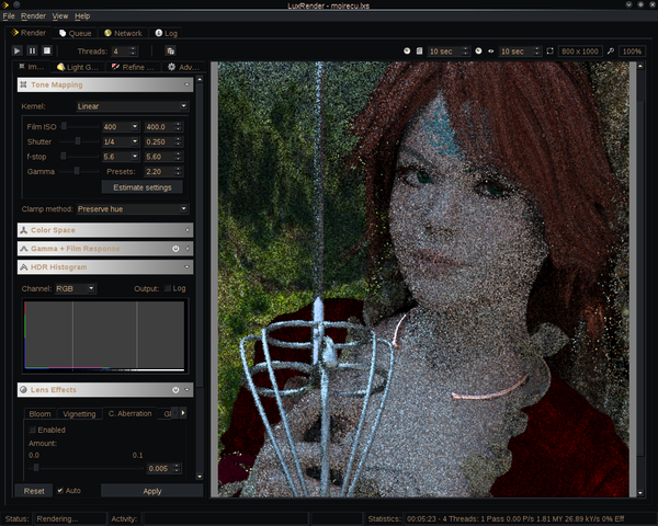

  • DrowElfMorwenDrowElfMorwen Posts: 539
    Ah, I do have Reality, but I've never seen this bloom effect. Do you know how to do it or where it is?
    I'm not sure how to get there from Reality, but in the Luxrender UI, it's under Lens Effects...
    1280 x 1024 - 2M

    Okay, I see now. Thank you very much for your help!! I'm just surprised because the other renders I have seen with the bloom effect don't look like Reality/LUX renders to me... just regular DAZ renders!
