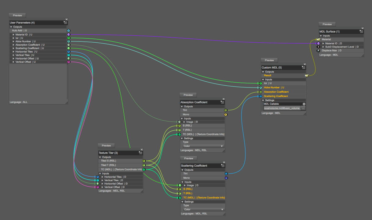

On the crash, I'm guessing at this point, but I wonder if the image needs to go into only one term, either absorption or scattering, but not both? For that matter, what happens if we have different maps for each?
So ... we can copy and paste code to make the MDL, but is there a way you can save the brickset and post it here?

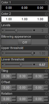

No crash here. Use these values to actually generate visible perlin noise. I did some tests and found that plugin in perlin noise generator to the SSS Amount has no effect.

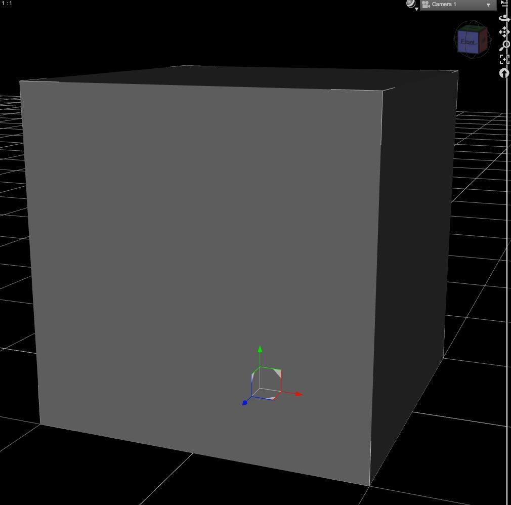

Could you share a basic crashing scene with just a cube in it with the shaders applied and the mdl script use, please.
volume.mdl material
Test MDL.duf scene file
Noise Volume.dbm shader config
Interestingly on reloading (using a cube instead of my usual sphere), it got through a couple dozen iterations before crashing.

I'm guessing the MDL Callable entry is able to take values from the Perlin Noise Texture brick, and use those to pass to the surface, as that brick doesn't otherwise have an output. Have not seen this before, so something new every day! (I am guessing here. The output of the shader doesn't do anything on my system, even when I've placed the MDL in the roper paths, and added its own in the Directory Manager. Will keep at it...)

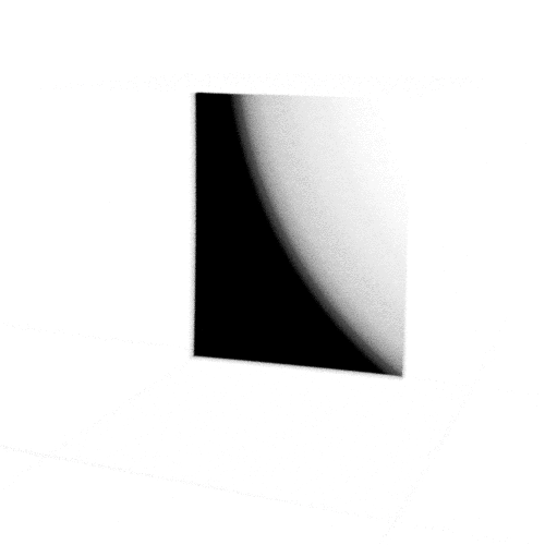

I think I've reached some limit in my brain. Can anybody see what's going wrong here?
I hoped to get a noisy cube, but I got nothing.
Tobor, it sounds like you have the general idea. If you need more specific information, I posted a general tutorial a while back on working with MDL and Shader Mixer. It's here. Everything I've learned about Shader Mixer is from Carnite on Youtube.
If you rise the absorption coefficient to color(0.02) you'll see inside the cube but no noise. I think the scattering_coefficient ignores dynamic texture values I think iray uses the same scattering value for all volume.
On the first glance, I'd say you can't use a texture on the scattering_coefficent. It's the product of a color (as float) divided by a given distance.
scattering_coefficient: noise(noise_levels: noise_levels, size: size).tint
I can make out, that you have defined "noise_levels", "size" and "tint", but cant find "noise" anywhere. Ant the dot "." in front of "tint" doesn't belong there, too., I guess. It could also be, that the scattering coefficient will only work with a monochromatic color.
And I guess it can't make sense of the (noise_levels: noise_levels, size: size) part. They are already uniform, so it's IMO unneccessary to define them again. (noise_levels / size) would make more sense I guess. Any operation like multiplying, dividing, add or subtract.
