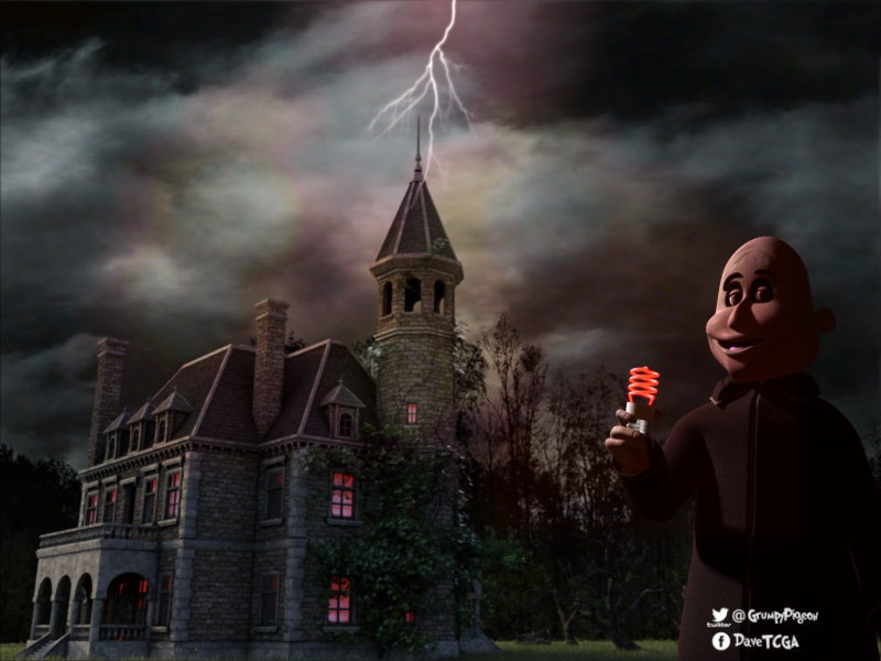

Here is an example of something which did not work for me in the spirit of 'eliminating some options can save time.' I tried to use Carrara's plant modeler by removing all the leaves and using the advanced tree tab tools to manipulate the number and shape of branches. I then used the scale tool to flatten the result and applied a glow shader. While an interesting idea as a concept, the results in the plant editor of the branch tab were too random. At least for me.
That is clever usage, Diomede...
I find a lot of lightning (arcs) to be too random, so I would like to think this method could yield some good results.
