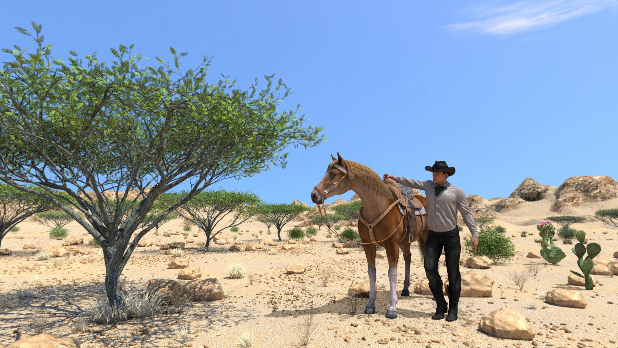

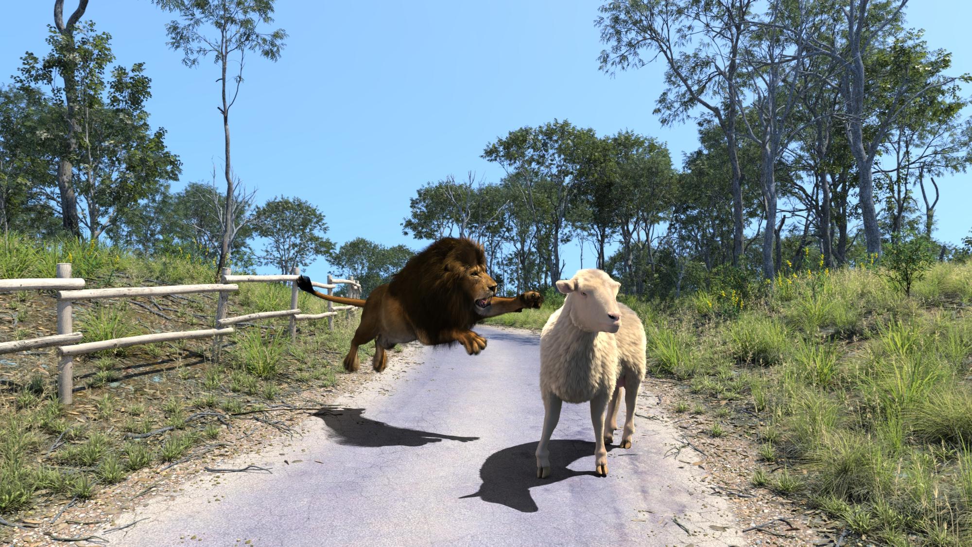

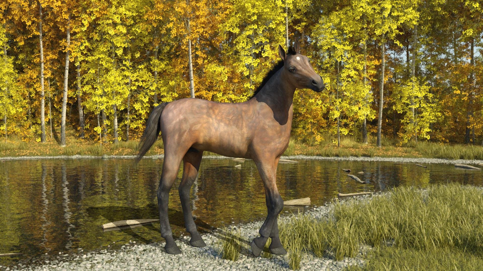

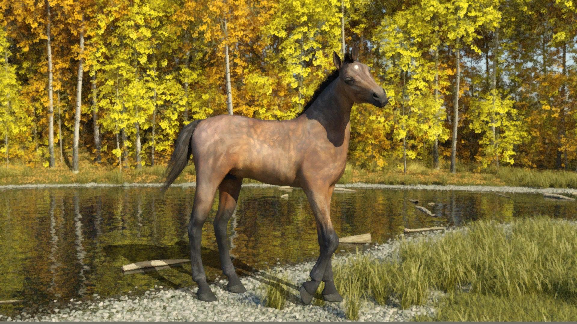

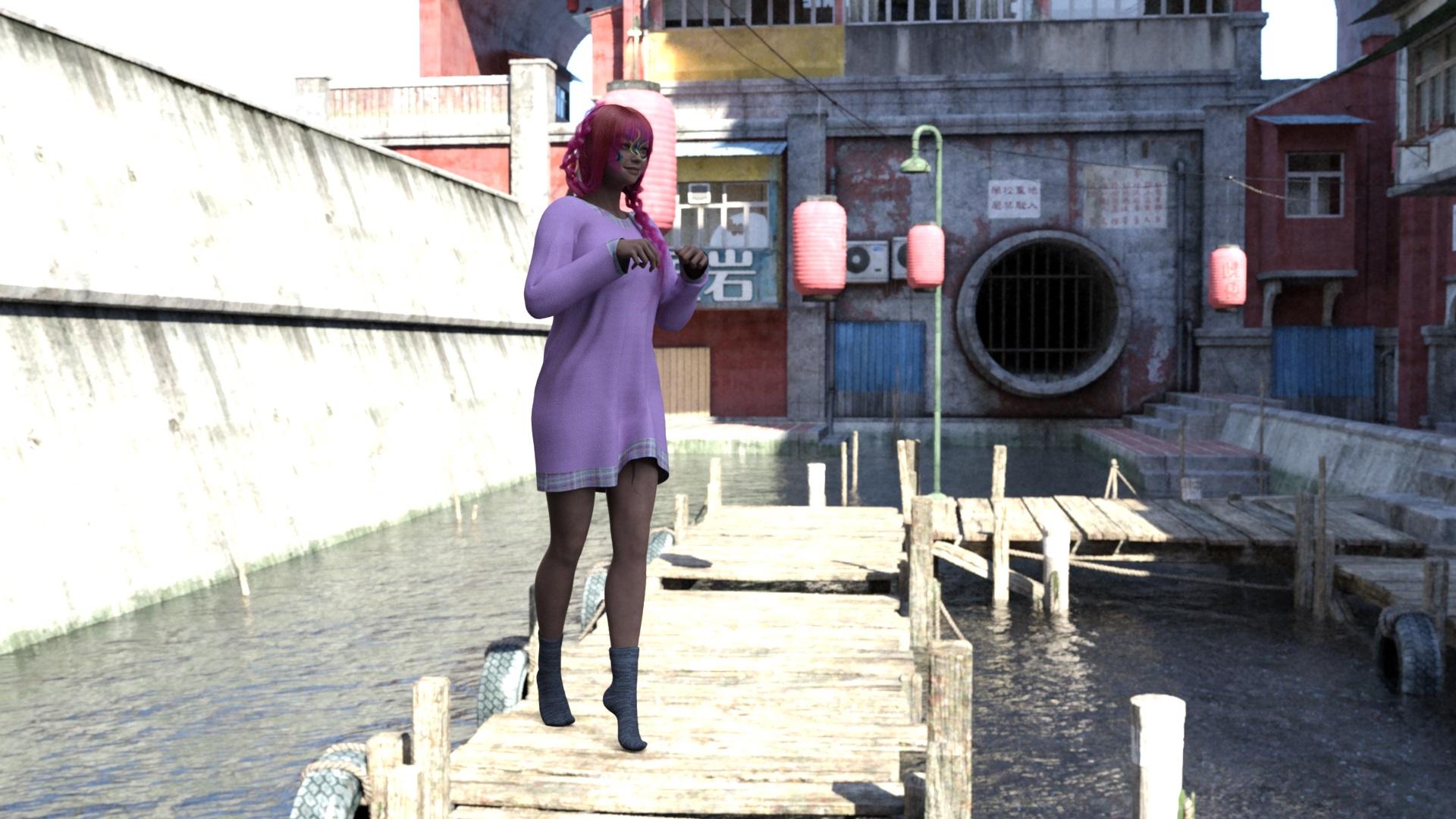

    I made an HDRI from Desert Depression. I made a scene with a horse, a man, a cloud and a couple cactuses and rendered with the HDRI for lighting and background. I added some horseshoe track decals to the ground.

    @Barbult : great image, I love it! And even the horse shoes decals?! You're a pro what else can I say ?!  Thanks (again and again) for sharing your renders here!

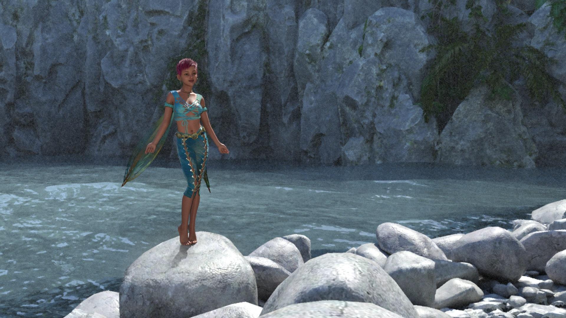

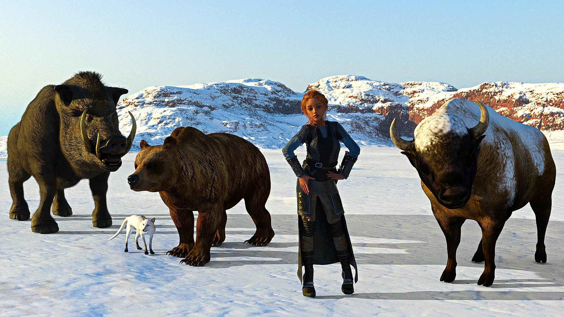

    Why am I getting such terrible results? I've attached an example render using the exr file as the environment map. Everything seems to be working nicely but the exr image is grainy, pixelated and severely lacking detail. Clearly, there's something that I'm not doing or something that I should be doing.
    Wait a minute... Am I using the thumbnail as the environment map? I've just read through some of the posts on this thread. I've gone to the runtimes MyHDR folder and have found the exr file there and then applied it to the render settings environment map and then done a render. But it's the thumbnail that I'm using as the environment map? This is a 90 something meg file, not usually the size one would expect for a thumbnail. Where's the actual image stored? And yes I've downloaded and installed the EXR Creator update using Install Manager.

  • V3DigitimesV3Digitimes Posts: 3,497
    edited April 2023
    @crashworship
    My first impression, but I may be wrong, is that your render resolution might be too small and then, onced "enlarged" by Daz Studio to fit to your camera view and render size, the exr is a bit "blurry". First, make sure that your hdr render is big enough for the size of the "final" image you want to render (when it is loaded as an exr). Indeed, when you load your exr, your camera sees only a "small" part of it, so you have to make sure your exr size is big enough. Increase the resolution to see if it is better (for instance to 10000x5000 or 16000x8000 like Barbult does). A similar pixelated issue was already discussed in this thread, at the top of this page https://www.daz3d.com/forums/discussion/625406/v3d-hdr-master-bundle-commercial/p6 . In brief try to increase the resolution by increasing the size (the pixels you can enter in the second tab use at least 10000 x 5000 minimum instead of 4000x2000 - edit you can normally raise to 16000 x 8000 without too much trouble).
    Several other factors can impact your render quality, such as the light used, the shaders used (especially if you are using an old - non Iray - 3D environment).
    Even if it is probably the size of the render which is an issue, and in case this is something else, in order to have more samples in your render, you can also increase the "Min Samples" in your Render Settings Tab, Progressive Rendering Group. This min samples can be raised to 100 (limit), but if you click on the little "gear" on the top right of the dial, you can remove the limits to increase them.
    But what I would try first is to increase the size of the exr. Then when the render is done, of course you can place the exr manually as your environment map (choose the big exr file, I don't know what you mean by thumbnail), or you can use a preset that you create with the third tab (no need to re-render, the script remembers what you rendered, just look in the list). This preset can be launched from the content folder you saved it in (if it's a content folder), or it can be drag and dropped in your viewport (I think the doc explains how to make a folder become a new content folder). Edit : if you prefer to load it manually, in the third tab, you can select your file in the list, and click on the "open folder containing selected file". At least you'll be sure to be in the right folder. Then you must choose the exr file. But as I said, first increase the render resolution in the second tab, 4k for a 1920x1080 render settings is clearly not enough (it depends on how "large" the area you will render is too -its focal length/frame width).

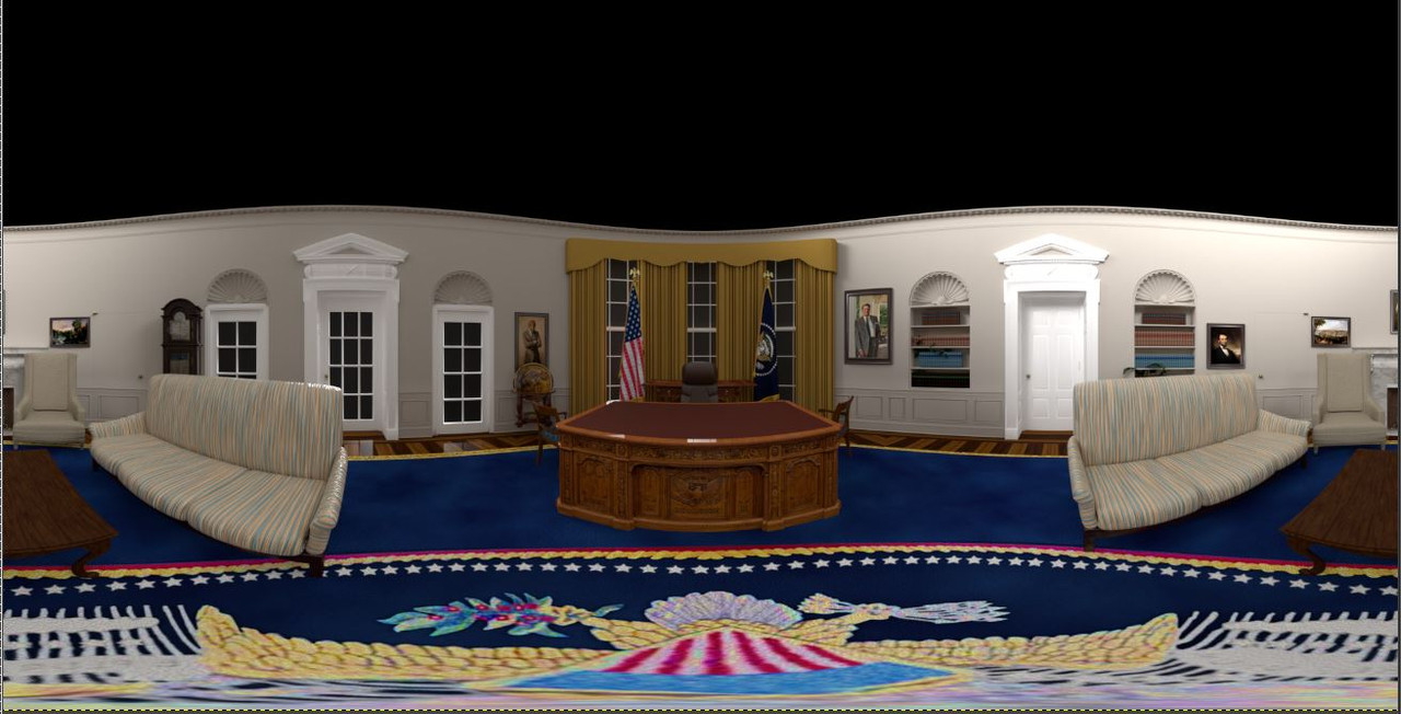

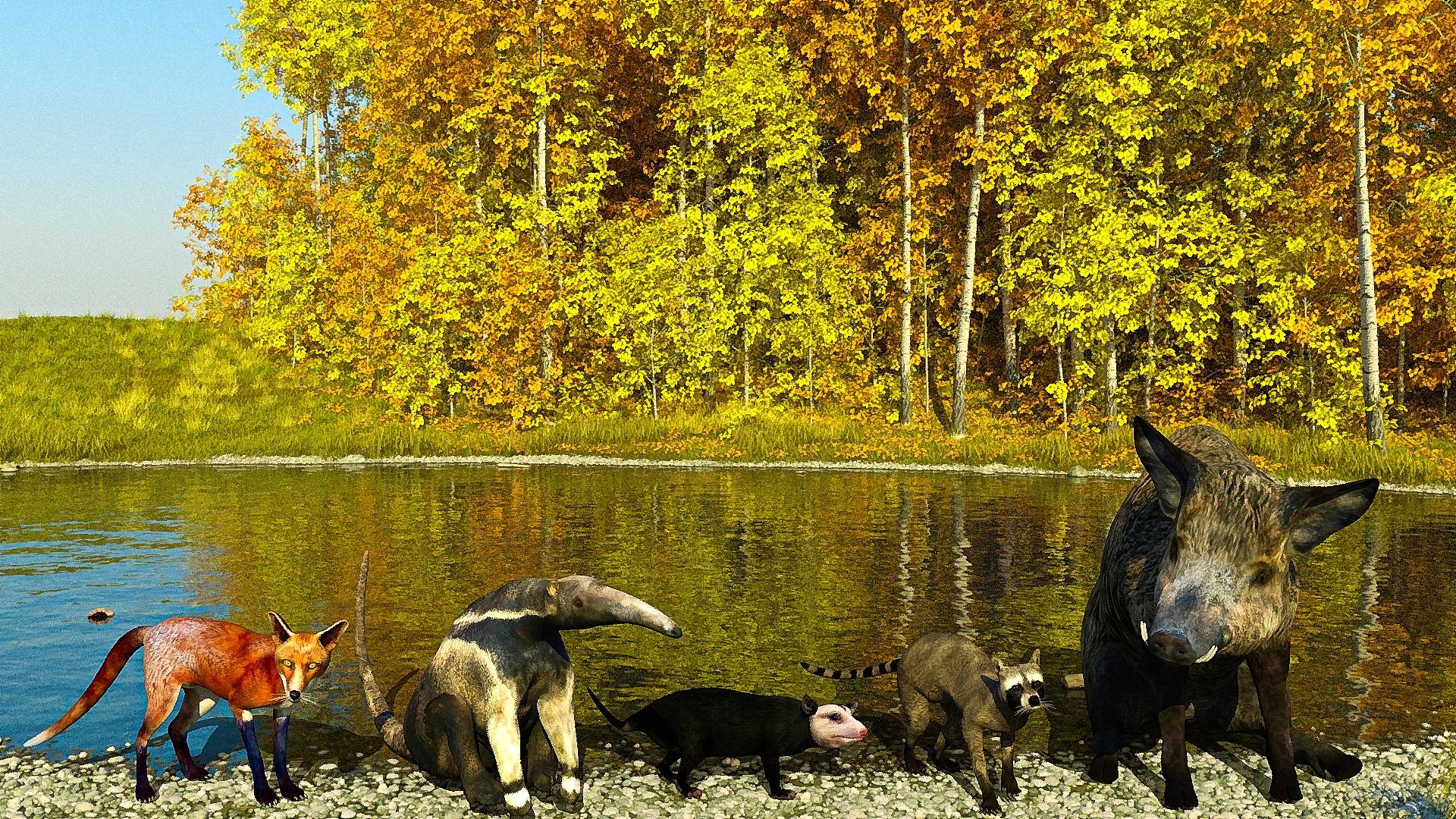

    Alright, I've completed another test exr environment map. This time using Andrey Pestryakov's Tropical Lagoon which is a very high quality and detailed environment prop. This original EXR Creator render was 12k and from the images attached to this post, it's clear that the noisy pixelization is gone but the fuzzy, lack of detail remains and is no different than those first attempts at 4k with the other, various environment props I was using. The colors and saturation are fine but for some reason beyond my comprehension, there's very poor detail. I've successfully created HDRI maps in Studio using a much more cumbersome process with a spherical camera and, while time consuming, I get detailed, sharp maps which I can use as a background for renders. And, for the record, even though I use a Mac with an AMD card, all of my scenes render fine and I can overcome the Nvidia Iray incompatibility in Photoshop without much effort.
    Regarding my use of a Mac, I'm an image professional. When it comes to 3D, I'm very much a dilettante and this is a hobby. It would make absolutely no sense for me to switch a Windows machine just to use for Studio. And, I detest Windows with a passion and for what I do professionally, the Mac OS and hardware are far superior.
    I'm left with one conclusion; The EXR Creator may work very will with Windows machines. It doesn't, for some reason, work with my iMac with the AMD card. And, for the record, this is not an entry level iMac. At the time I purchased it, it was the top of the line iMac available.
    To 3D Digitimes; I use a number of your products. I often rely on them and they are very useful, well designed and executed and help me greatly creating the realism that I aspire to. But for some reason, the EXR Creator will not work with my iMac no matter what I do. I wish it would. I purchased it because I wanted to simplify and streamline making HDRI background image maps. But, for whatever reason, it can't help me do that. I realize that the vast number of Studio users use Windows machines and you probably created your EXR plugin on a Windows machine. It may not make much economic sense for you to create a version which works well on Macs and their AMD cards. I get that and I'm used to it the Daz 3D marketplace. I appreciate your efforts and what you do, but this product won't work with my configuration.

    I don't know, maybe there is something specific in your mac and your configuration. For the process used, it is probably roughly the same process as the "cumbersome" you already did (since there are not 100 ways to make it), but totally automated. If you set "50000" in the luminance correction factor, you probably have exactly the cumbersome process you mention (then either you post exposure in photoshop, or you set a 0.0001 environment intensity). I'm not sure that it comes from Mac, since it is basically only a Daz Studio render, and I had sent my product to a Mac friend of mine (a PA), I just asked him and he told me he had no issue. So I'm really sorry I don't know what in your hardware or software configuration makes this so problematic. I won't be able to help more as I don't have a Mac to try and replicate your issue. Have fun with your next renders!
    Post edited by V3Digitimes on

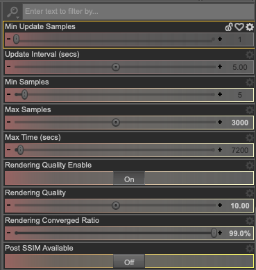

    Hi, I'm running on macOS, and what I've seen so far is that the render is baked way to short time when rendering on a machine without an nVidia GPU,  i.e. the render target numbers for time is set for GPU, not CPU rendering. Just did a 4kx2k and it was "done" at about 50 iterations, but would have needed about 900 more iterations to rid it of the most of the grain.
    I'm gonna do a second test soon when the one I'm running now is done.
    OK, I did a second test rendering from my mac using BoostForDAZ Iray Server.
    Booth as 8K x 4k
    This is the exr rendered with CPU in macOS 12.6
    This is the exr rendered with GPU on macOS 12.6
    Both then rendered in  Studio using CPU (as render a HDRI is pressy simple

    Hi, I guess you set the end time params for the exr renderer from script, and 60-ish iterations are enough when you have the denosier, but that is not an option with CPU.
    So, I think you could try to either
    (a) discover if there are GPUs available and if not, set longer times
    (b) Have a GPU available checkbox

    @crashworship after taking the time to render a larger HDR size, why would you reduce it to 4K and throw away all the extra detail? Why would you have to convert it to 32 bit? The exr output from the V3D HDR Creator is already 32 bit. Rendering a Beauty Canvas with the V3D Env Camera will also give you a 32 bit exr file. If you are just manually rendering a single spherical PNG, JPG,  or TIFF with the V3D Env Camera and converting to 32 bit in Photoshop, that is not going to give good results. If you are rendering manually with the V3D Env Camera, you need to render a Beauty Canvas and use that. There are plenty of tutorials online about rendering canvases in Daz Studio, in case that is new to you.
    In your Tropical Lagoon example, it looks like you are again zooming in way too far for the resolution of the HDR you created.
