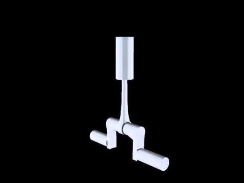

  • Aaaahhh....got it !!
    DOH !!! I needed one more beer to figure it out smiley
    http://youtu.be/ZfLv7JXdndo

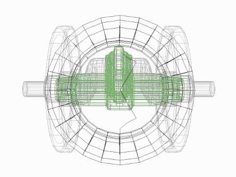

  • I was doing some work with steam engine also a few years ago in InfiniD.   I recall that  I had to child to parent one end of the shaft and then key frame the other end.
    https://youtu.be/lz27zCBpeBg

  • Timbo,
    I am not very familar with Youtube..It played for me so I assumed it was ok for others. I have been on Youtube but so far unable to to find the panel to correct the problem. Will try again tomorrow.  In the meantime this is a frame from the video.  Actually I recall that it was not too tough keyframing the end of the shaft to stay in contact with the end fitting of the beam.  You only have to do one cycle - then copy and paste the keyframes. However Phil seeems to have a more elegant solution, I would think that would be the way to go.
